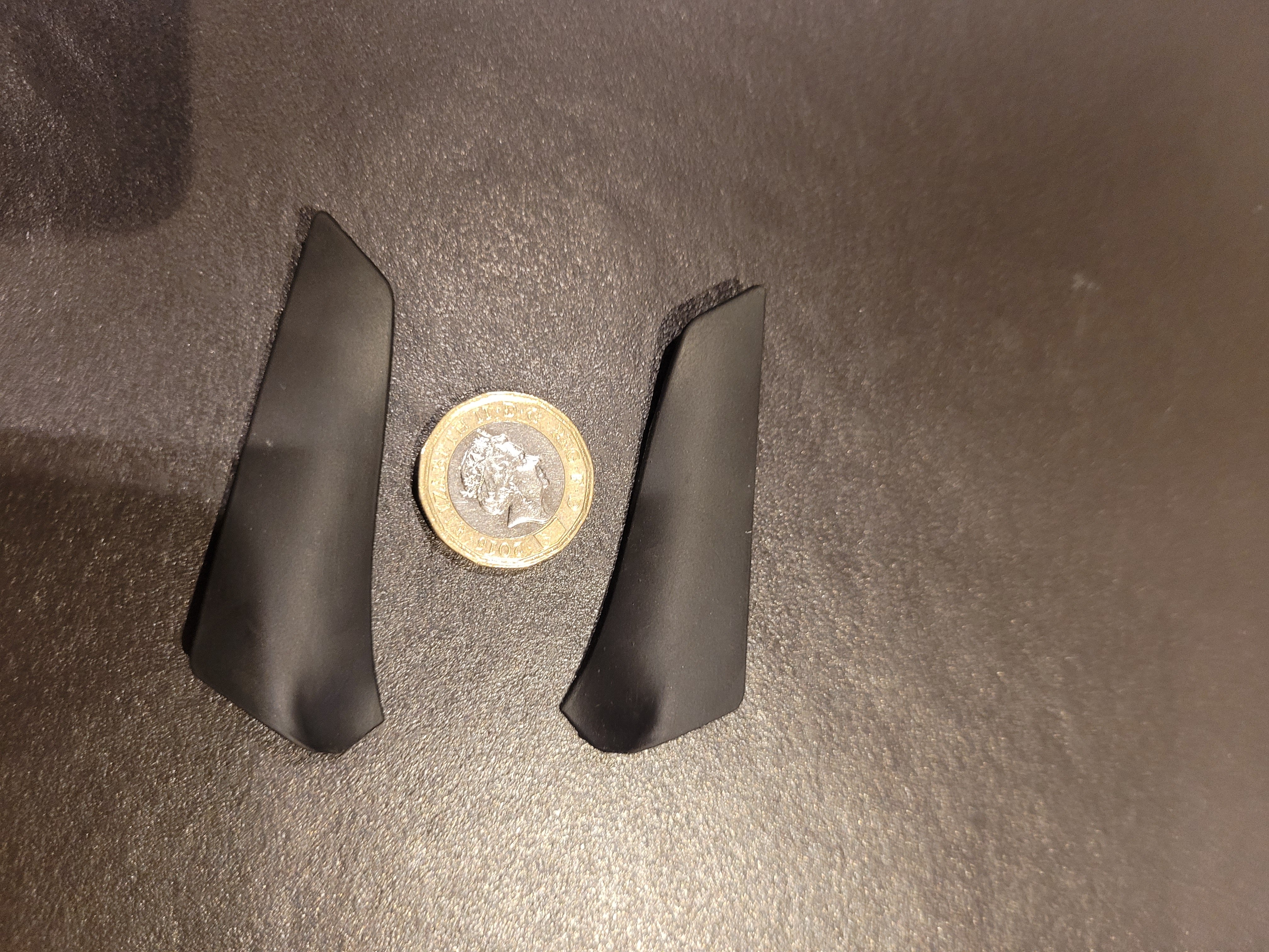

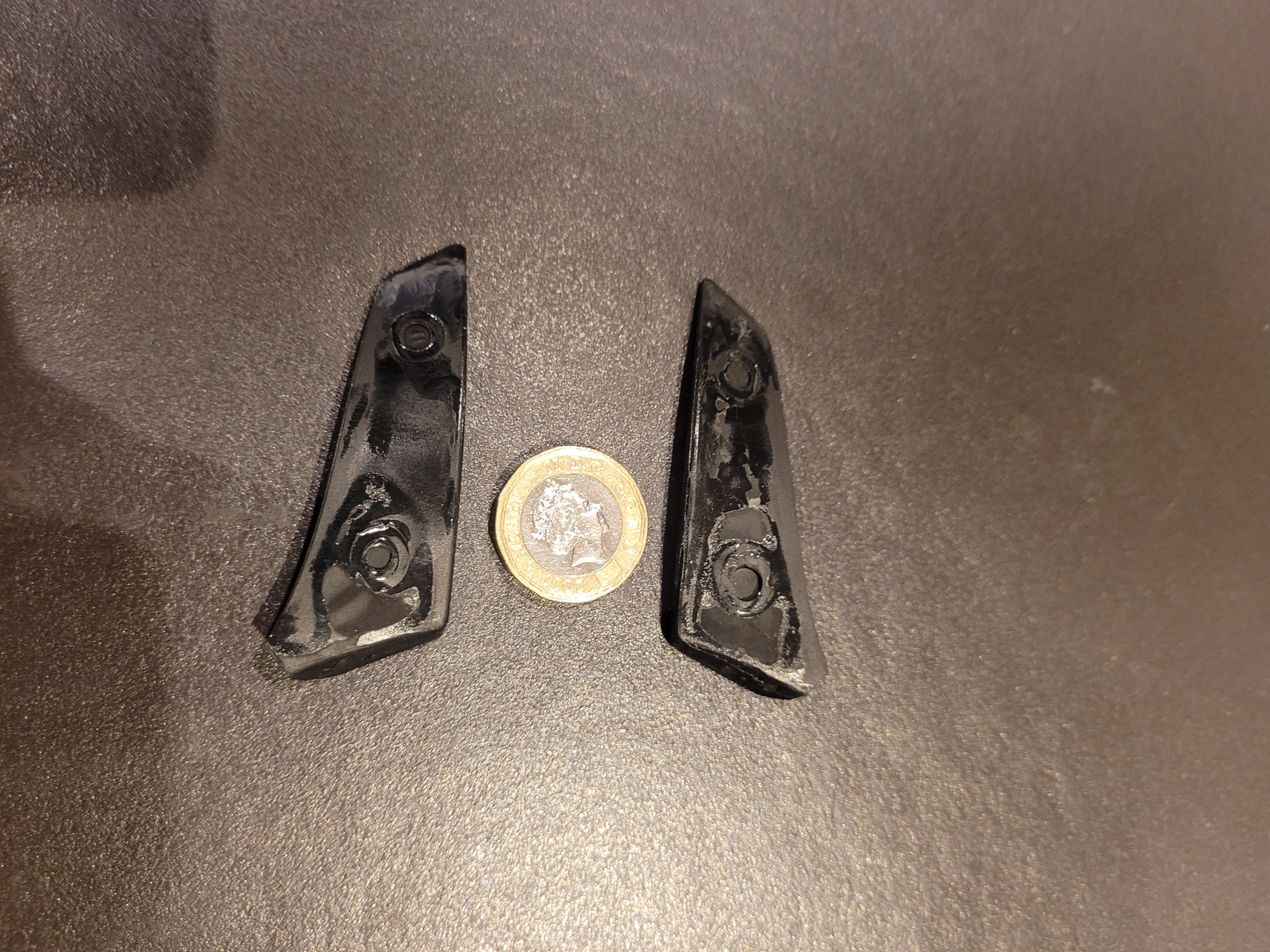

  1. Varooom, they were on the floor in the back which fits with what Urrell has just replied. Thanks people, I will stick them back on with contact adhesive. I knew someone in the hive mind would know where they came from.
  2. Both of these small black rubber triangles have fallen off of somewhere on my Yeti and I have no idea where they came from?! The back sides have glue on them so they were stuck to some surface but as to where I cannot see? Would anyone be able to identify where they should be stuck back on? I've added a £1 coin in t picture to illustrate size. TIA.

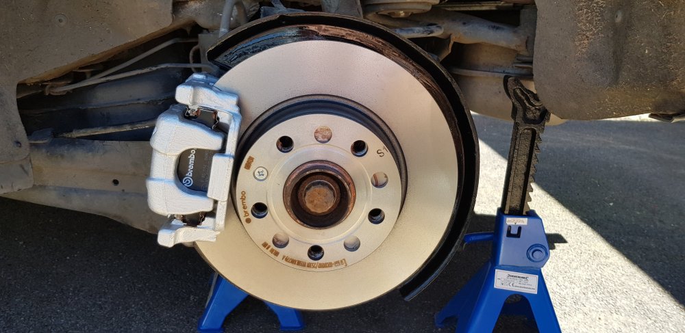

  6. I did mine with Brembo pads and discs but like others, I couldn't get the splined carrier bolts out. They are tightened with a ridiculous torque. I had to give in and take it to my local garage where the mechanic had to remove the whole hub in order to get enough purchase with a large breaker bar with it in a vice. There was no chance I would have managed it on the driveway. I used a drill mounted wire brush and caliper cleaner, then finished in silver hammerite and the wheels look so much tidier.
