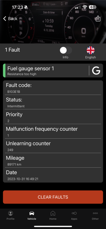

  1. So bit of a peculiar one… I checked the resistance of the fuel sender which was fine. Next I removed the sill covers and checked for visual damage to the wiring - all fine. I took out the instrument cluster to check continuity on the wires from the sender to the cluster - which was all good. After admitting defeat and putting everything back together, I turned on the ignition and the fuel gauge decided to work! I must have disrupted something somewhere which has kicked it back into life - fingers crossed it stays that way.

  3. Hi all, 2019 Octavia vRS TDI… Has anyone had an issue with the fuel gauge not working on their Mk3 Octavia? I filled up with to the brim with fuel the other day and the gauge didn’t move, since then it gradually went down to 0 miles of range and totally empty on the gauge. I’ve plugged in my OBDEleven which brings up code B103E1B - fuel gauge sensor 1 - resistance too high. I’ve taken the sender out of the tank to check that the float was fine and all parts were freely moving, which they were. I’ve also run a test on the instrument cluster to check that the fuel gauge was working - it moves fine. Any assistance would be greatly appreciated!
