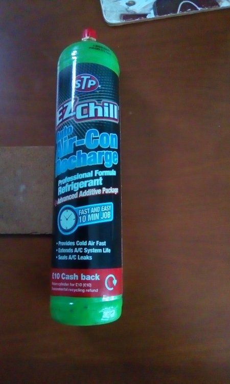

The bottle cost £59 with £10 back on return of bottle. Says it can top up 3 cars ! Herein probably is my mistake, probably have been better to get car gassed up at garage and saved bottle for what it was designed for - top ups.

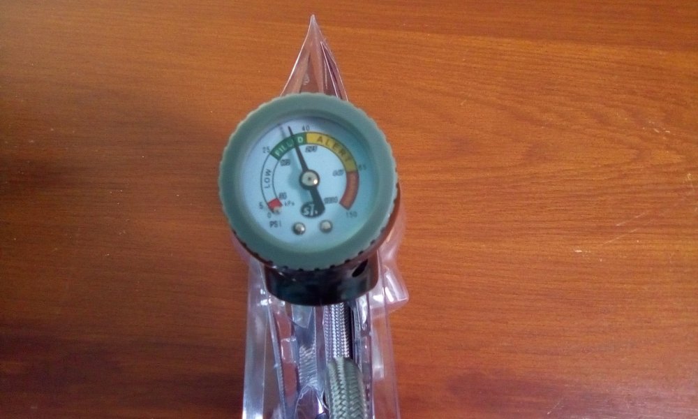

Ok, bit of detective work and trying to marry it up with your advice. Back of can says weight is 510g /18 oz. Air con label on car says 500g with a +-15g allowance. So taking all that in presumably if my system is very low as per climatronic fault code, 2 squirts of the trigger is not going to do it, regardless of what the guage says . More like looking at the complete bottle minimum.

Thanks JR . Annoyingly I'd planned to weigh the can before starting , but totally forgot. Back of the can does state it's R134 gas, it's not one of the cheaper eBay cans. Your stated pressure of 70 - 80 psi is according to the guage I've got is in the danger zone. But then as you say , how accurate is the guage? If the climatronic fault code is still showing low pressure fault code maybe I should ignore guage and carry on filling. Current temp here is around 18 degrees.

Thanks Rumo. Yes , while refilling had air con on on low, with recycle button on. In the photo of the guage, that's what it indicates attached to low port with engine off. Just this minute been out and attached guage again, needle in the green , charged zone. ( With engine off). Presume if I had serious leak guage would be in red empty section. And refill bottle still has plenty of gas, weird.
