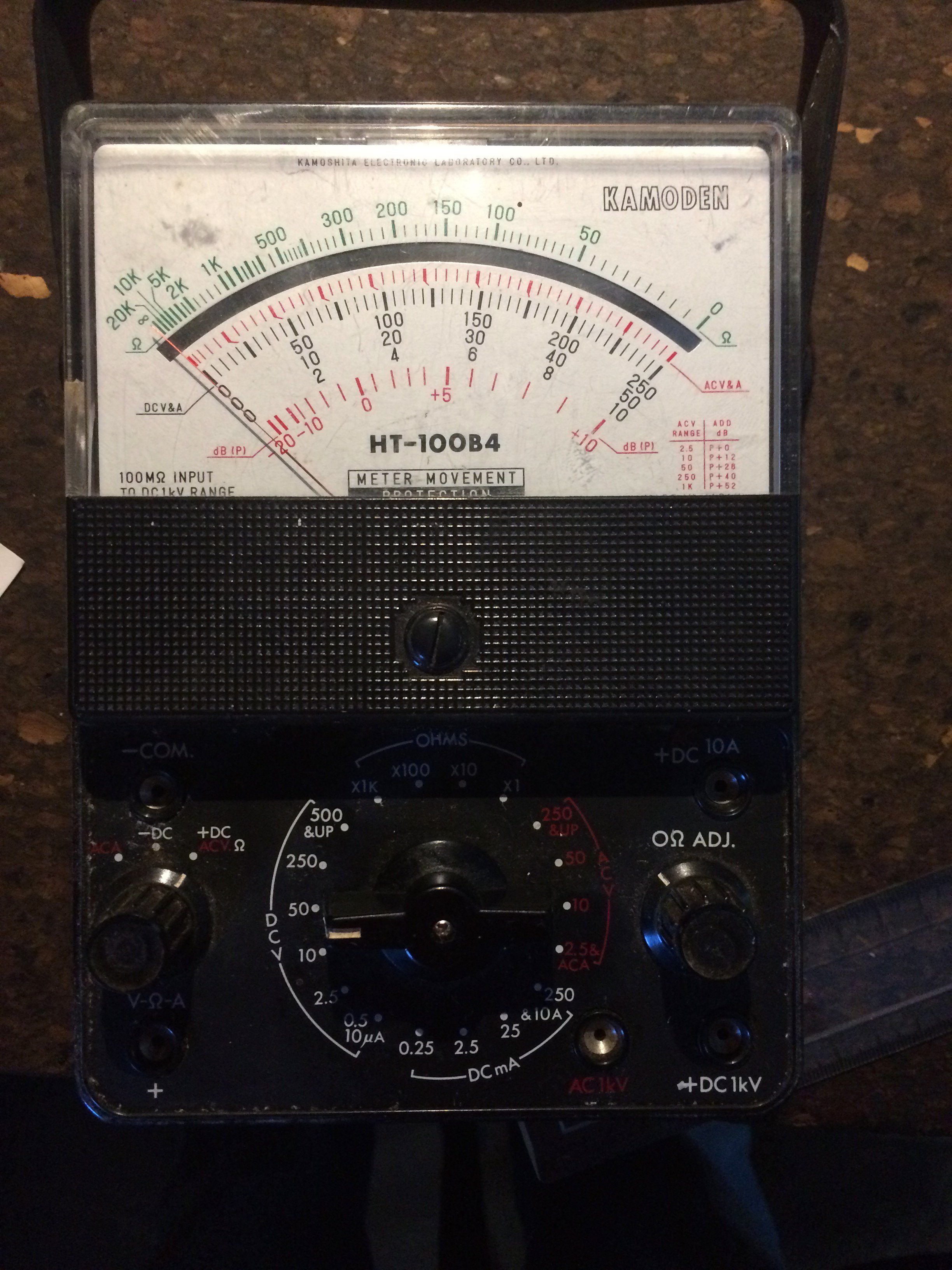

  8. It's an old multimeter, but laboratory accuracy. I would normally buy an Exide or Bosch battery, but in the end bought from Halfords (5yr guarantee). They will fit it on Monday and recode at the same time. Then I'll get the alternator checked. Even if the alternator has a fault it might well have damaged a 5yr old battery. For piece of mind I need to have confidence that the problem has gone away.
  9. Well it seems I have been trying to solve the problem on my Mk3 Octavia with Mk1 logic! You've all been telling me that the electronics are so mind-boggling that normal rules no longer apply so I went back to basics in spite of the symptoms. I measured the voltage of the battery at below 10v and decided to replace the battery (5yrs old). After all with extra complication must come extra battery stress. Stop-Start battery available on Monday. There is still a possibility that I have a faulty alternator, but having taken two long journeys over the last 10days I still think the dash would have shown this up. Anyway one change at a time complies with the rules of problem identification, albeit a bit costly if wrong.
