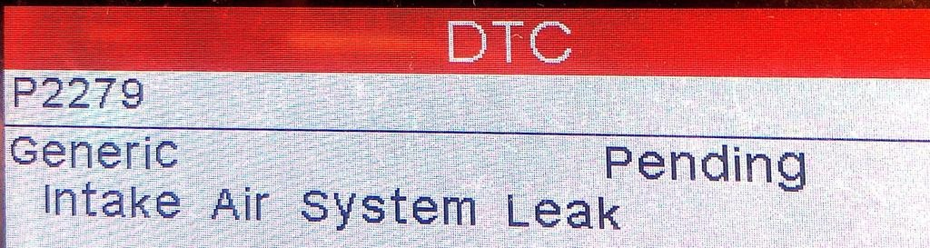

  1. Thanks very much @xman I will check it .. I would like to share the fault details as well 18950 - Leak in Air Intake System P2279 00 [237] - - MIL ON - Confirmed - Tested Since Memory Clear Freeze Frame: Fault Status: 00000001 Fault Priority: 2 Fault Frequency: 4 Mileage: 222211 km Date: 2022.01.31 Time: 17:29:26 Engine speed: 3907.00 /min Normed load value: 99.6 % Vehicle speed: 103 km/h Coolant temperature: 96 °C Intake air temperature: 43 °C Ambient air pressure: 990 mbar Voltage terminal 30: 13.923 V Unlearning counter according OBD: 40 Mass flow through throttle valve: 363.1 kg/h Median injection timing: 6.779 ms Engine operating condition: Part. load Engine operating condition-Test_Program_Channel 87: 6

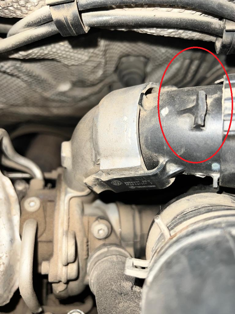

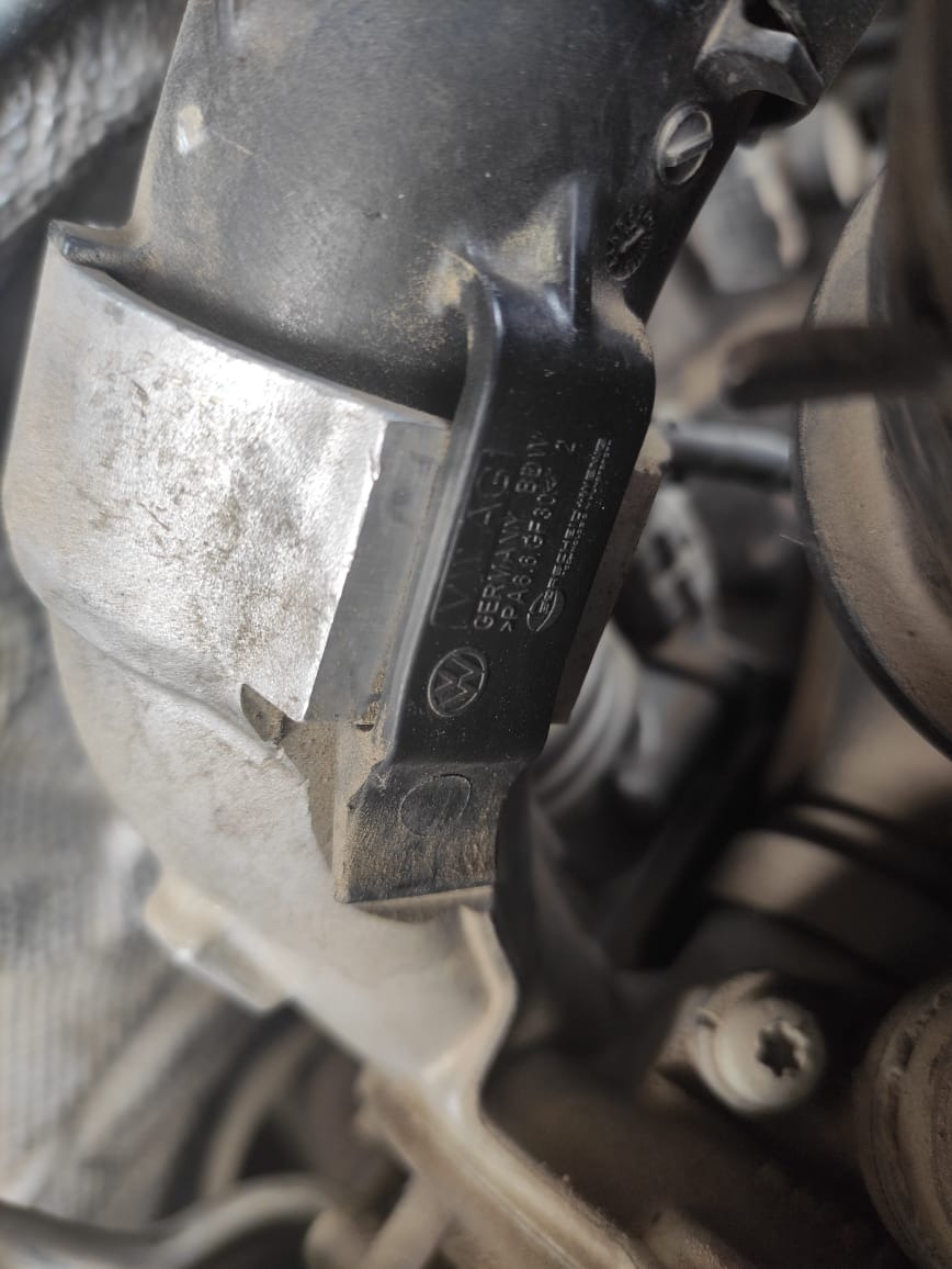

  2. Hello Gaz Not it is not showing the part number it shows pa66GF30
  3. I think I found it https://parts.vw.com/p/Volkswagen__/Turbocharger-Intercooler-Pipe-Adapter/51237490/04E145875F.html 04E145875F Is this part number correct?

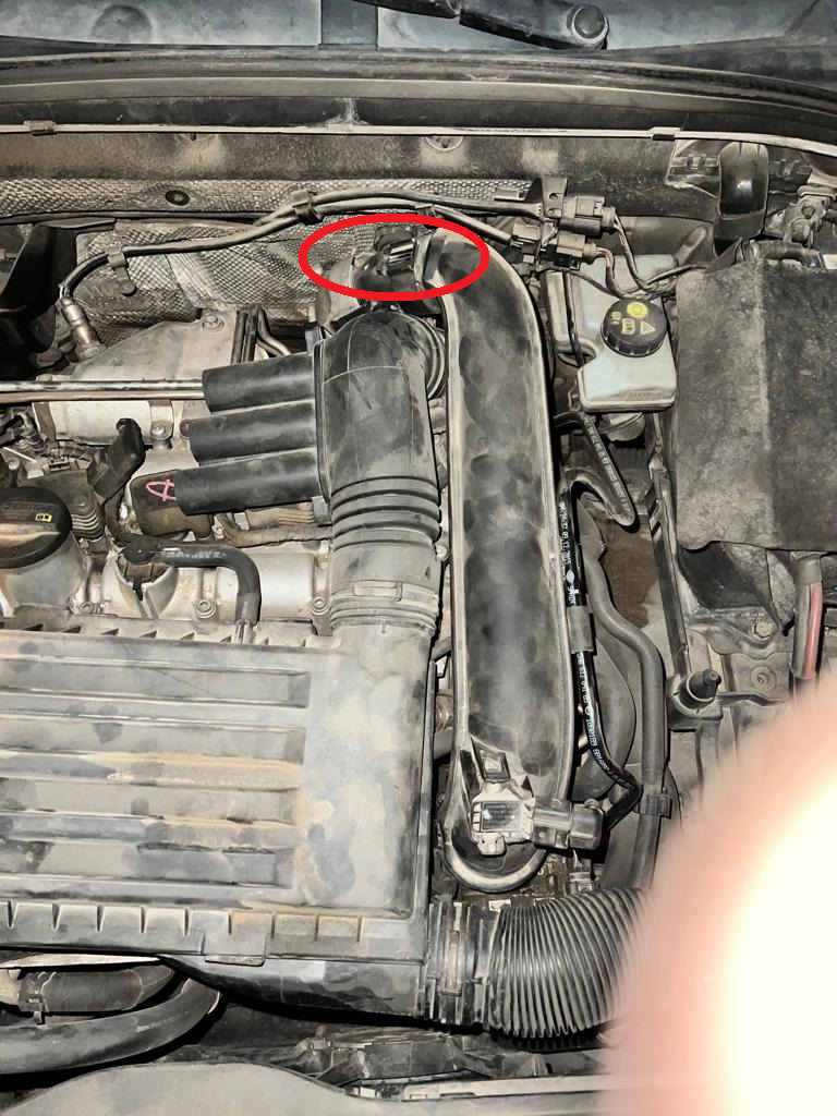

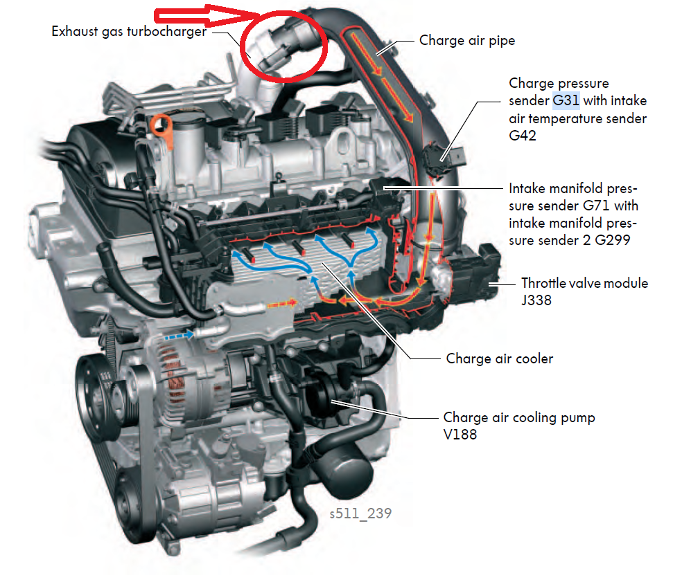

  4. Hello, I kept getting this error for few months. I replaced the Manifold and the Turbocharger. Also the throttle-body seal. After replacing them the performance was very good for 2 months. But I start getting this error again. Do you have any suggestions? do you think shall I change the air-pipe ? or any sensor ?
  5. Hello, I was trying to remove the air pipe and I broke this plastic clip. Can you help me please with the part number of this plastic part. (as it is not clear) Thanks very much.
