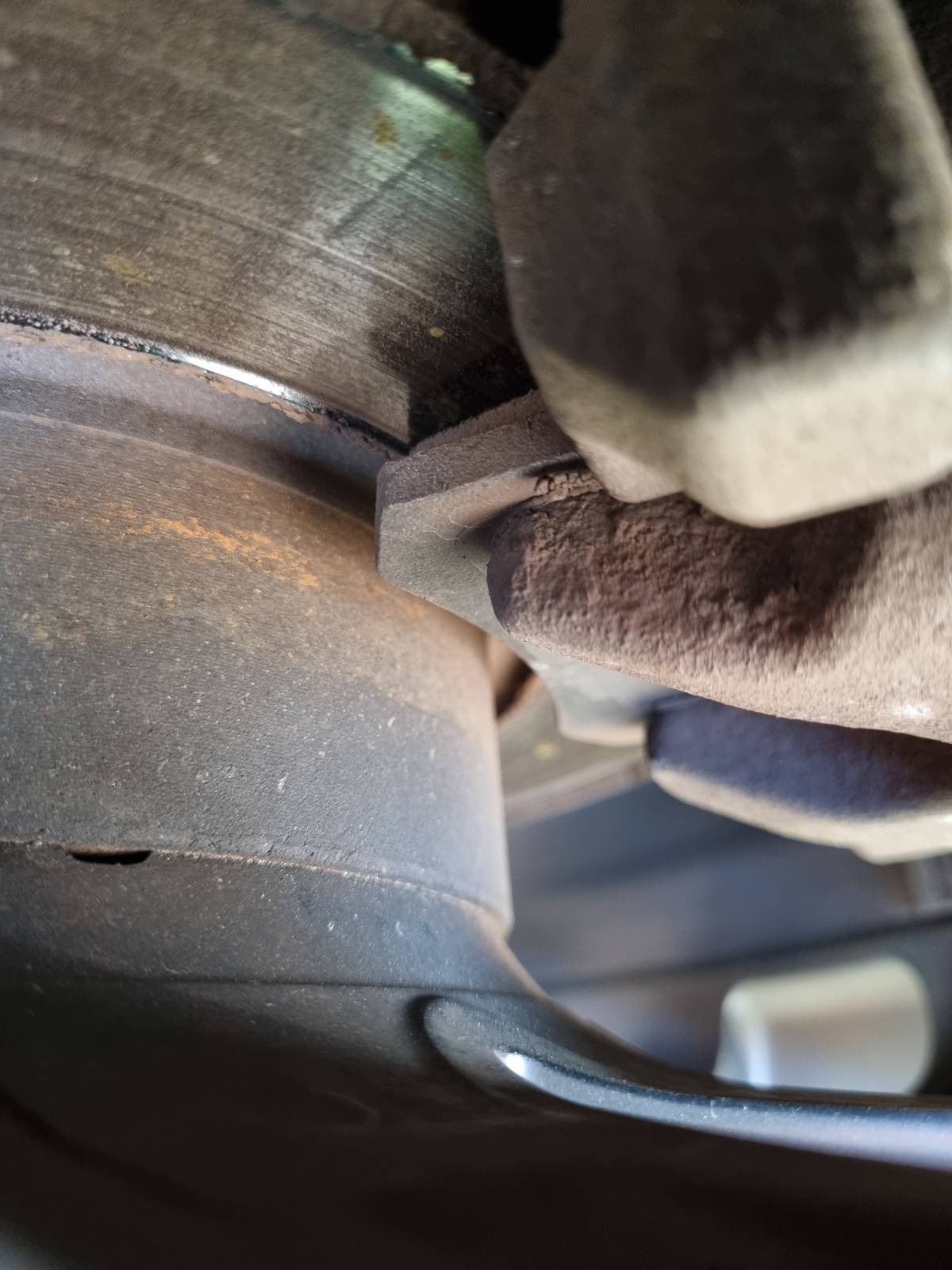

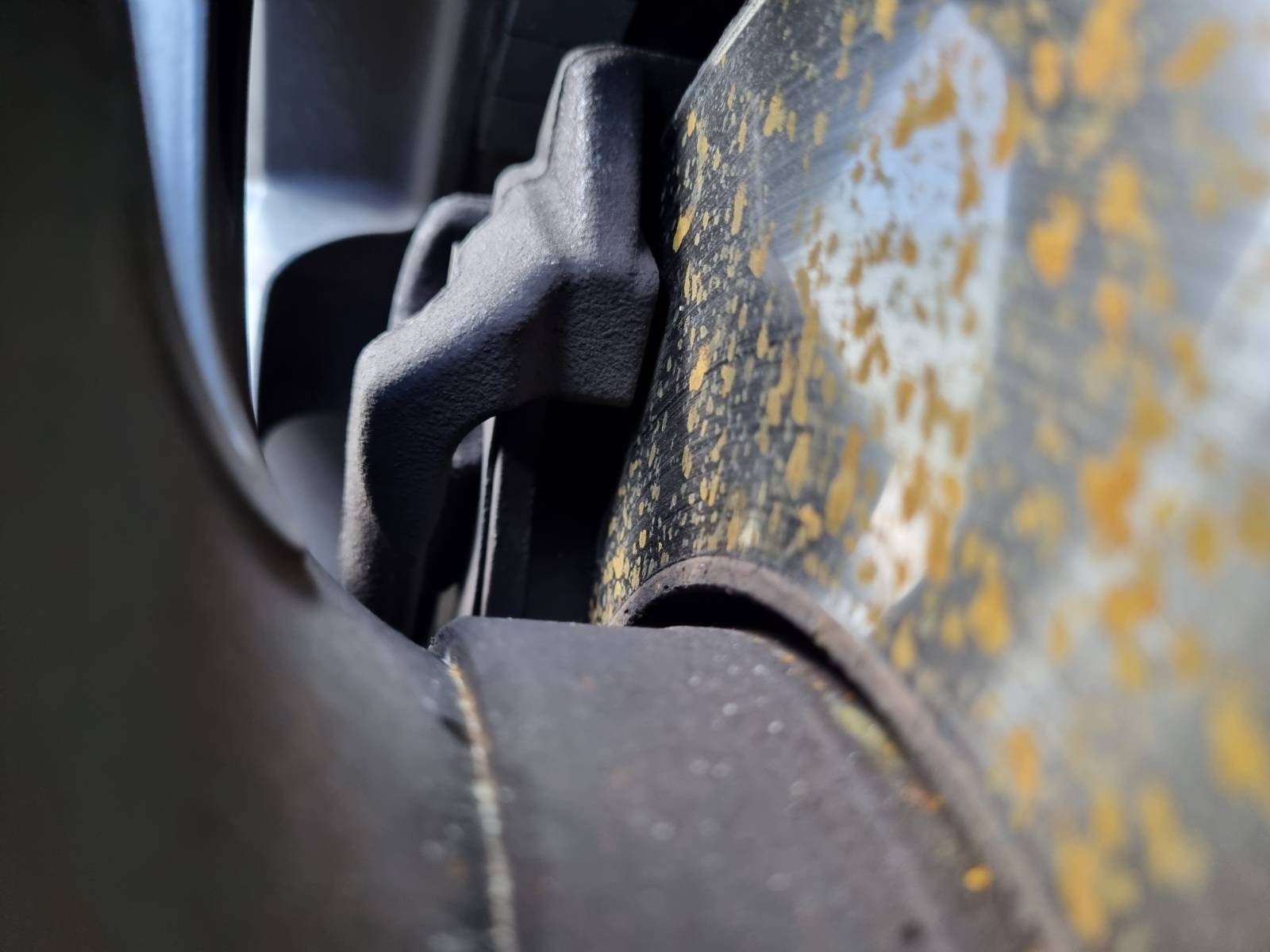

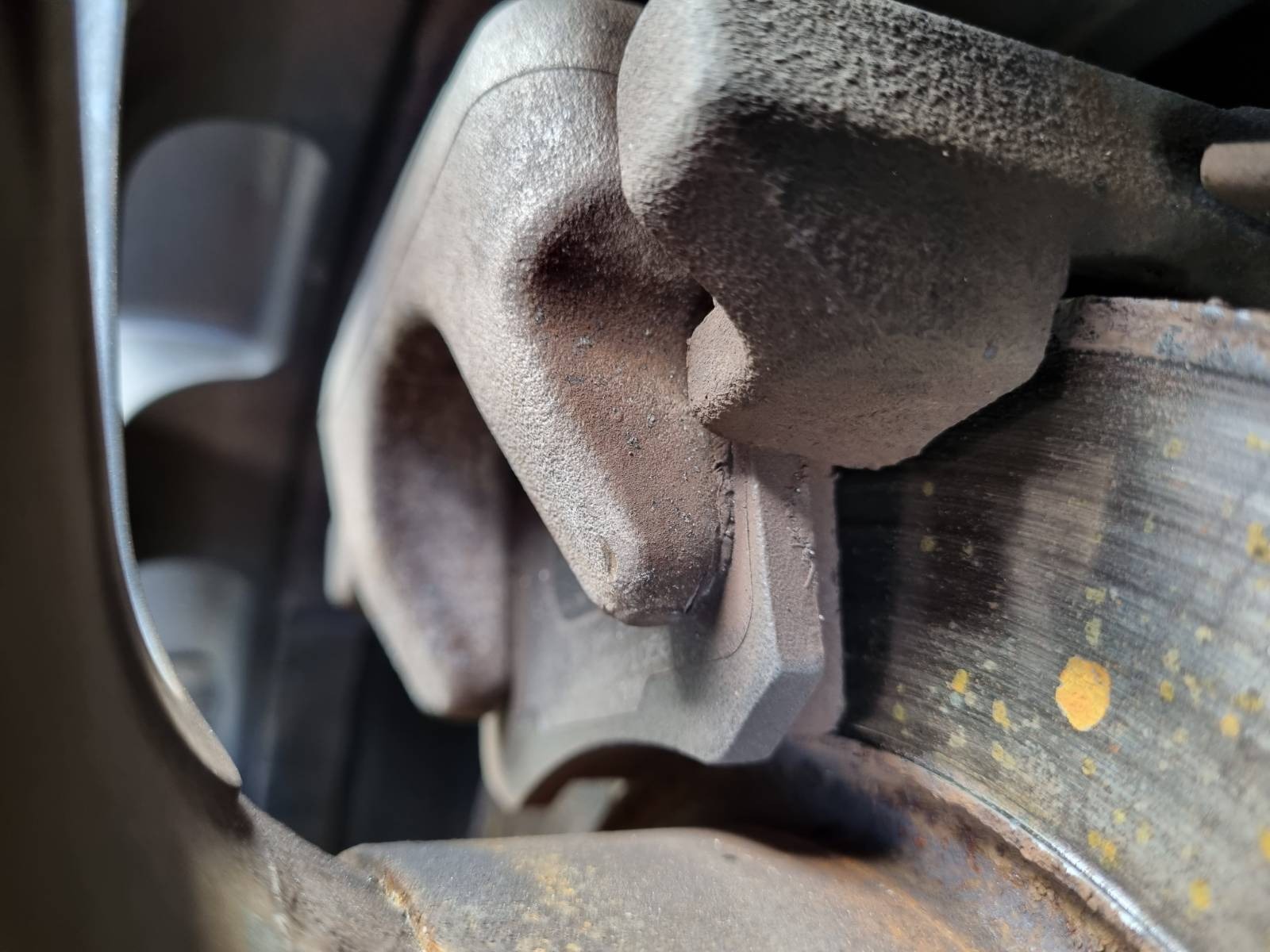

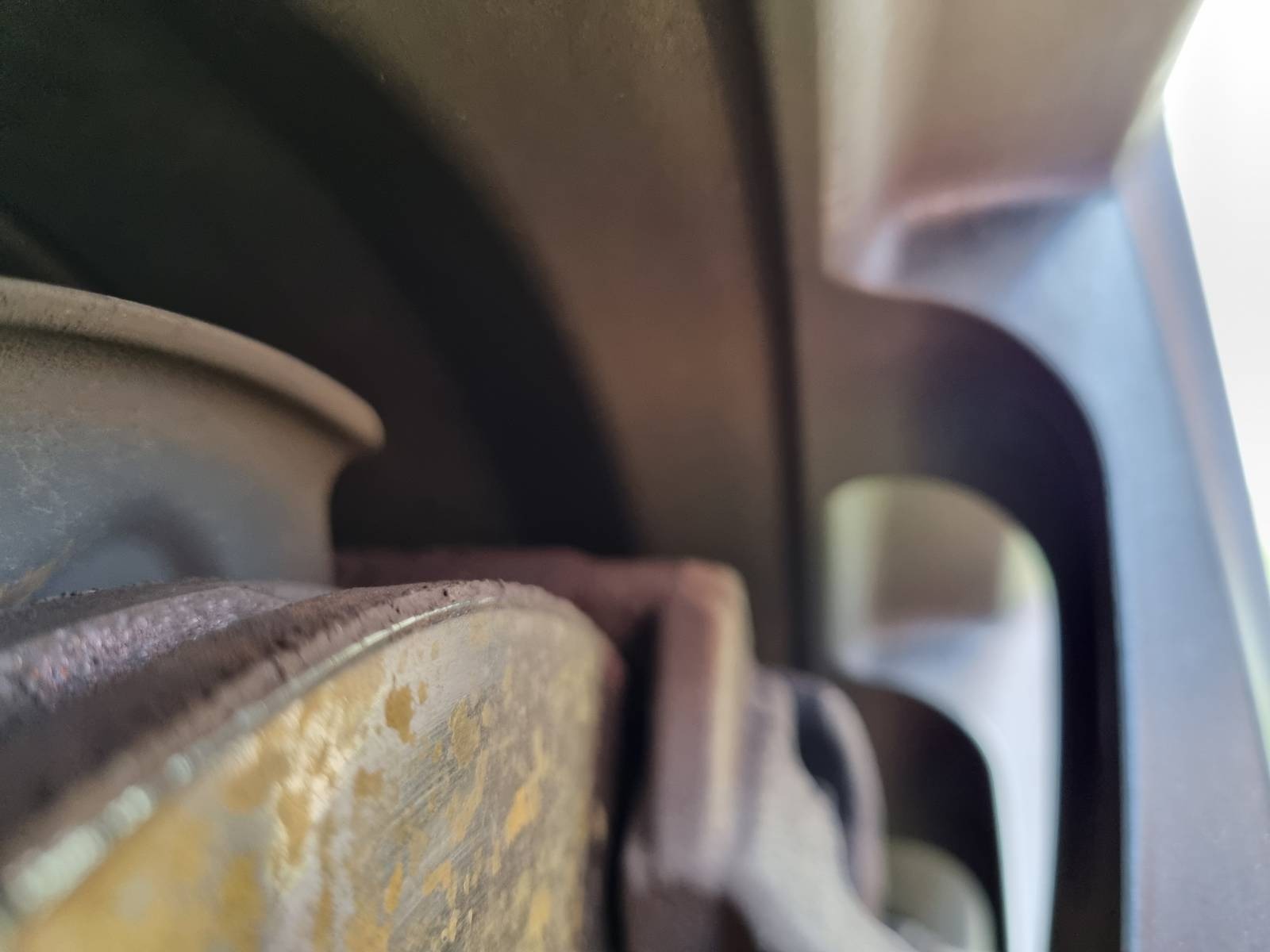

  3. Nobody was right. The problem was a loose anchorplate on one of the front wheels. This is the plate that protects the caliper and disc against mud and dirt from the inside. It was rusted through where the bolts were fixing it in place. This caused it to scrape on the disk. The brakes were fine.
  4. Aha, I think that probably is the cause of the noise That would make perfect sense, with the sound pitch changing with varying speed, but not with varying brake pressure applied. Thank you all. I will follow up after the service !

  7. That was also what I thought. The inner pads have exactly same age, so logically they would be similar conditions. It's hard to explain a sound in word, but it is exactly as I would expect to hear with something scraping against the disks while driving, including changing pitch following changing speed.
  8. Obviously the dealership asked if they should change the pads at the last service but admittet that with my driving history they would be fine until next service. My own thought was either, like you suggest, a small stone or something trapped, or, and that was my real concern, failing wheel bearings. Would that not produce such a noise? The car has done just over 210K km. Here are pictures from the front, through the spokes - taken after the car was parked overnight, hence the rust marks. The first two are the front, the last two the rear. Notice the fresh groove near the center....
  9. From what I can see through the wheel spokes the brakepads are low but still good. I have no way of seeing the back side - I'm not a mechanic and don't have a lift in my back yard. Obviously I limit the use, but have no option but to drive the car to the garage to get it fixed. The disks already appear a bit worn so perhaps they needed changing anyway.

  12. My 2015 Octavia has suddenly started having this noise that appears to come from the disks, like something is scraping. It follows the speed, but doesn't seem to change much by applying brakes. I know the brake pads are low and was planning to change them anyway, I'm just a little concerned if the noise is related to this, or something worse, like for example wheel bearings. Anyone experience with this?
