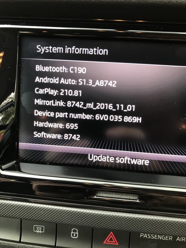

  1. I'd did wonder about the aerial and amp, however when I selected the "hidden menu" and looked at the Radio settings and DAB the stats for the stations saved to memory suggest a decent signal strength on all the Ensambles. I've not run the firmware update yet.
