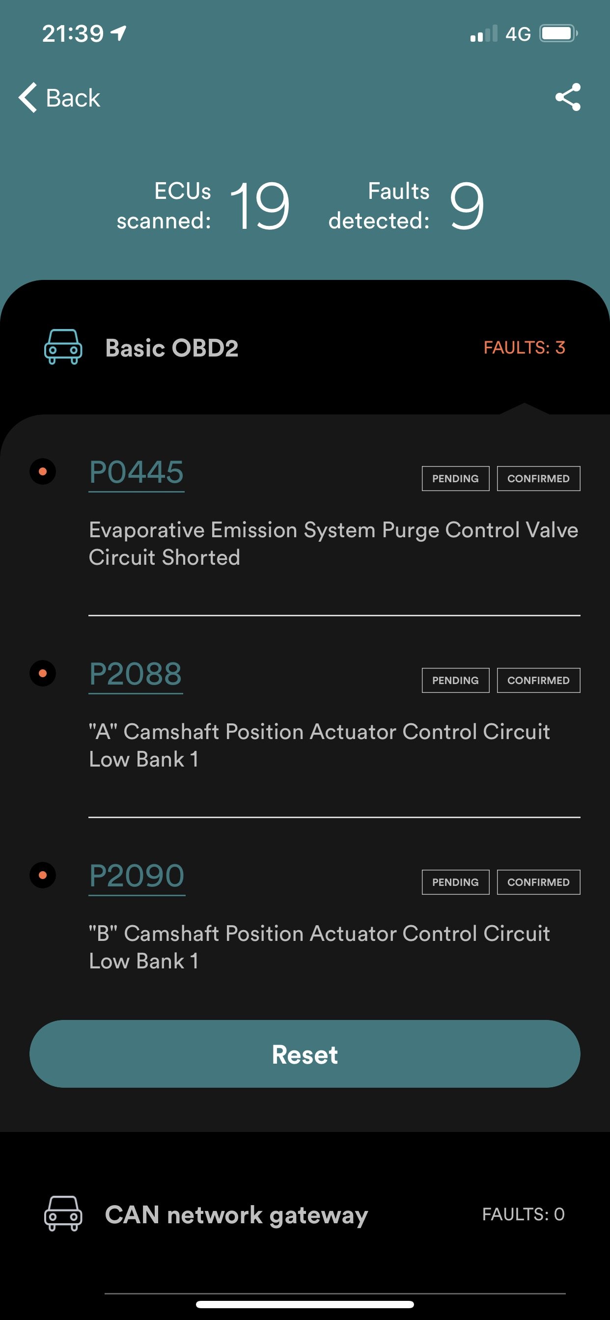

  5. So, my car’s been sat around a lot during lockdown, but it had a good run in July down to the coast and it’s been running fine. Went for a drive last week and the engine light came on, so I checked the codes and reset them and then it happened immediately again. The codes are P0445 (evap circuit), P2088 and P2090 which are both camshaft position actuator control circuit errors. I replaced the evap purge valve as it was only £13 but it didn’t make any difference, same errors. Checked the wiring and all looks fine. Car drives totally normal and it’s booked into Skoda for next week but anyone got any ideas on what it might be?
