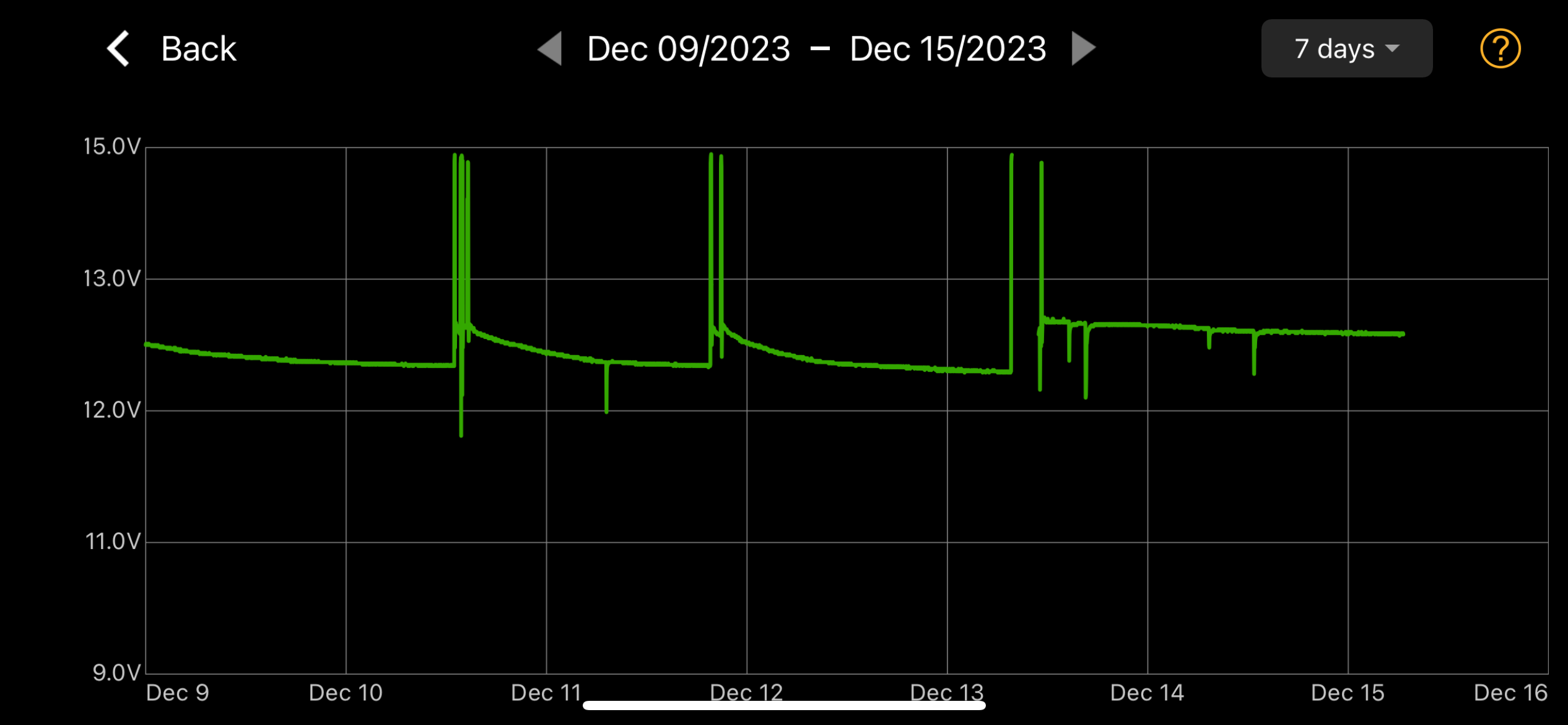

For those of you who were wondering whether my battery really was reaching end of life, or whether it was perhaps the BM2 battery monitor itself which was draining the battery, here’s the answer, from a screenshot which I took this morning in the BM2 app. You can see that since I changed the battery a couple of days ago, the daily drop in voltage is significantly less than it was with the old battery. I haven’t driven the car during the previous 2 days. The temporary dips in voltage were when I simply opened the car door, in order to pop the bonnet open.

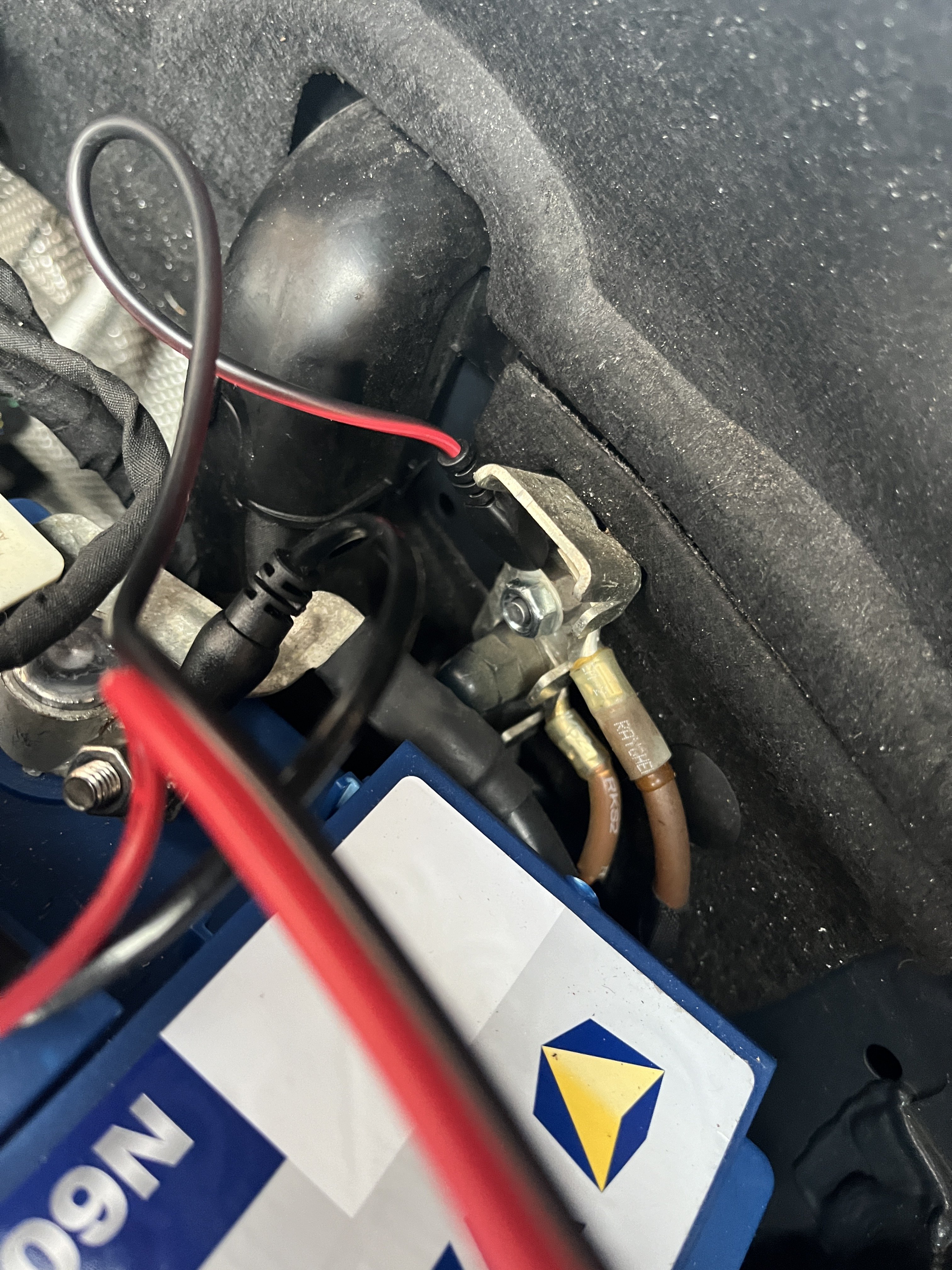

Thanks for your sound advice. I just checked, and you are absolutely correct. They have connected both the battery monitor cable and the CTEK charger cable to the negative battery post. Can I just attach the negative CTEK charger lead to one of the posts underneath the metal bracket where I would normally attach the crocodile clip? From what I can see, the CTEK lead is currently attached to the negative battery post using a secondary nut, so I should be able to move it without affecting anything else with the battery itself.

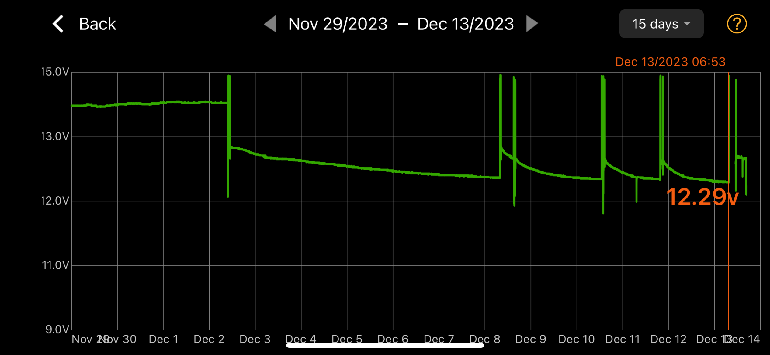

I just had the new battery installed today. I’ll monitor the voltage level over the coming days and weeks to see whether the battery discharges at a slower rate than the old one, which was losing between 0.1 and 0.05V per day, when not being used. Below is a screenshot which I took this evening, for the past 15 days. It was at about 12.29V this morning, before I took it to the garage to have the new battery fitted.

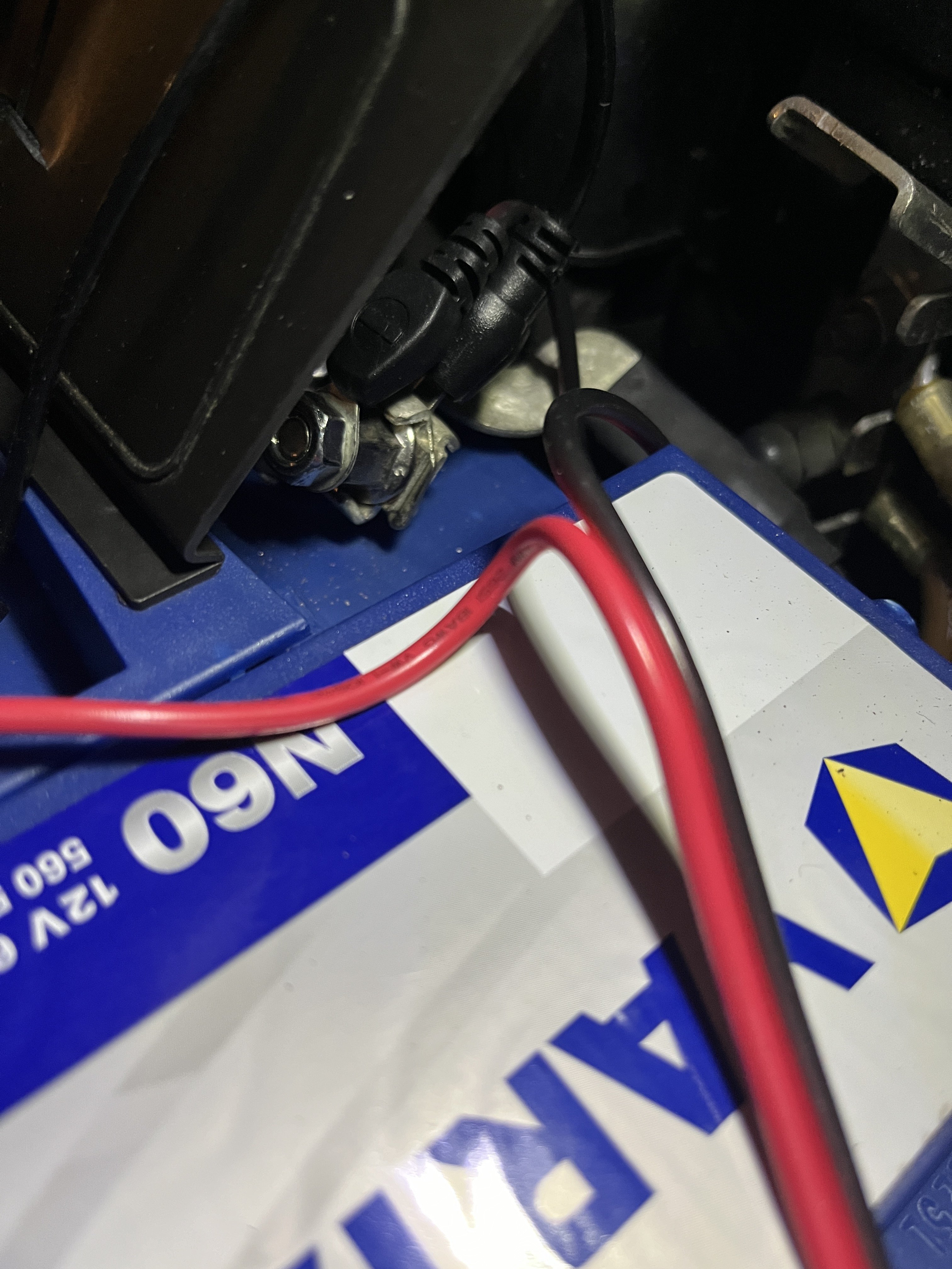

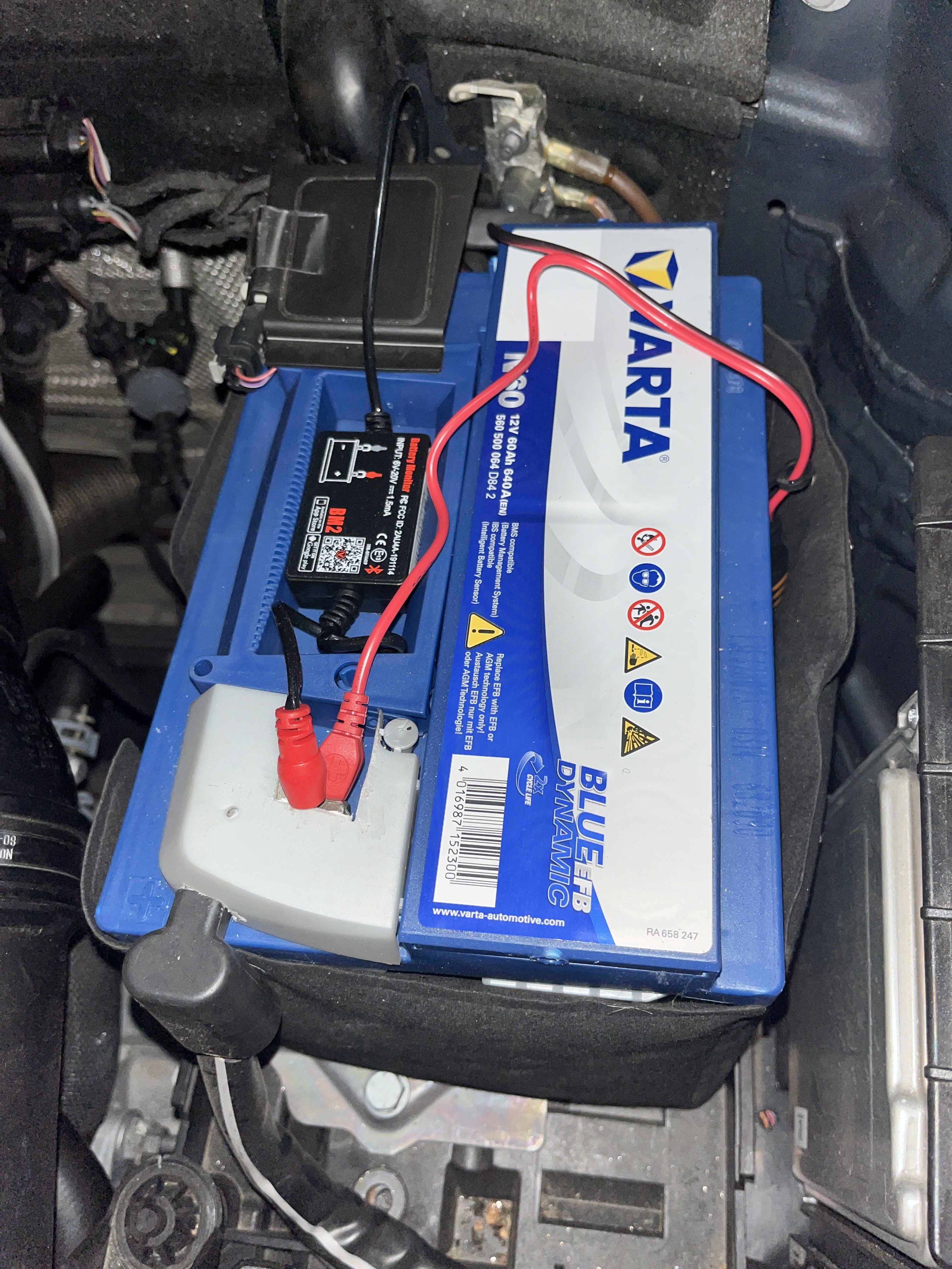

I ended up getting a brand new battery fitted by my local independent garage. It was £170 including fitting, for a Varta EFB battery. They moved my BM2 battery monitor to my new battery. The new Varta battery even has a recess on the top which is the perfect size for the BM2 battery monitor! They also fitted the cable for my CTEK battery conditioner to the battery, so I can connect the CTEK device more easily, without having to mess around with crocodile clips.

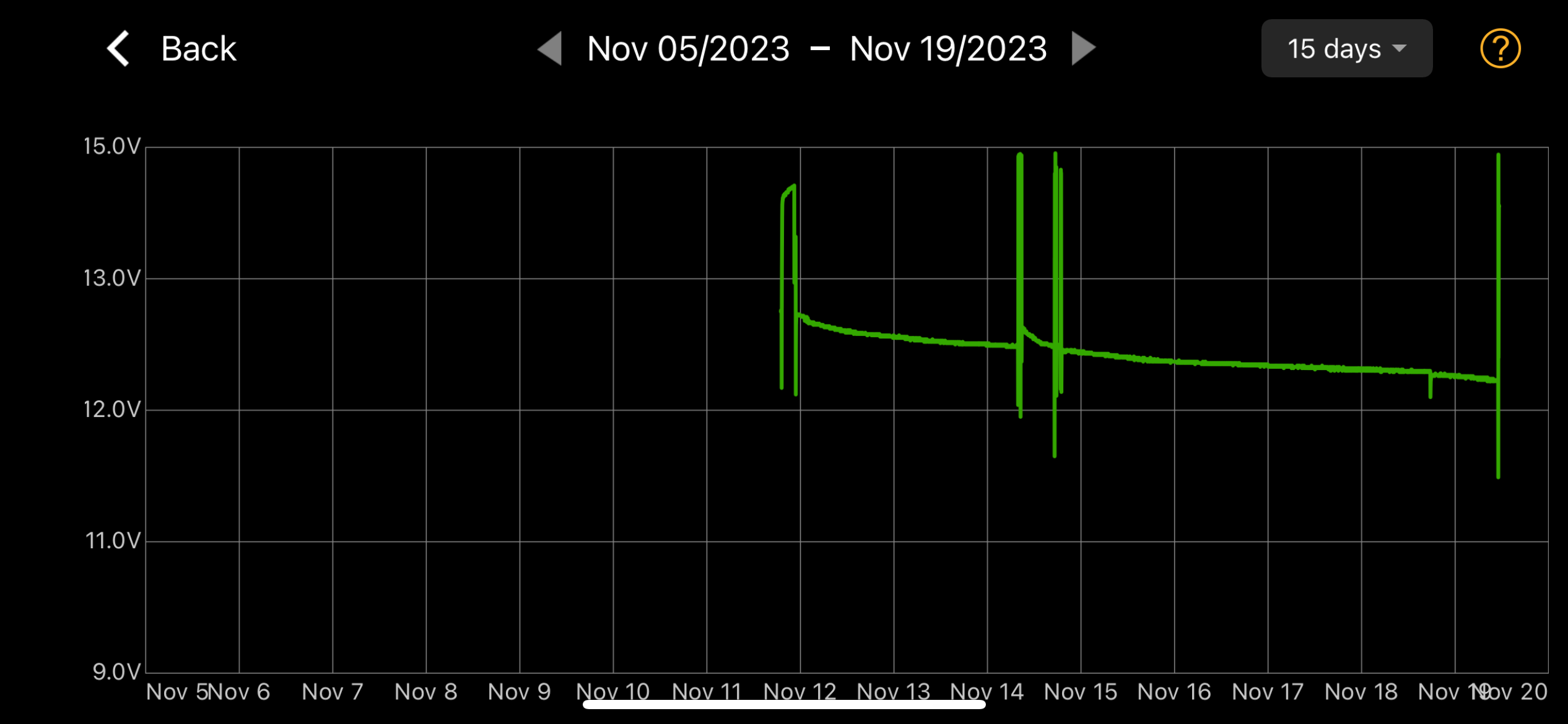

I recharged the battery last weekend, using my CTEK charger. It has been in the garage all week apart from Tuesday, when my wife used it for a couple of short journeys of 10 minutes each, and a couple of 30-minute journeys. When I checked the BM2 app last night, it was showing the battery level having dropped from 12.62V (“OK”) last weekend to 12.26V (“low power”) this weekend. You can see the battery level progression in the attached screenshot. The battery voltage is dropping by around 0.03V to 0.05V per day. Does this kind of drop in battery performance over the course of a week mean that the battery definitely needs replacing, or is this typical of what a battery would normally lose per day? The “Cranking test” last night was showing “Low cranking voltage” of 9.27V. I have put it back on charge with my CTEK charger again today. I’m slightly confused by the comments about the “Recondition” cycle on the CTEK charger. Why would CTEK be recommending to do this once per year, if it’s bad for the battery? Is it really completely discharging the battery? According to the CTEK manual, this stage comes AFTER stage 6 ie. after the battery has been fully recharged. If it was completely discharging the battery, I would have thought it would do this BEFORE it recharges the battery, wouldn’t it? Please forgive my ignorance, if these are all dumb questions. I’ve never had to change a car battery before, so I have never paid any attention to this issue previously. I previously had a diesel BMW with stop-start functionality for more than 6 years, and I never had any problems with it, but most of my journeys in that car were more than 30 minutes each, and it was used almost every day. Our other previous car which was used mainly for short journeys (a Toyota Verso), which we kept for more than 6 years, also never gave us any problems with the 12V battery, but it didn’t have stop-start functionality, so maybe that’s the difference compared to our Skoda Karoq which replaced the Toyota Verso.
