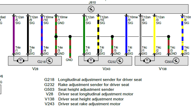

  1. Hi all, I really need some help! Got a Skoda Superb Estate II and unfortunately the drivers electric seat has stopped working :-( A couple of questions: 1. Is there a way to manually move the seat? I can't find any way at all but thought I would ask! The reason it's so important is my daughters wedding is next weekend and I really really need to move it! 2. If it can't be moved manually can I unplug the controller completely and add 12v power to the pins for the motors!? i.e. in the diagram below could I supply the purple and black motor wires on v28 with +12v to move the motor one way or the other (obviosuly one at a time as assume one is back and one is forward)? Any advice greatly appreciated!! Rich
