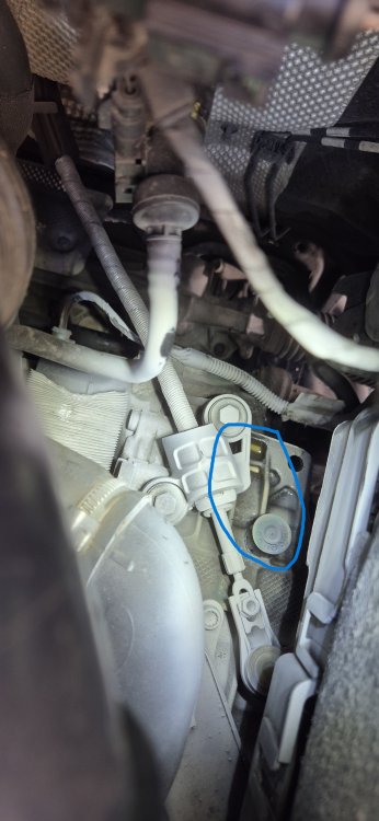

  3. So I thought I'd give an update on this issue. They were wrong, quite categorially. It wasn't the steering column joint and the TPI work did absolutely nothing to cure the problem. Both noises still exist. I took the car straight back and we're now in a holding pattern with Skoda. I have to take the car back for more investigations. I'm not hopeful. Regarding the oil leak, I've inspected both underside of the gearbox housing and the top. I see oil trail below the breather, and none above. My working theory is that it's been overfilled. As the oil heats up it's not only expelling the air to avoid pressure build-up but oil as well. If I'm correct, it took me about 30 seconds to find this, and I'm no mechanic. My faith in the dealership's ability to troubleshoot is reducing. I wasn't going to tell them what I think it is because I'm curious about what they come back with . . . .
