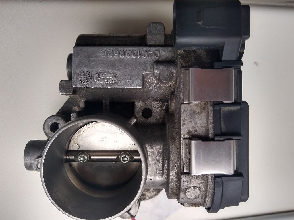

  1. UPDATE: Drilled a hole in the underside of the Throttle Body (This was quite simple..... used a metal drill bit in a normal battery drill) Tapped out the securing pin and cap Unscrewed the two torx screws for the metal circle Remove the metal disk This will allow the centre shaft to be removed NOW WE KNOW THE ISSUE: So the issue is a BROKEN SPRING! ...... so the next questions ........... can I get a replacement spring and how much is it going to cost

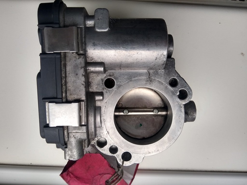

  2. So..... I've found a video on Youtube Next step is to remove the throttle plate (Metal circular thing) by removing the 2 x Torx screws ........ then comes the weird bit You have to drill the throttle body from underneath with a 2mm drill bit ...... once drilled you can tap out the holding pin ........ then the central shaft will slide out See images:- Top - circled green (where the pin is) - Bottom - circled run and arrowed (Where to drill) Once the shaft is out this will give access to the spring Guessing further posts to come
  3. Hi Forum ...... i'm back The 2nd hand Throttle Body is doing well in Mum's Fabia! I've started taking the other one apart ..... and would like to know how I do it fully I've took off the metal clips Removed the end plate Removed the free gear Now I'm stuck ..... what do I need to do get the black plastic gear off? I think the fault with the Throttle Body is a broken spring as the gears look in great condition If I can fix it it can either be sold to a forum member who may need a cheap repair or can be used for a spare for Mum's Fabia

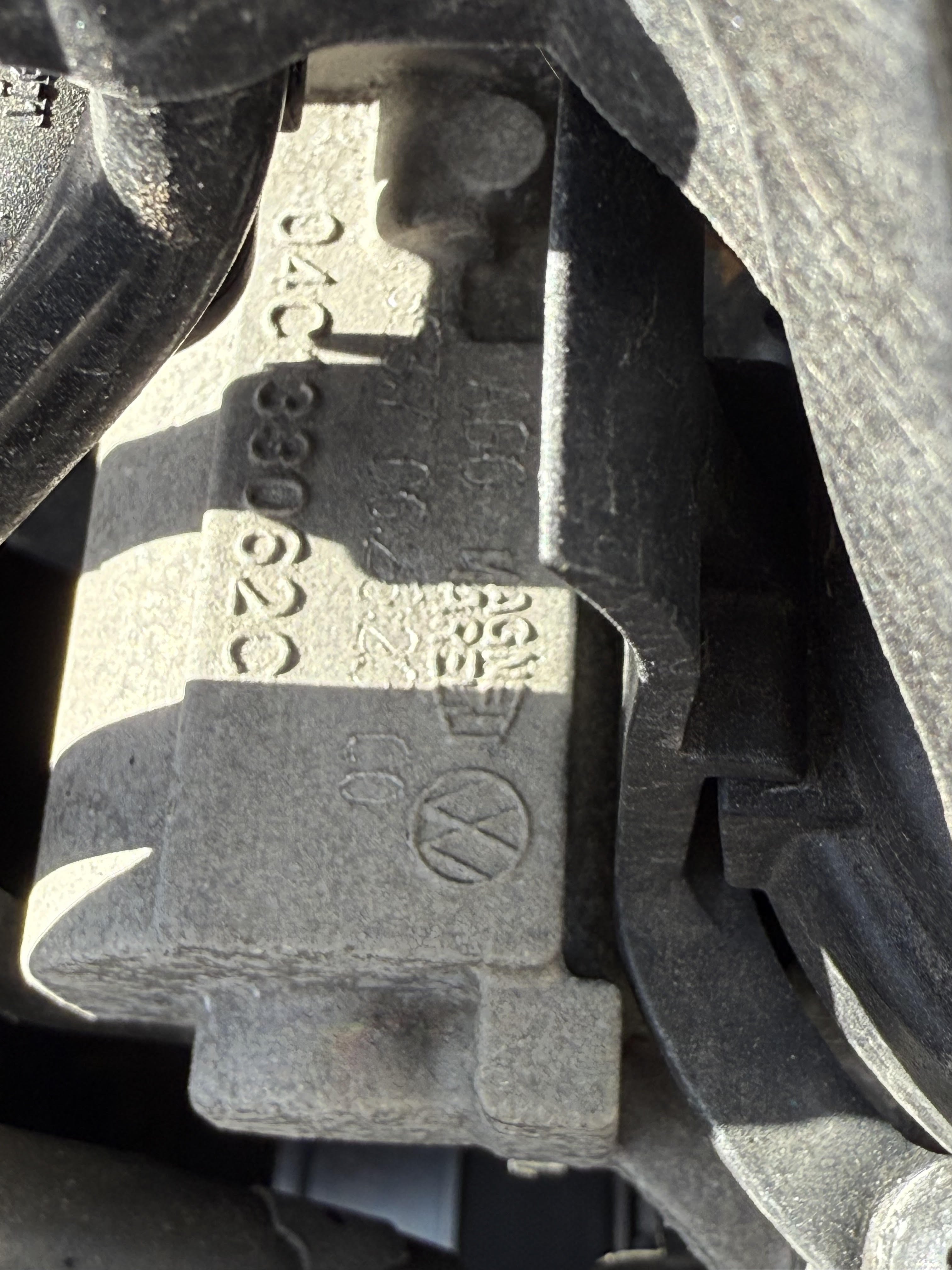

  9. UPDATE: We're going to get the battery fitted tomorrow and we've got a slot at an Auto Electrician on Thursday They're going to do some proper scans and hopefully narrow down what the fault could be (and they'll code the battery) They've been recommended by another Auto Electrician and apparently, they have the correct kit General Info - Throttle Body - OEM Part No: 04C133062C Parkway VW wanted £504 for the Magnetti OEM Part GSF wanted £370 for the same OEM part A trusted local motor factors quoted £590 for OEM and £219 for aftermarket All prices Inc VAT

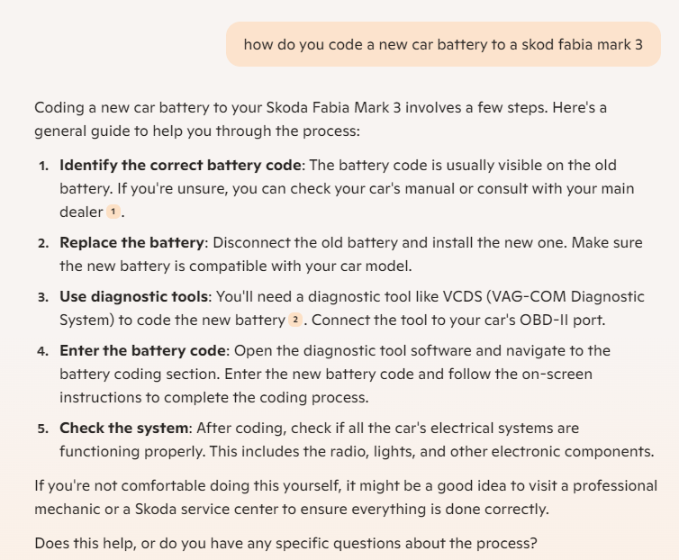

  11. Microsoft Co-Pilot advises this: Do the people agree with the AI?

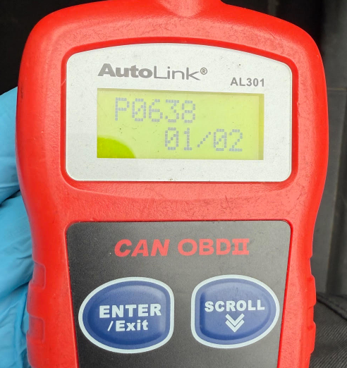

  12. Another fantastic reply! ......... and exposes how little I know about how cars have evolved (I drive an '08 Auris and my brother a '10 i30) This is where I show my naivety and ask for a link: Can someone provide a link (or steps) to how a battery is coded to a vehicle ..... appreciate this is going to be complex ..... as it's probably a combo of ..... get this software / get this cable / go to this area / enter this value (type of thing) Green Flag Callout - Battery - Was advised that voltage looked a bit lower than "normal" and 5 cells weren't as strong as they should be Scanner - This was a picture taken by my brother at the time of the callout - Codes were cleared - Car was rescanned

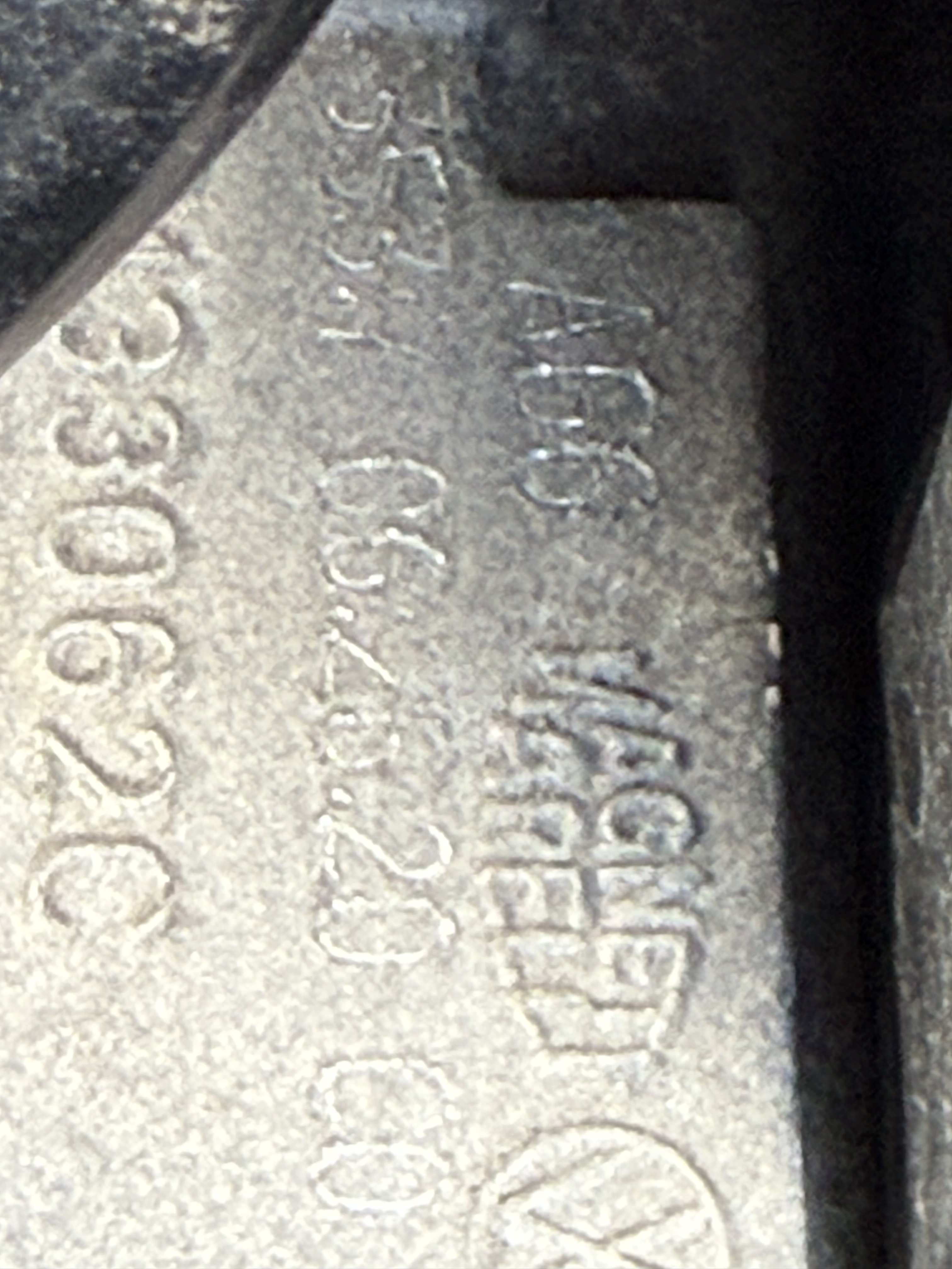

  14. Additional Information: Engine Code is: - CHZC794713
  15. Hi Forum Mum has a 2018 Fabia that has gone into limp mode - Also the Start-Stop is complaining of an Error She managed to get home and we called Green Flag who plugged in a code reader Code returned P0638 Q. Is this a throttle body sensor error or a throttle body error The throttle body is a Magnetti Marelli VW - 04C133062C Q. Do you repair or replace Q. If replaced, what is the difference between them as the costs can vary and some say they require learning / teaching of the throttle body Final Question Q. Can someone provide a few suggestions of where to obtain a throttle body
