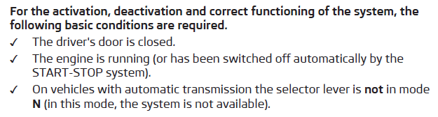

  4. OK, I'll try that... What would that confirm though ? I assume the Auto Hold button light would be still on, right ? it is just dashboard wouldn't have the green (P) light when brakes pedal is pressed in neutral ?
