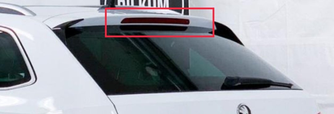

  4. No, there is no obvious damage. Do you have to take the tailgate trims out (both lower and upper) to get access to the light unit? I tried this today after several weeks of hibernation on this matter (lack of time) and there are some clips that are TIGHT. I was afraid the trim might get damaged and thought to ask for instructions, if there are any. :')
  5. The brake light next to washer jet doesn't light up anymore when applying brakes. Error code shows after starting the engine and applying brakes. Turn the engine off, start again and no error codes. After engine has been started and error appears, VCDS says: "11274 - Bulb for Center Brake Light B12C6 15 [009] - Open or Short to Plus Confirmed - Tested Since Memory Clear Freeze Frame: Fault Status: 00000001 Fault Priority: 1 Fault Frequency: 1 Reset counter: 28" Any idea what might be the solution? Does the light have a separate fuse? Do I have to replace the whole lamp, what's the part number? Have the wires been prone to break? How does the wiring cover come off from the tailgate? Many questions but I haven't had this issue with the car so far and I've got no clue on how to disassemble the tailgate plastics etc. Better be prepared if someone has experience already on this matter. 👍🏻
