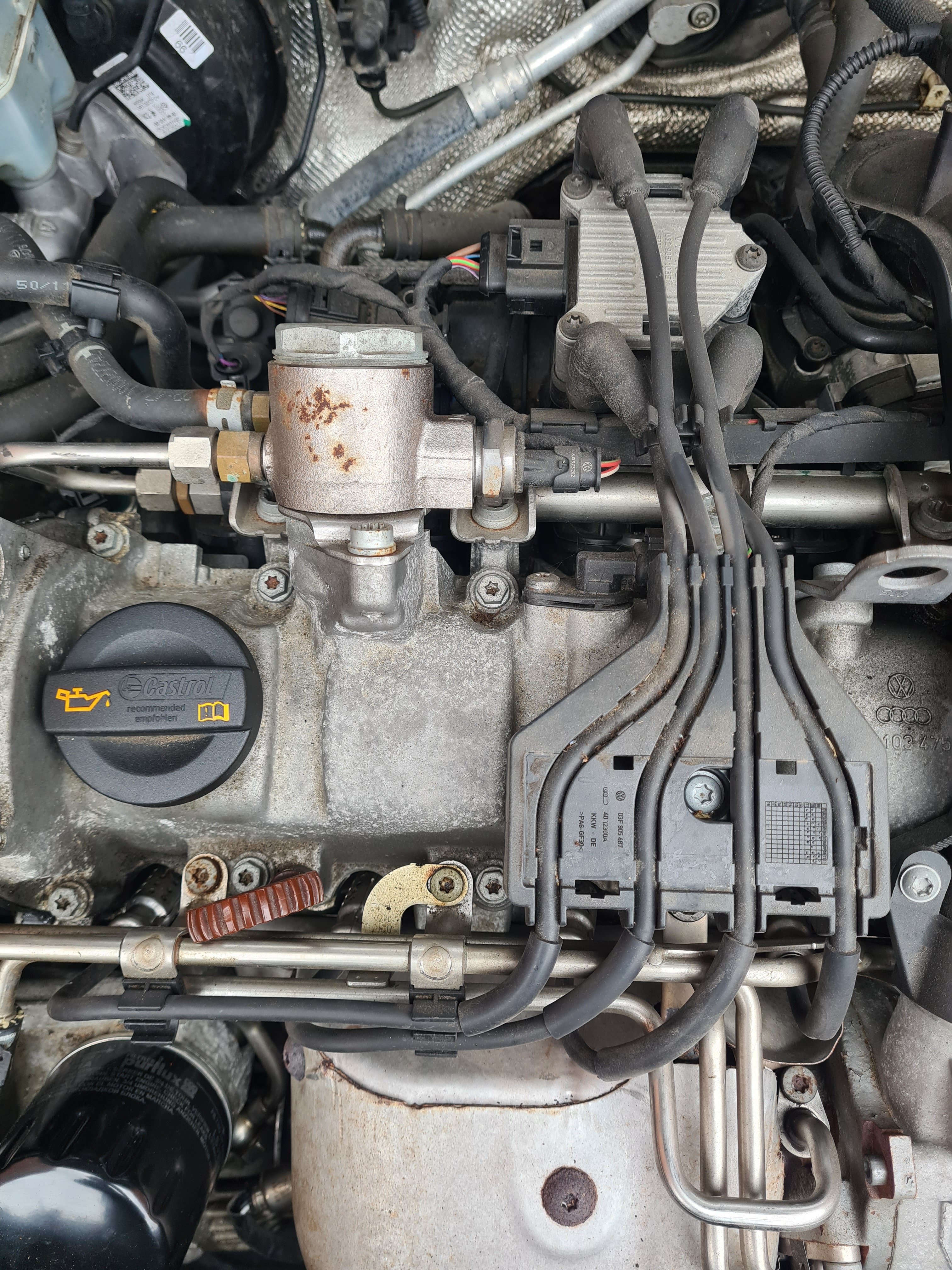

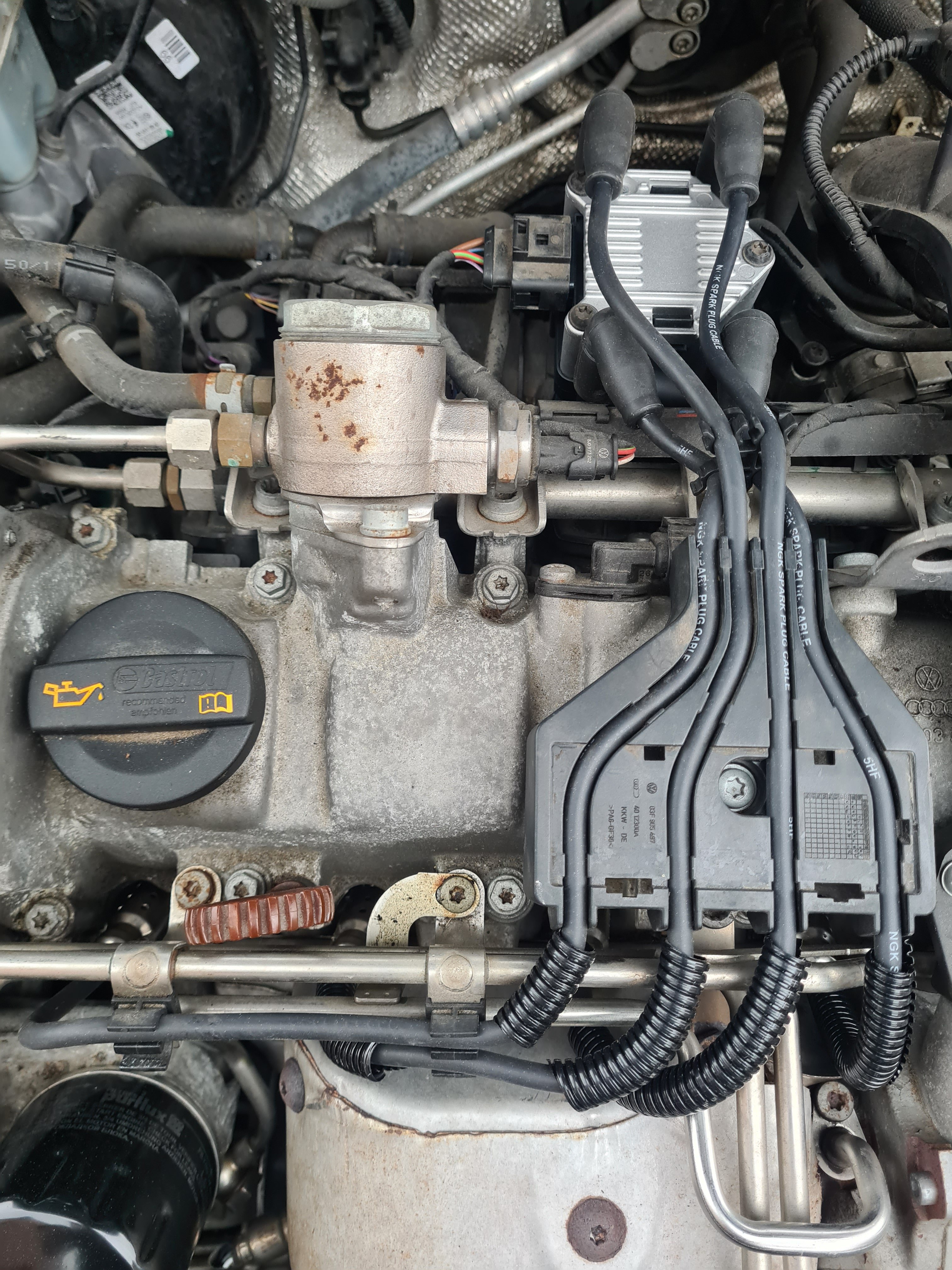

@Ootohere she's a 2012 plate, with just 60,000 miles on the clock. According to service record, the spark plugs were last changed 5 years ago, just before I bought the car. So, I thought it would be good practice to change plugs, leads + module. I fitted : Bosch FR6HI332 Plugs NGK 44316 leads Intermotor standard 12919 module. The old HT lead to cylinder 3 looked shot, when removed, so needed replacing. N°3 spark plug also looked very sooted at the bottom. Old vs new....

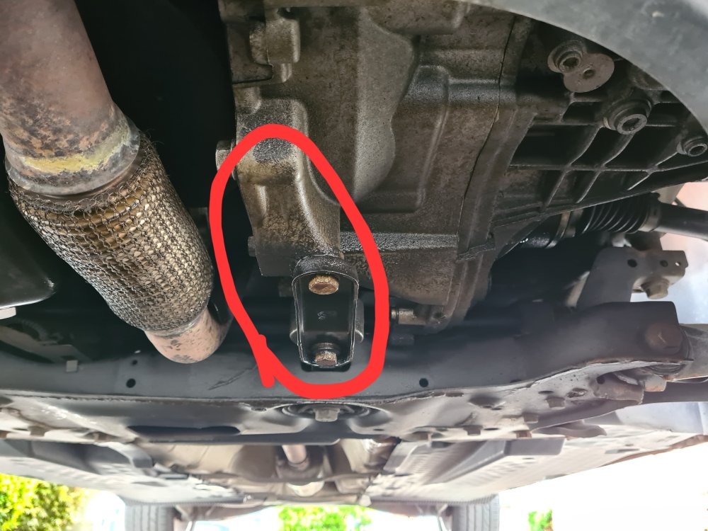

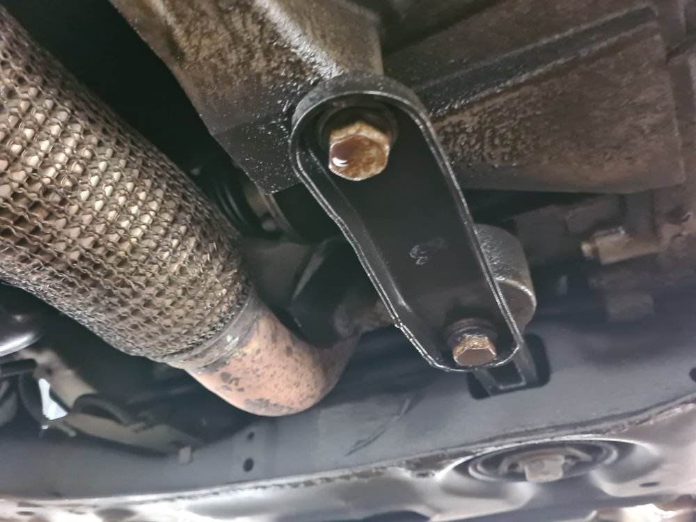

Thanks for the replies everyone. Just showed my pics to a very experienced mechanic & he immediately felt sure it's a leaking drive shaft seal. Very common, apparently. He said it's nothing too serious, but I will eventually have to top up gearbox oil if not repaired.
Hi everyone. My 2012 1.2 tsi has developed a slight oil leak. I'm not sure where from, so I would be grateful for any ideas. I've included a couple of pics of gearbox, where droplets of oil can be seen to pool on the bolt before dripping off. Any help/ ideas appreciated.
