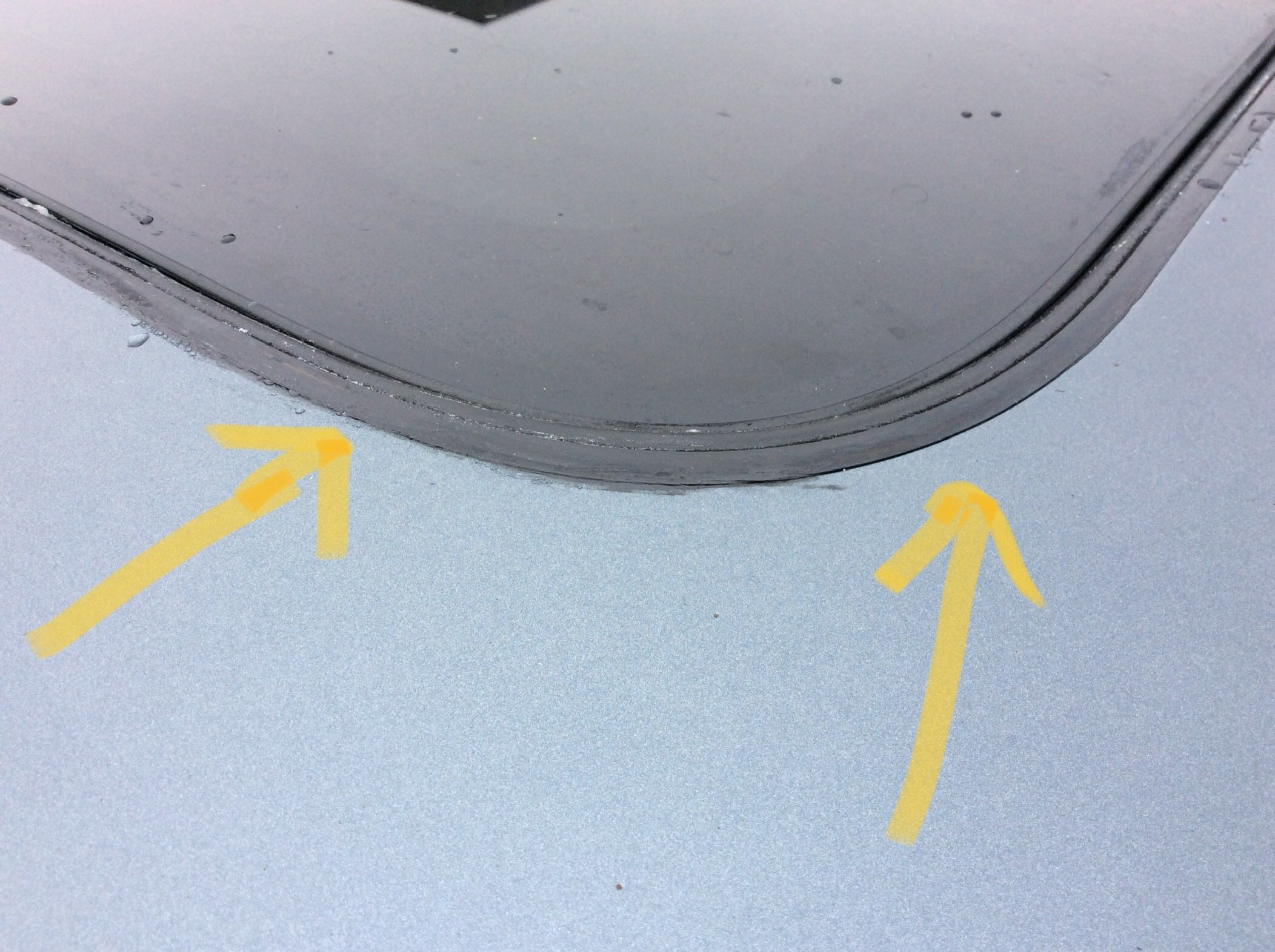

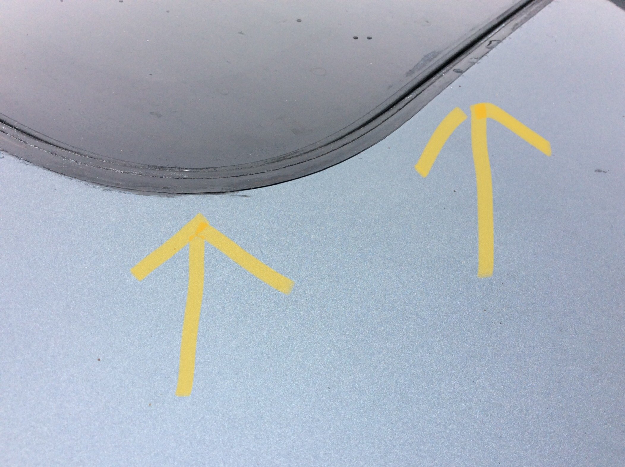

  2. Also seen here the sealant problem
  3. The procedure was as followed......... I liften up the rubber Outer seal off the panoroof up a little bit and put in the nozzle off the sealant and little by little put in the sealant in the gap underneath working from half off the roof to and trough the corner to the other front corner and up to the other half off the roof. I didn’t do anything on the inside off the roof or roof cassette. it certainly did the trick on my car. my roof was leaking at spot in photo inside car. Have no experience with wrapping the panoroof........hope it stays that way 😉

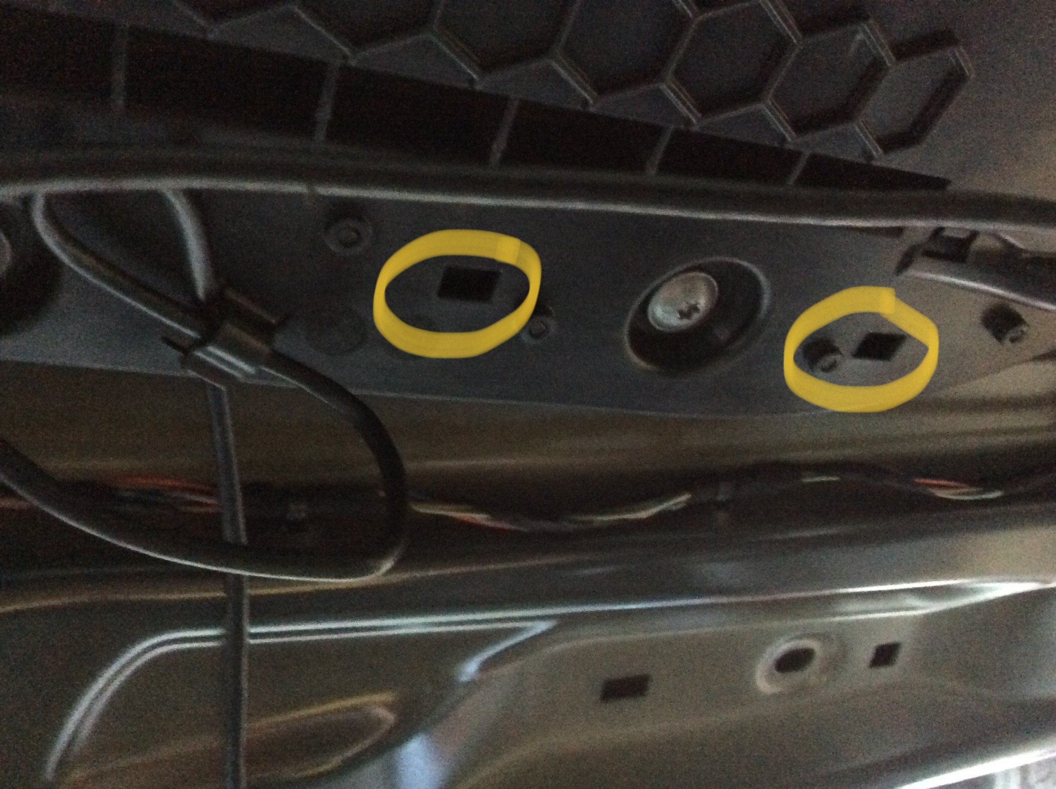

  4. You can see the rear interior lights here....... regards Lico
