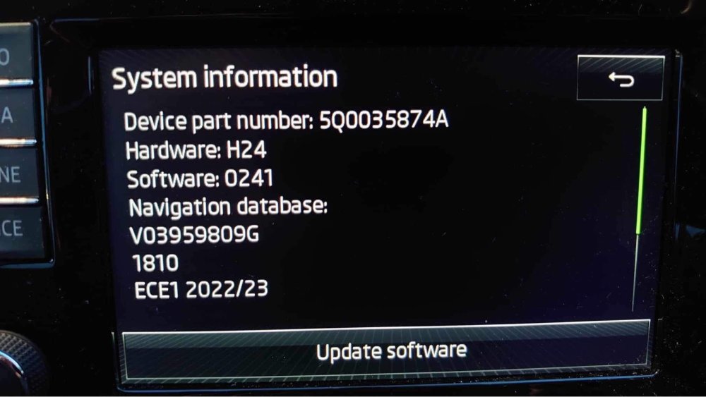

  1. Thanks for the replies folks, and for including the link to the manual. Deleted profiles, phones and reinstalled from scratch and it’s now working for showing contacts and adding favourites πŸ‘
  2. Hi folks, I have a 2015 Rapid and recently changed from an Android phone to an iPhone14. I am unable to import phone contacts to add favourite numbers. I have never used SmartLink so far as would need to purchase an activation code and wonder if the hardware may be too old or if the firmware would need/could be upgraded (though no option for upgrades show on the portal, other than updating the maps). Any suggestions would be appreciated for how to import phone contacts and if firmware could be updated or if SmartLink code would be worthwhile purchasing? photo attached shows system info. There is also the unit in the glovebox with 2 SD card slots. Thanks, Ian
