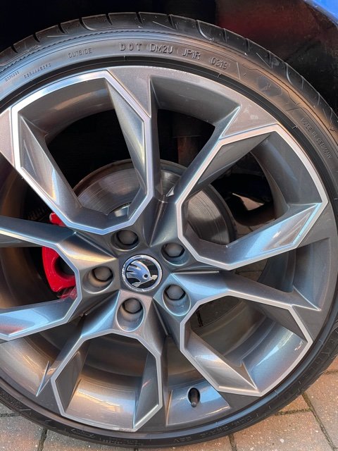

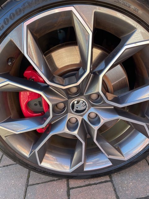

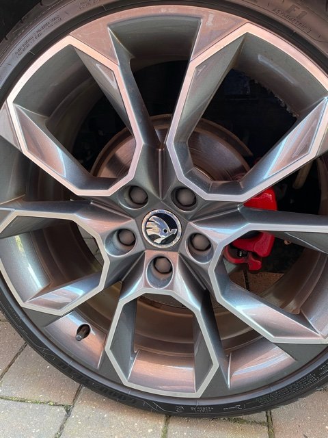

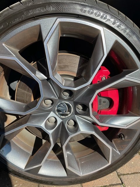

  2. Hi, Thanks for your replies, Ecomatt I’m not sure if they greased the sliding pins or not - could this make a difference in your opinion? Regards
