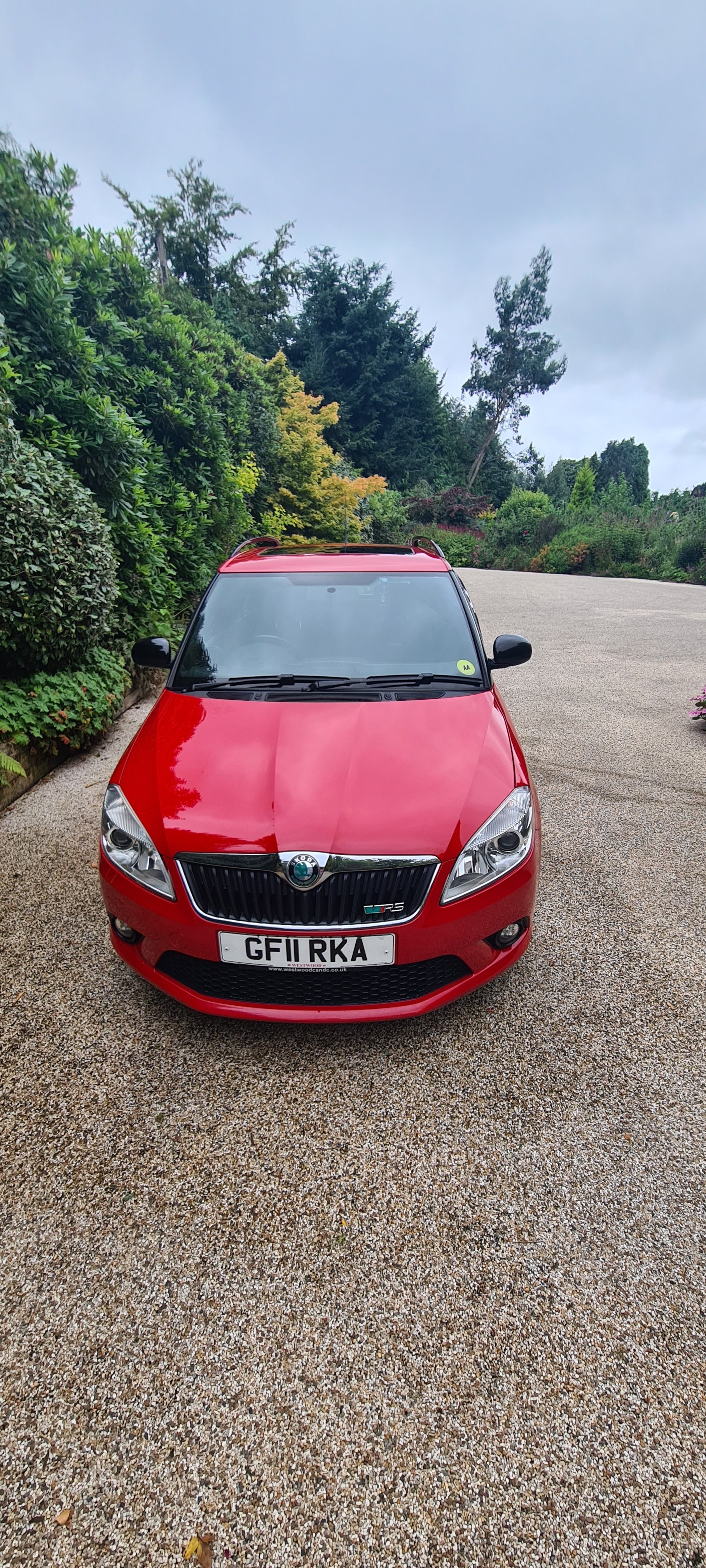

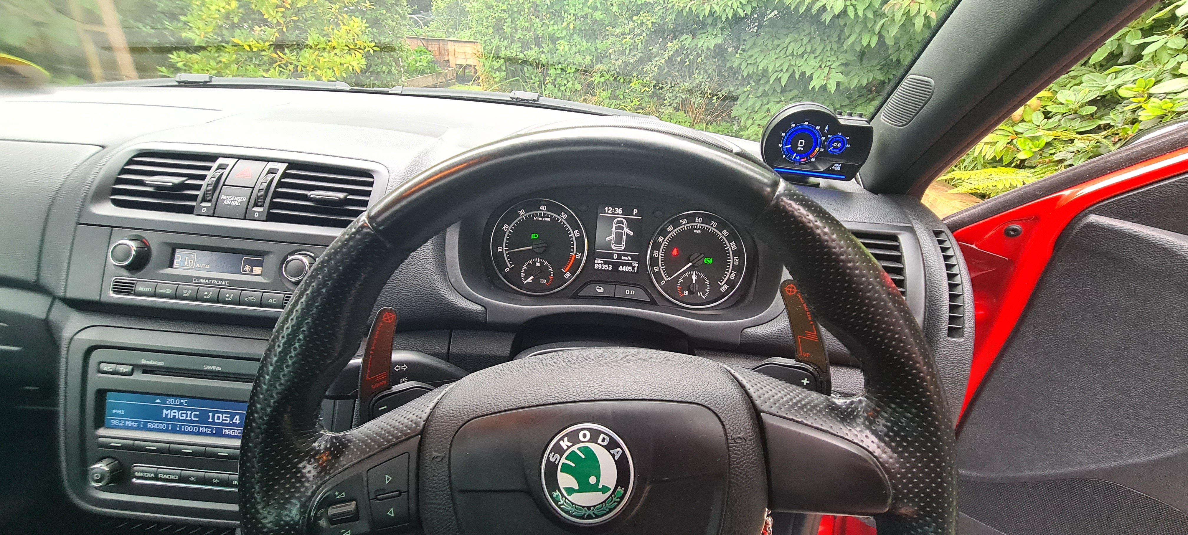

  1. SOLD SOLD SOLD After 6 years sadly I need to move on my flying tomato.will miss her as it does everything very quickly. I'm needing a bigger estate 89.000 miles. Replacement eng with 2nd owner at 40.000 miles approx. I've replaced turbo shortly after purchase as skoda put old one back on ,also has had water pump unit replaced rear wiper and new handle and locking mech on tailgate .Altinater last year. Upgraded EBC grooved and dimpled discs all round and Mintex pads. And Replacement front wishbones.Full service history.oil service this Friday. 4 new tyres for last mot as the all season tyres had started splitting. Mot till May 2025 . Its well looked after She also has climate control and a sunroof. Low emissions zone friendly Nr Dorking Surrey £3650 price reduction to match price on ebay advert
