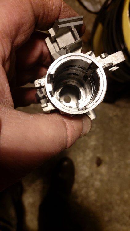

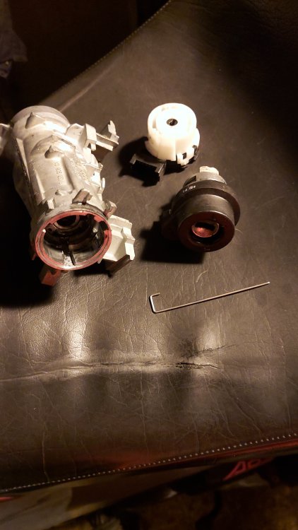

Issue with ignition switch jammed/wont turn can't start car
No special tools needed, couple of good videos on YouTube worth looking at. I had to replace the barrel but used the original switch. Good luck with it

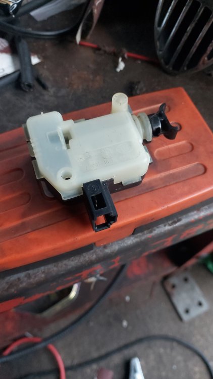

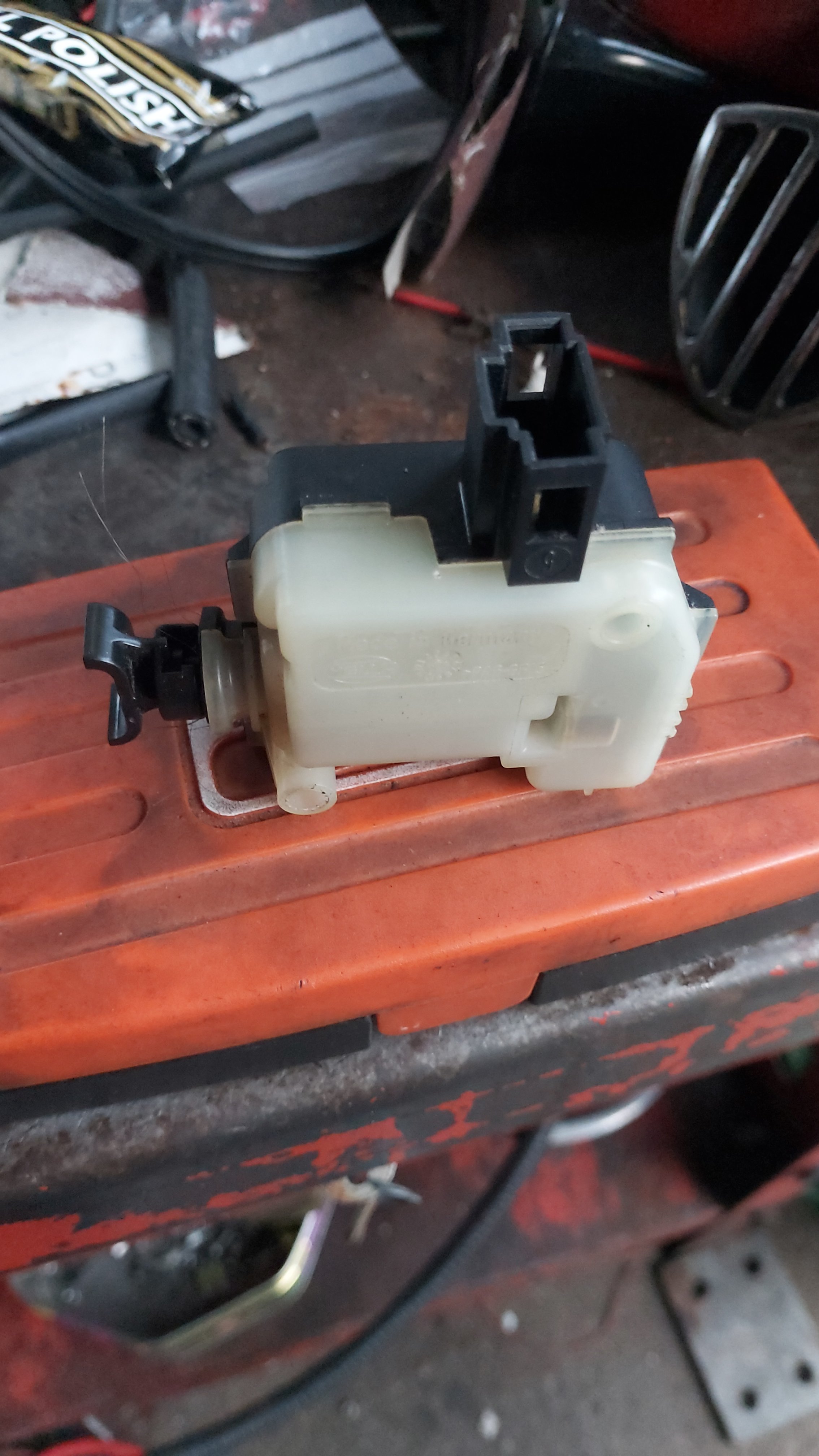

Tailgate central locking
All done and working problem was indeed the electric motor that opens the tailgate latch. Got a Chinese jobby of ebay £11.36 delivered so not so bad. Cheers Gareth

Yes indeed does not unlock, I finally found my multimeter this morning and can confirm power is getting to the unit. So I guess it's gotta be the unit itself 🙄 hey ho. Sadly my local skoda breaker doesn't have one. So to get me out of trouble a new one off ebay (Chinese I'm sure) has been ordered only just over £11 delivered so even if I'm wrong not the end of the world. Sadly going to have to move the car on as I live in the area where the new London ULEZ Zone will probably be coming to. 🤪
Sorry guys sadly another issue with the Octavia. The tailgate does not open with central locking, all other doors working fine it's just the tailgate. I've removed the little motor on the tailgate latch not sure exactly how to test it but tried connecting power to it from a spare battery and no response at all? Shouldn't i be able to hear some sort of noise or maybe see the plunger move? Am not to sure if connecting power would make anything happen? But it would seem reasonable? Thanks Gareth.

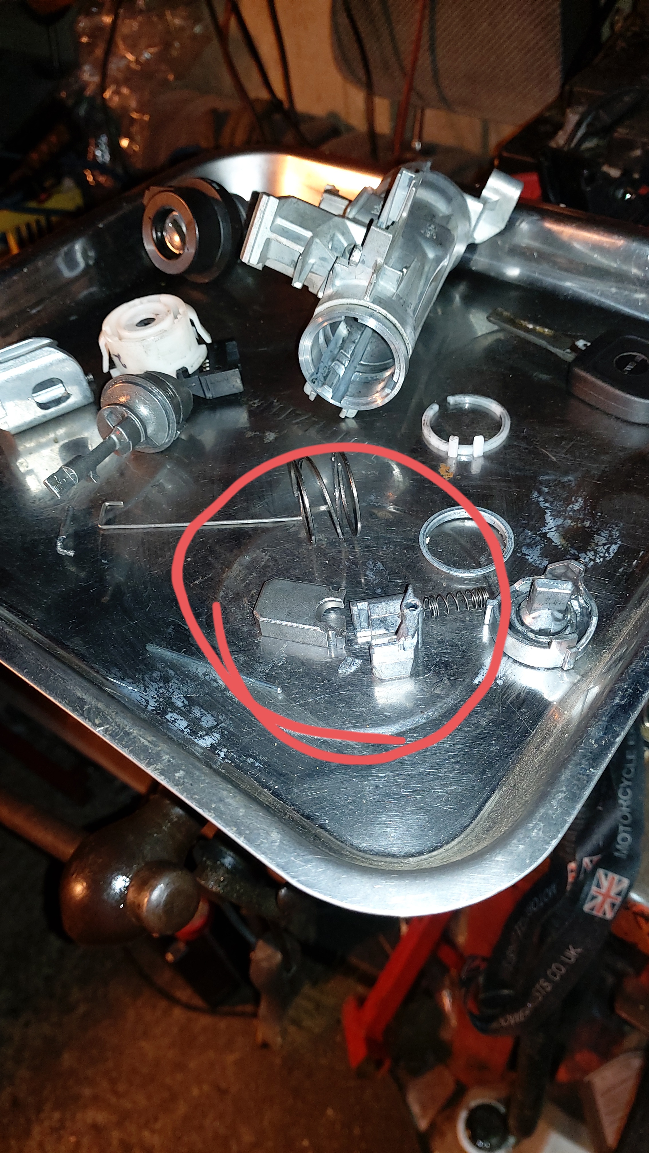

Bought a second hand genuine unit but used the top and key of mine, issue was broken bits (steering lock) in metal body, so all back together thanks everybody for all the great input. Sadly will likely have to sell car in the spring due to the lunatic London mayor Khan and his ridiculous ULEZ BS Hey ho.

Not a great day was out for a little spin today mainly just to wake the battery up stopped for a brew got back in car ignition switch seems to have seized/jammed and can't start car ;-( RAC came out couldn't sort it getting it recovered in the morning. Anybody any thoughts/tips? Thanks Gareth. By the way it's a 2006 Octavia 4x4 estate.
