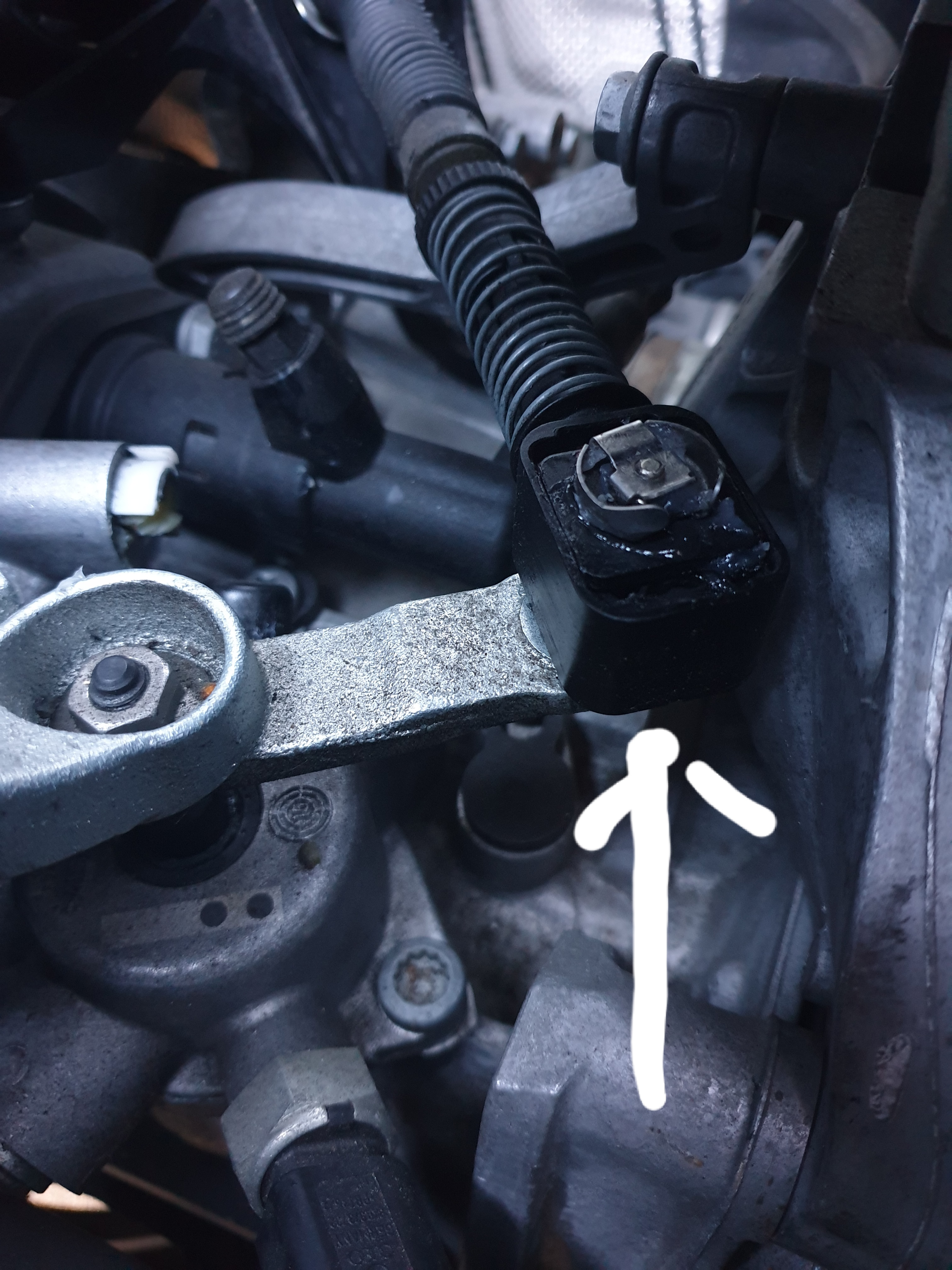

  2. The swivel where the gear cable connects to the gear arm can be cleaned and lubed, It doesn't have to be removed to get it 90% right. This is the other end of that arm, and what was dirty on my car. The silicone spray (with straw attached) helped along with liberal cleaning. PTFE grease to finish it off. If that doesn't improve things enough, and you are out of warranty, you can try the likes of Slick 50 gearbox treatment. I didn't need to use it here, but it worked *really* well on my old Passat 1.8T sticky graunchy second. Lasted for years after I added it (I already tried changing the gearbox oil, with little improvement, and tried molyslip - useless. Might be useful to someone.

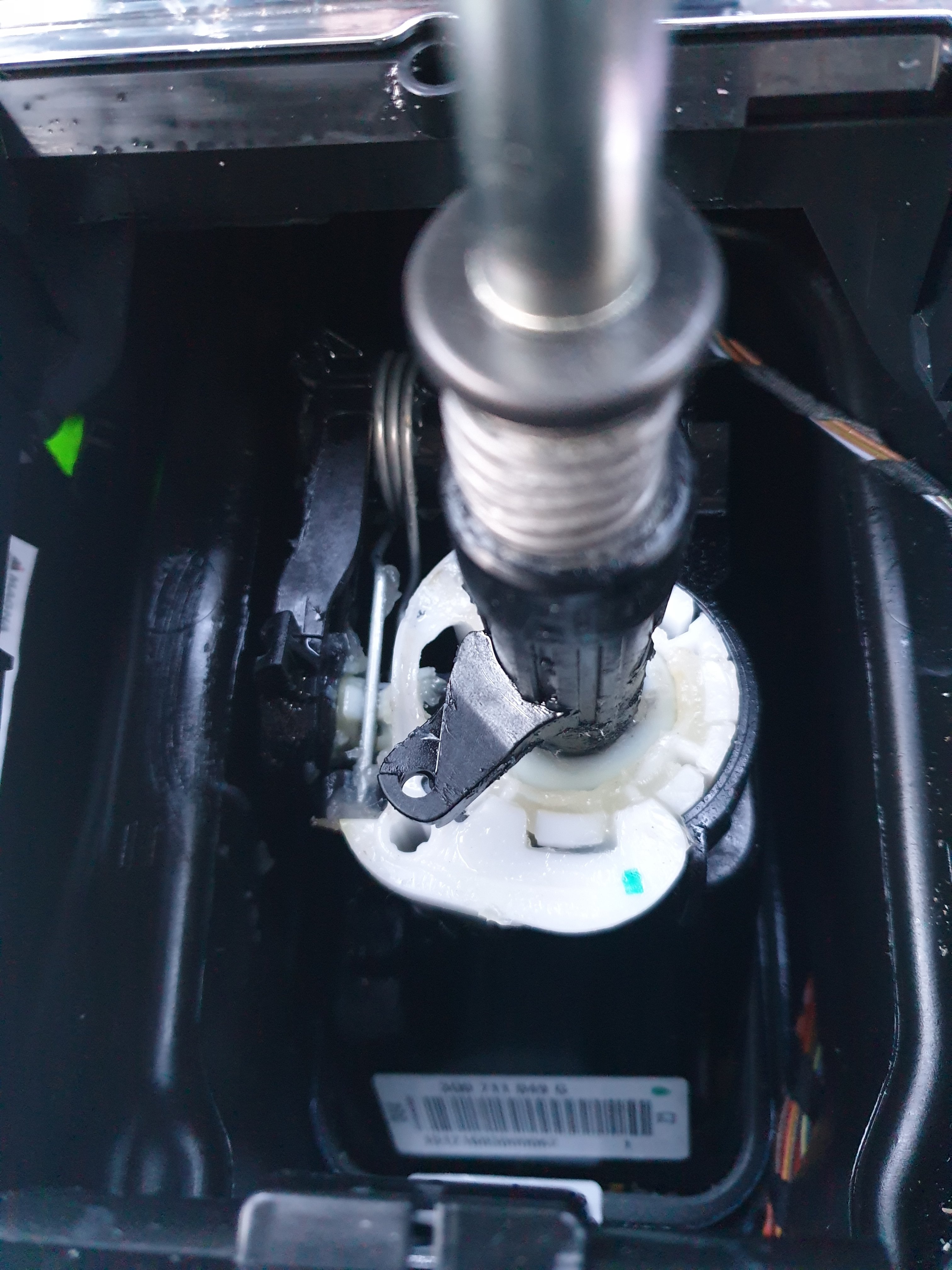

  3. And just to the left of the gear lever, now the eccentric arm and spring are visibly lubed.

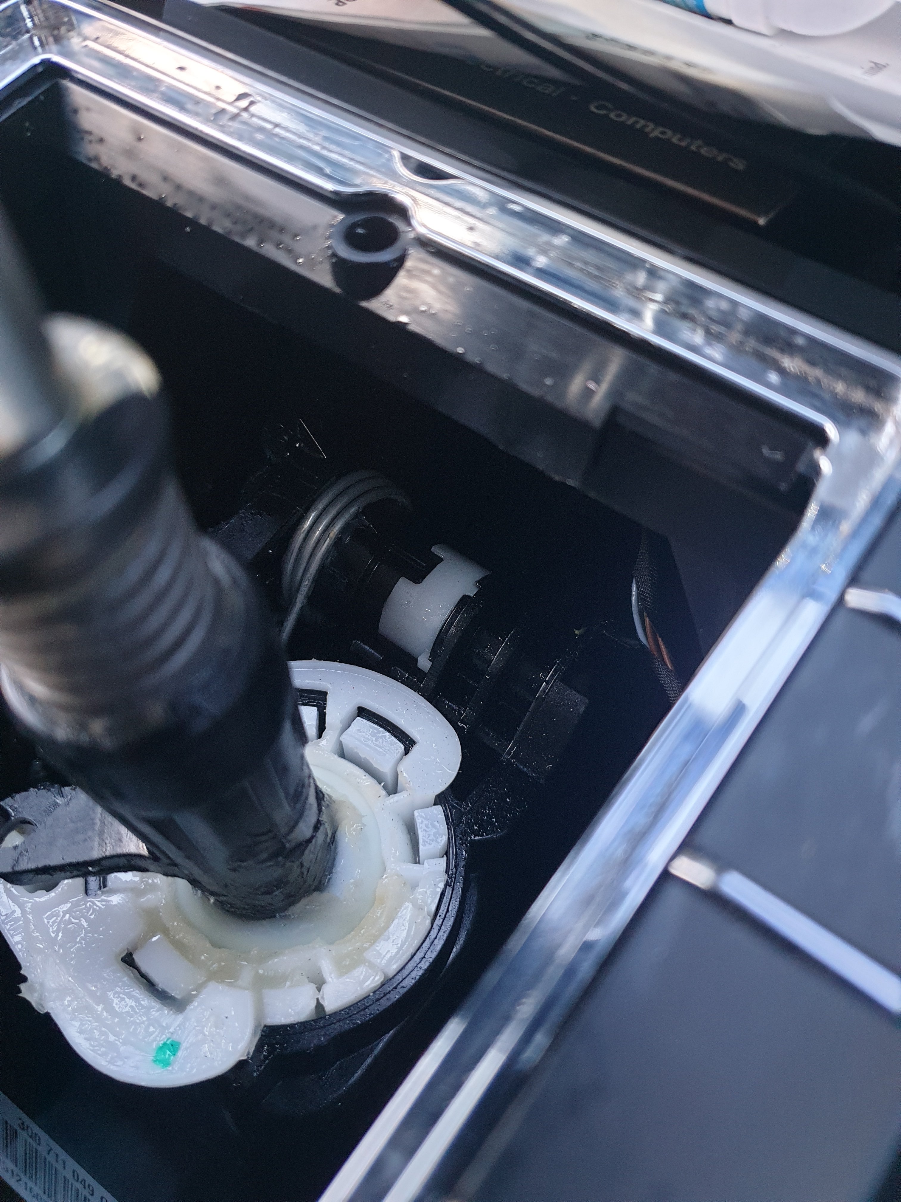

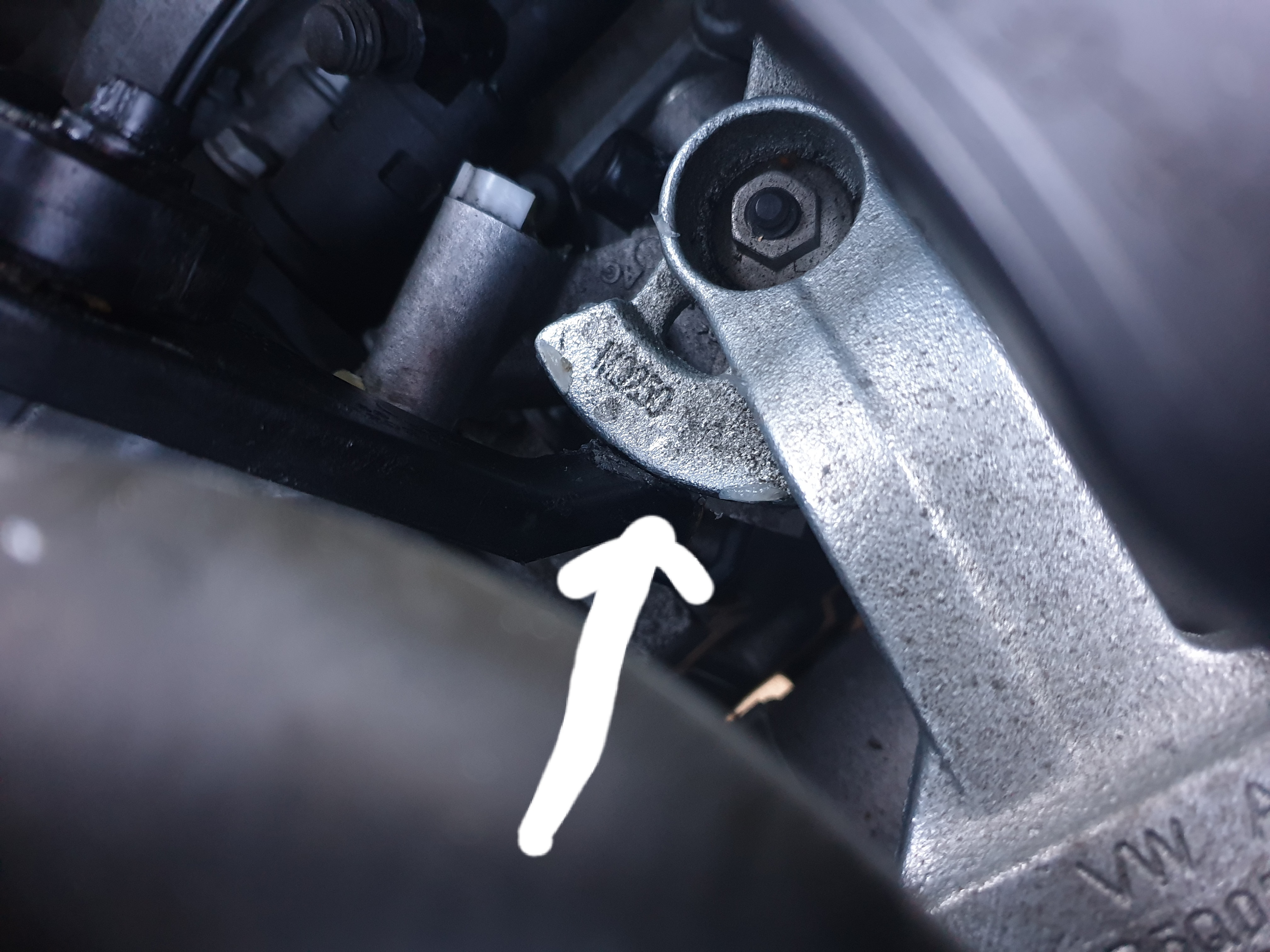

  4. So just left of centre the ball assembly has been lubed. Above this is part of the eccentric mechanism which needs a fair bit of lubing. Hidden behind the gear lever is the end of the eccentric that worth massaging wome grease into, plus the hidden portion of the spring just visible above.

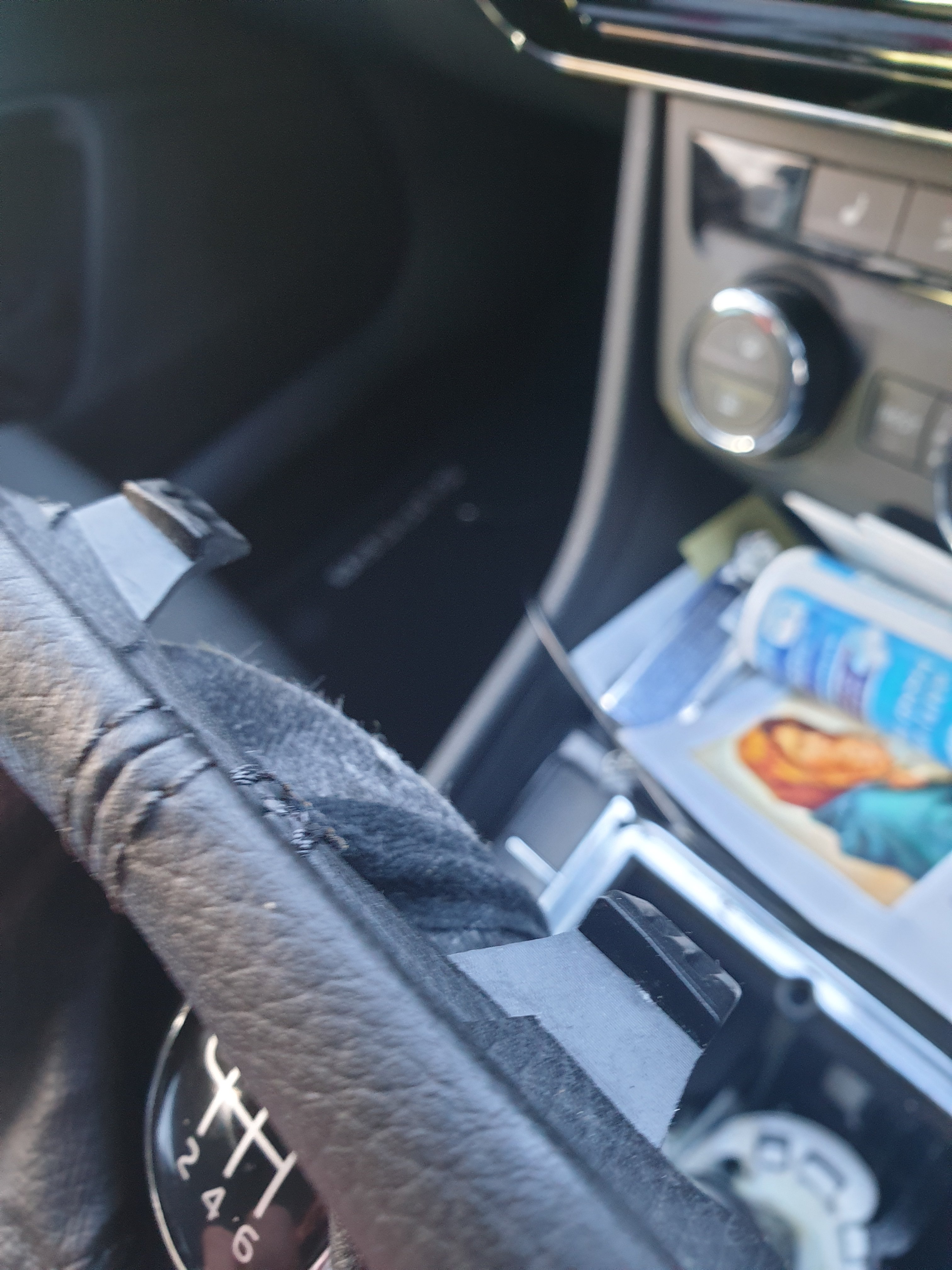

  5. That's the front portion of the gaiter, which I pushed rearward before pulling up from the side
