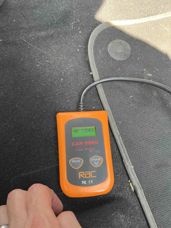

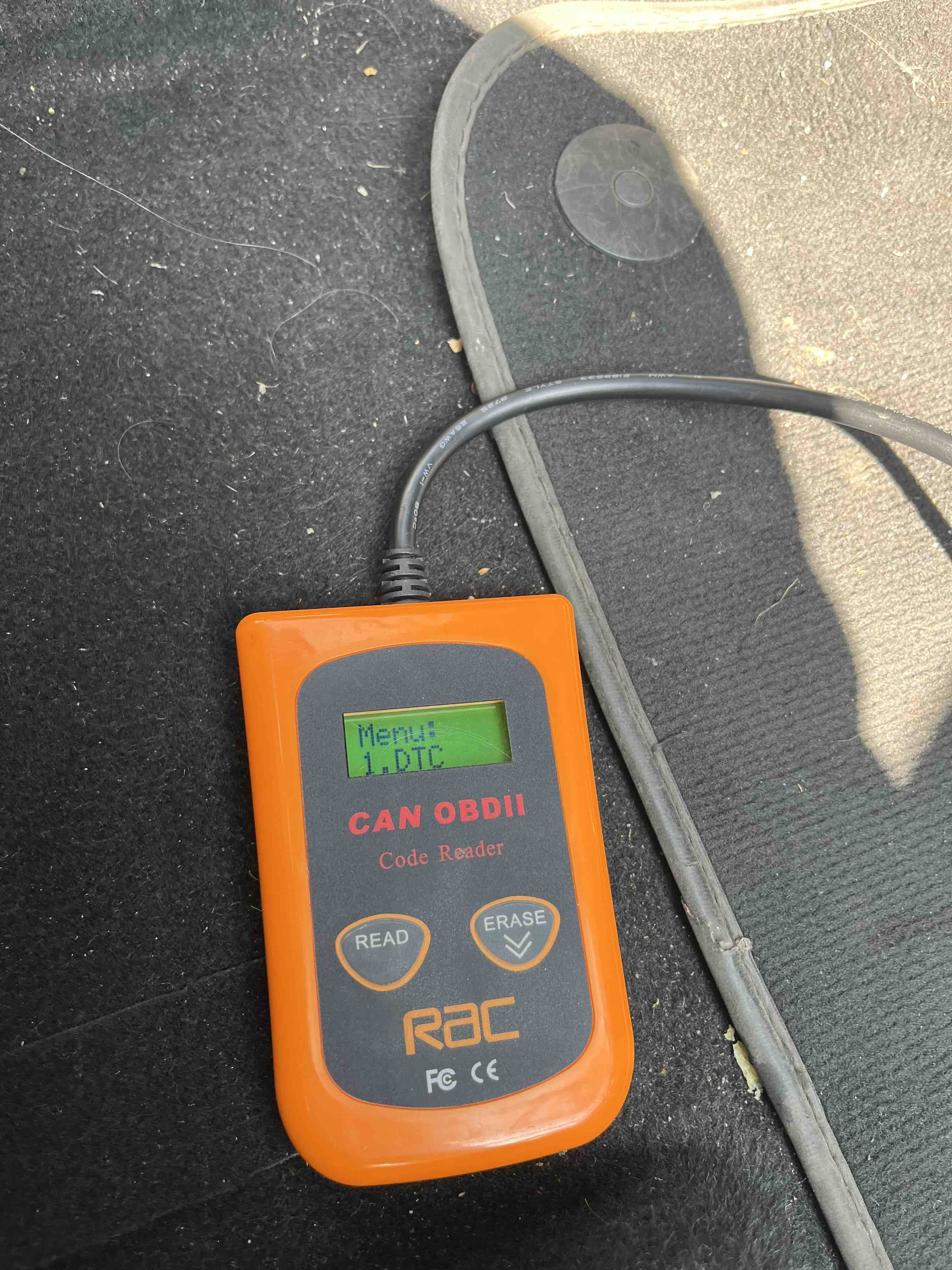

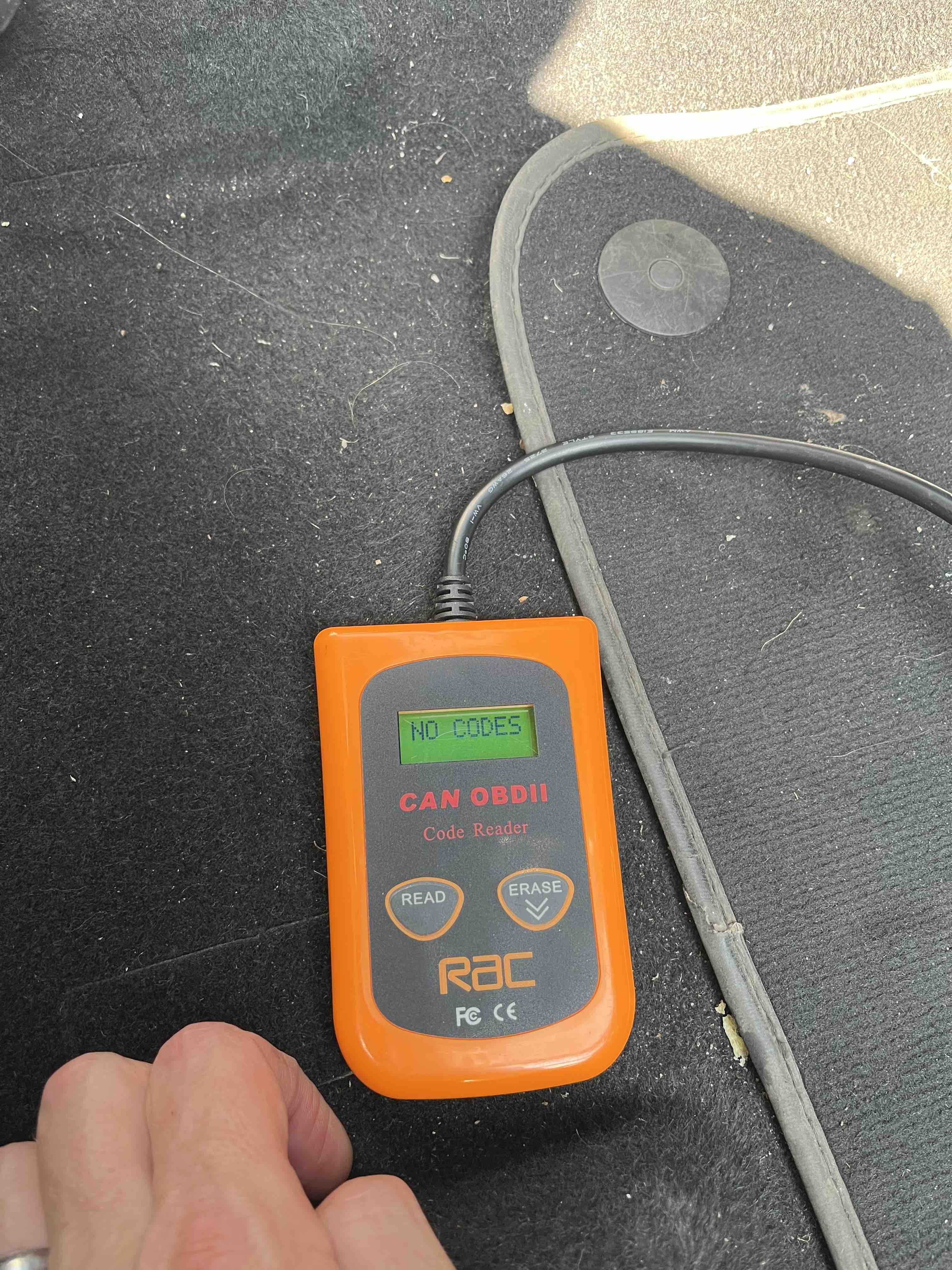

Hello everyone. Firstly thank you to everyone for all the posts, suggestions and info. Apoloigies for the delayed reply. Work got really busy then we had a short break away (by plane). I have been using the car though since getting back and it has now completed a couple of hour long commutes, all well under 50MPH it has to be said but its seems to be absolutely fine now (of course). I am going to give it a longer run on Sunday with motorway speed and 4 passengers so that will be a good test. I was able to borrow an RAC OBD compatible Fault code reader. Interestingly the reader showed NO Codes (See pictures attached). Do the codes have a shelf life? Does it delete codes if not viewed in a certain period? My understanding is codes sit on the EMU until forcibly erased by a user with a tool (such as the one I was using). So if anything happened on the way back from France that the system noted it should be on there... Based on a few of the posts my theory right now is drifting to fuelling. its perhaps no co-incidence that the car is much better since I fuelled it in the UK (admittedly with 95 RON, but good wholesome UK 95 RON, perhaps with no bio etheanol). I am wondering if when I tanked up at the hypermarche using the automatic machine it may have been the 10% bio ethanol stuff. Add that to a long run, on a hot day, with a full load and lousy aerodynamics and high speeds and I was probably asking my poor 100,000 mile plus Octavia to go above and beyond the call of duty. I am going to see how we run this weekend on a shortish trip to the south coast with two passengers and a few bags and then make sure the next couple of tanks (especially ahead of the next camping trip) are 98RON and see how that works out. Oh for the record at the last service at Underwood's on 25th of April 2025 they actually did replace the spark plugs. So I think if we get this again hopefully we'll get an error code or two but for the moment I'm thinking maybe just misfiring as a result of the convergence of all those variables (a perfect storm perhaps). Will post back here if I get the fault again or the EPC light comes on again. Not ruling out a coil pack but based on one of the posts above if it was that then theoretically we ought to see some codes...
