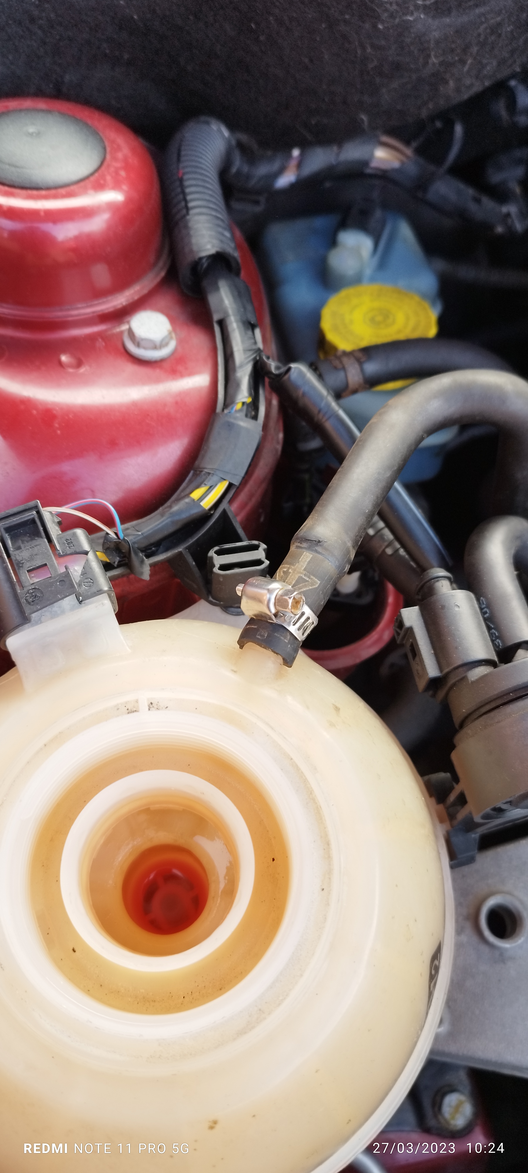

  10. No coolant is flowing through this pipe,which it should I think
