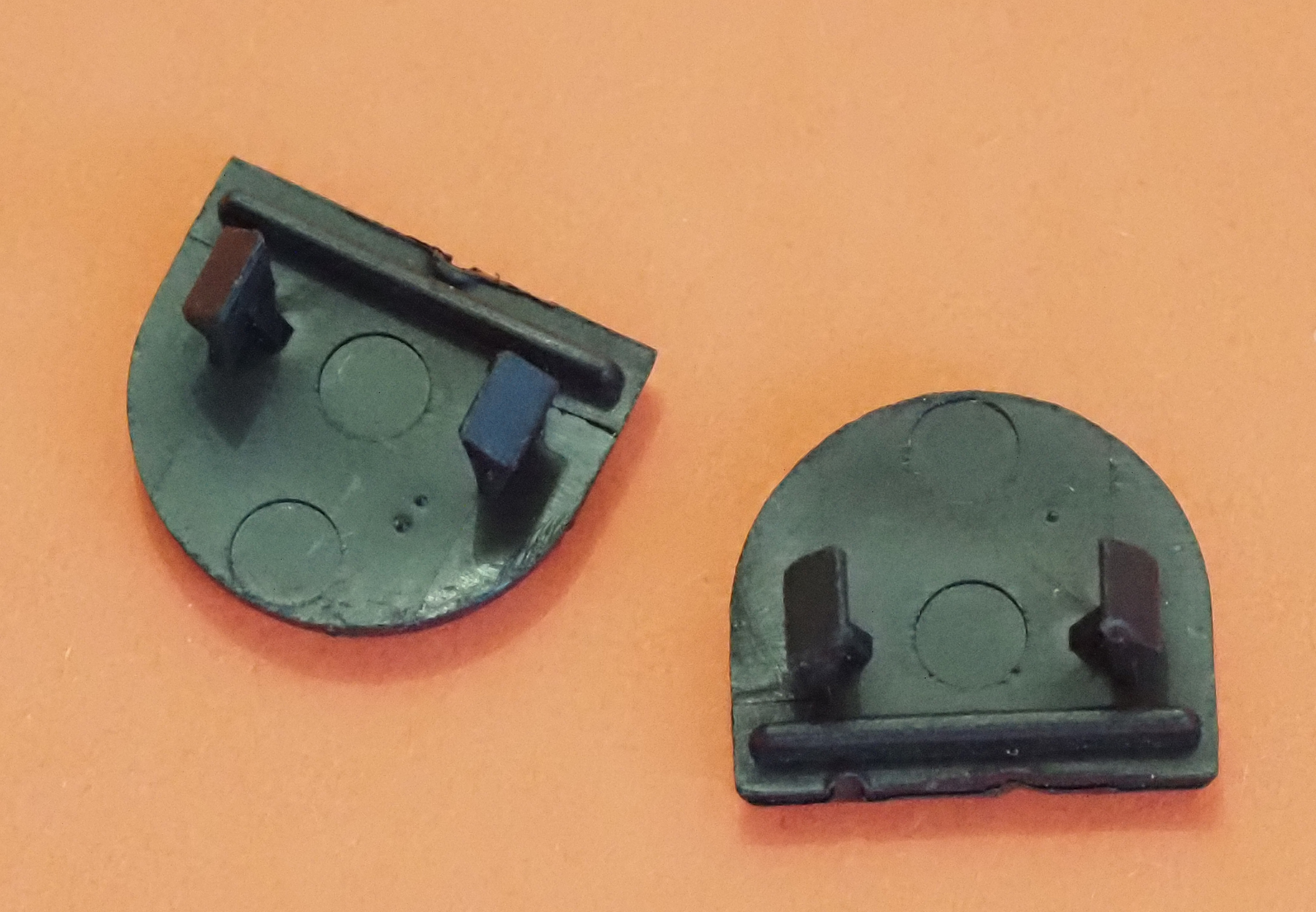

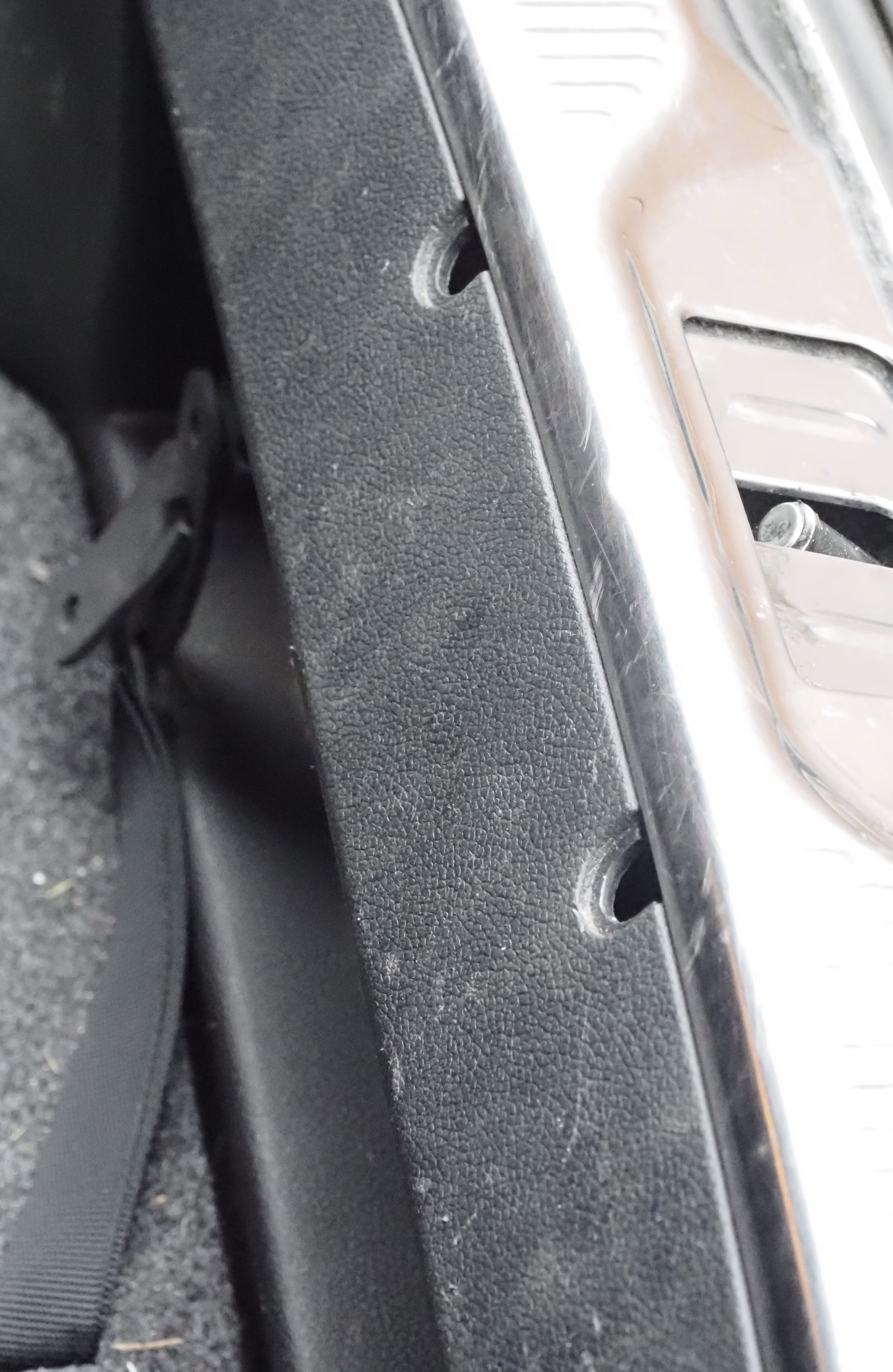

  1. Thanks to everybody for their comments. For once I can make some comments that I haven't seen elsewhere. Firstly do not attempt to remove the trim. You are likely to do some irreversible damage. It is actually quite simple to adjust the striker plate. The only tool needed is a Torx allen style key size T50. A T50 screwdriver might work. In my case it would have been difficult to apply sufficient torque to release the tension. Access to the screws is obtained by unclipping two plastic cover plates. The attached photos show the clips and where they fit. Peter

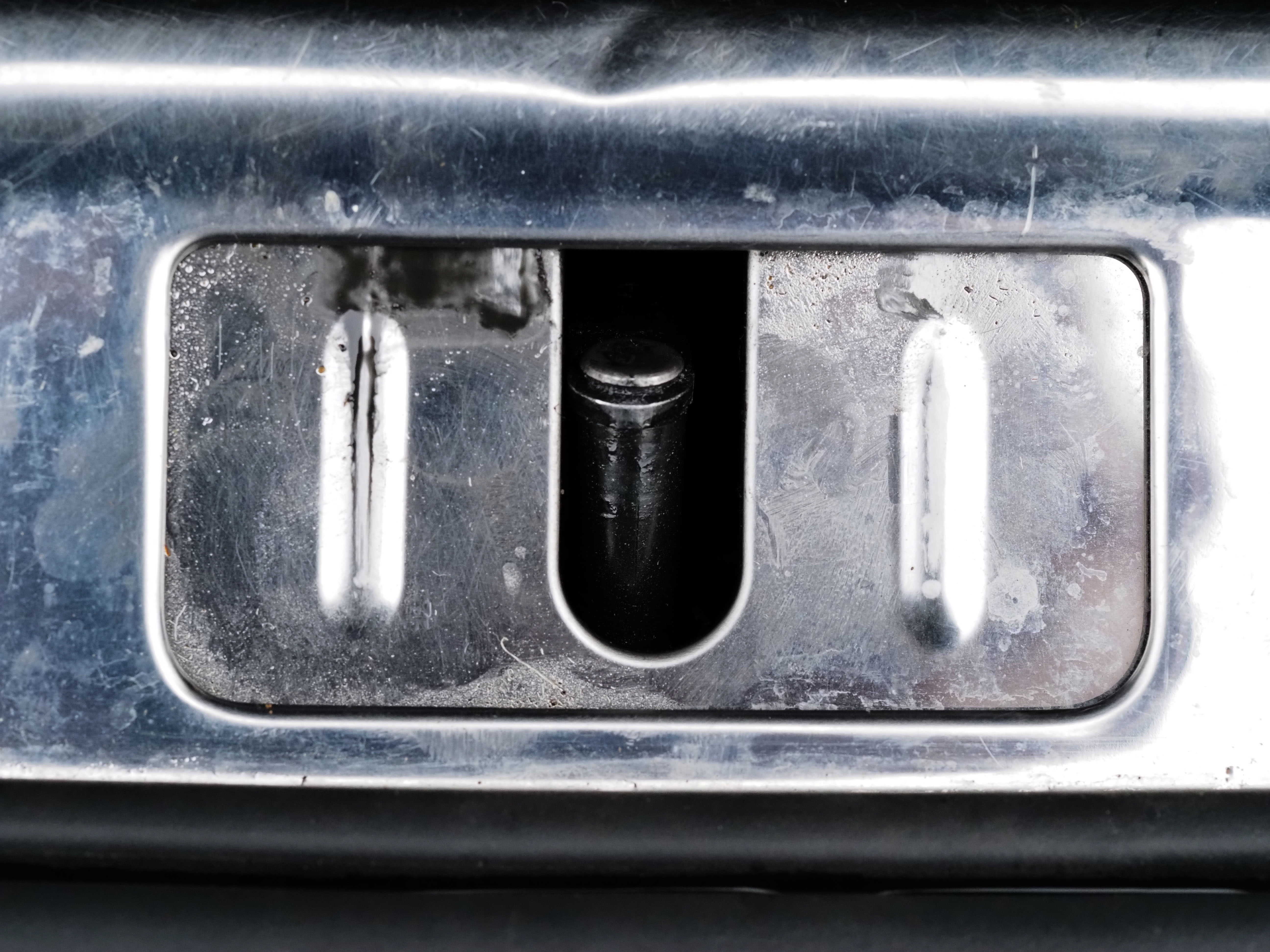

  3. Hi I'm having a problem with the tailgate boot lock. Following a botched attempt by a professional to resolve the issue I've decided to see if I can fix it myself. I've obtained a replacement part which has the same part number as the original failed lock. I now understand how to change the lock. However as part of the earlier attempt, the retracting rod that pulls the tailgate down has been moved about 5 mm to the left. (picture attached). I am unable to see any obvious mechanism to relocate it to the centre where it was initially. Any help with this would be gratefully received. Many thanks Peter
