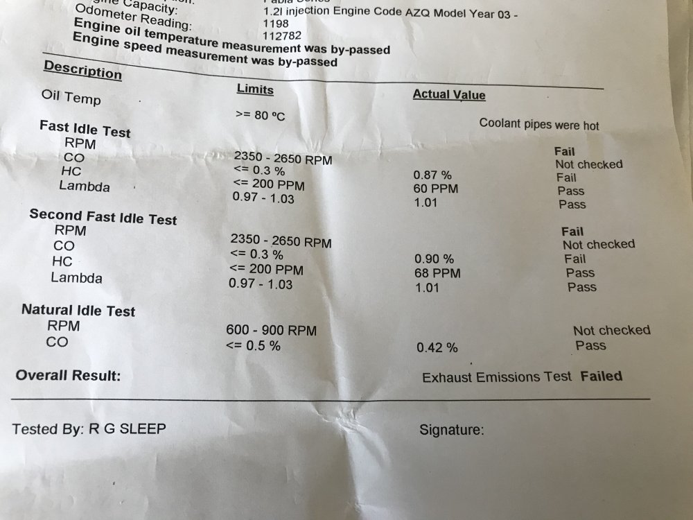

Exhaust carbon monoxide content after 2nd fast idle exceeds manufacturer's specified limits
Do you think a bottle of Cataclean might help with the emissions?
So is it likely the valve and cat are toast?
He did mention checking spark plugs, so hopefully it`s that.
Thanks Pete. It is a 2010 Car.
Failed MOT on above. Symptoms are EML on, recent excessive oil consumption, occasional smell of exhaust, and misfire at low revs. Garage did say there was a minor exhaust leak on the flexi, but said that would not be the cause. He plugged in laptop, and it came back with CAT problem. He said he was not convinced, although it could be, or a valve problem. Taking it back next week, for them to have a look. He said a new cat would solve the problem for now, but the problem would come back later on. Any advice would be appreciated.
