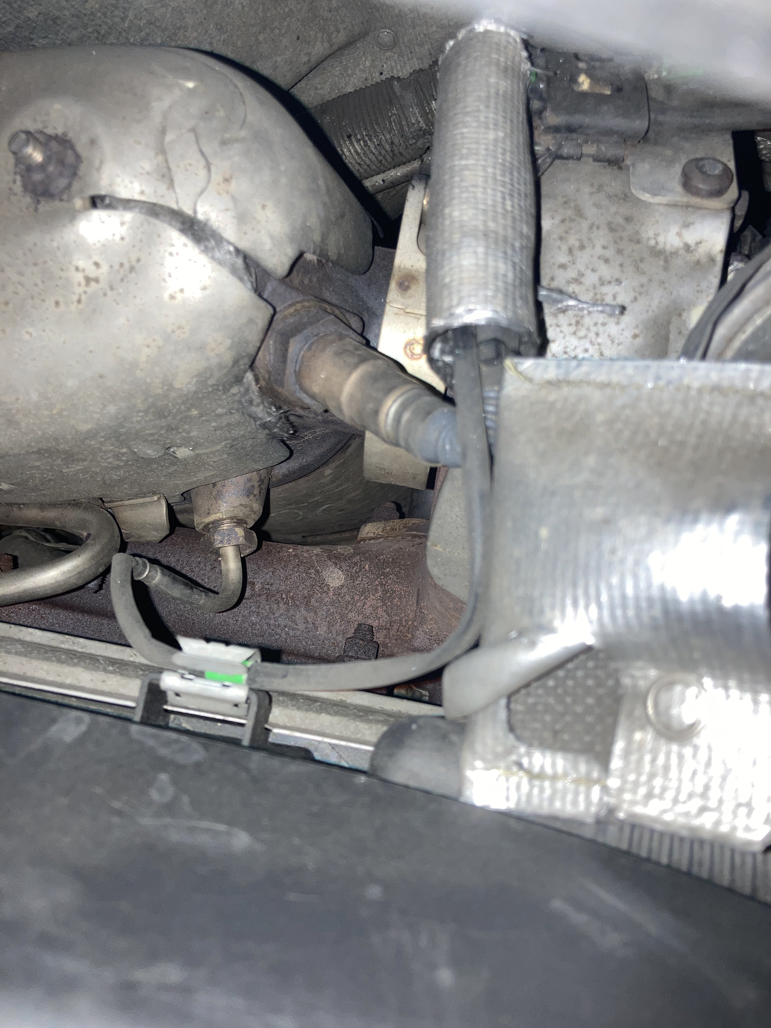

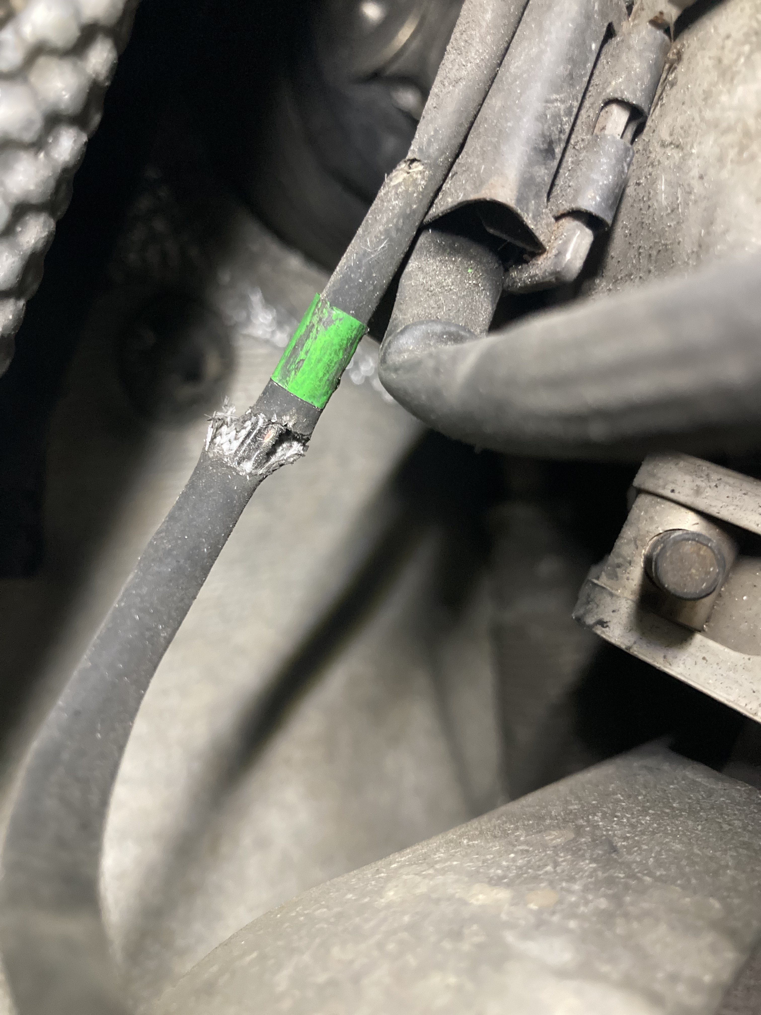

  13. Thanks guys for your suggestions. I have temporarily carried out a repair using aluminium tape which is both corrosion and heat proof. Made thoroughly sure that it wouldn’t come in contact with the exposed copper of the sensors. Finally chose not to put back in the clip that caused the chafing. The constant trying to regenerate has stopped. Have rerun a scan and no codes coming up. I still have a suspicion that the thermostat is not working correctly as it struggles to get to working temp (90 degrees) and will drop back from 90 when idling. Is there a simple way of checking if the thermostat is working correctly either with or without using VCDS??
  14. Thanks. Are you suggesting just repairing the outer sleeping with a heat resistant tape. I’m assuming heat resistant rather than electrical insulation tape because of its location.
