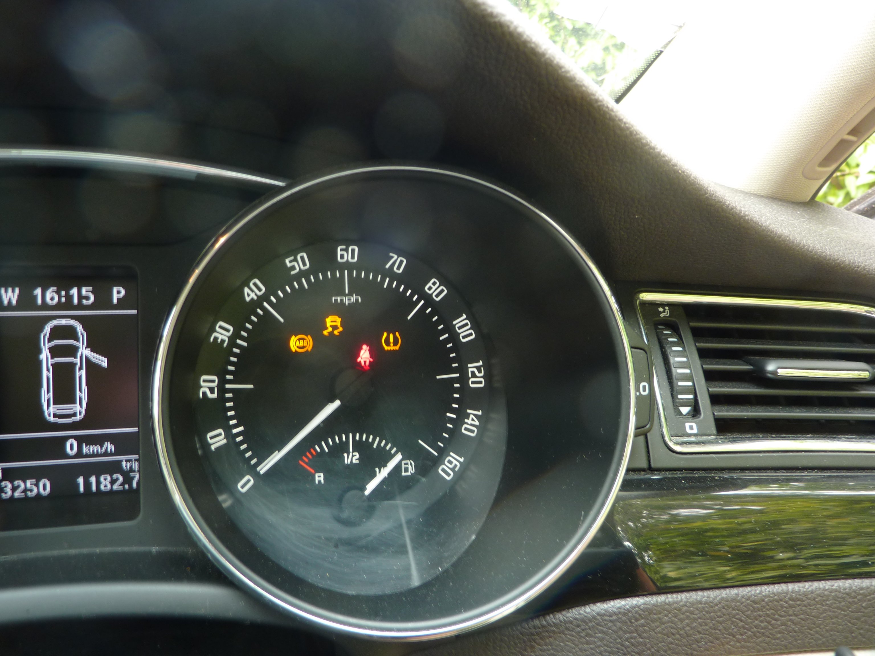

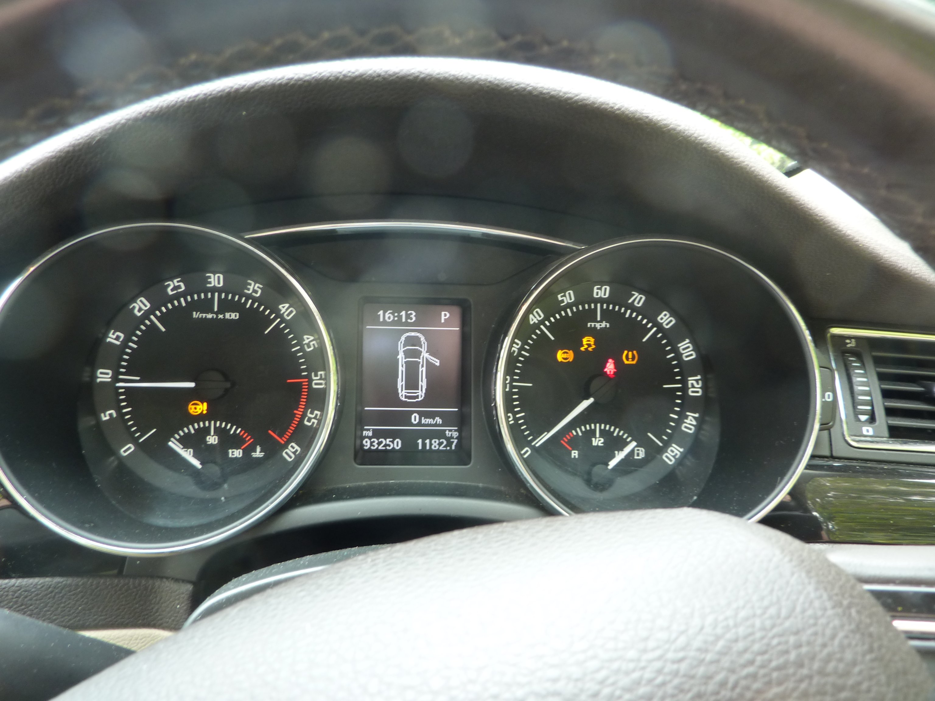

  6. Just got a text from Volksmaster to say they have sourced the ABS Skoda sensor, including fitting and recheck would be £211.44 inc VAT
  7. The wiring was checked and passed, that was the first thing after diagnostic check was done, but on checking the bearing found it to be worn,(which they showed to me) they put new bearing and new sensor on, but ended up putting the old sensor back on which seemed to solve the issue, but as I was ready to go the lights were back on, they said they think it needed a genuine Skoda sensor rather than the off the shelf one they had purchased, they took an hours labour and the cost of the sensor off the bill.
  8. Pick the problem apart, isn't easy with little or no knowledge of engines or electrics,It's mystery why I can but driving alone with no dash lights on ,then on for a few miles then off.

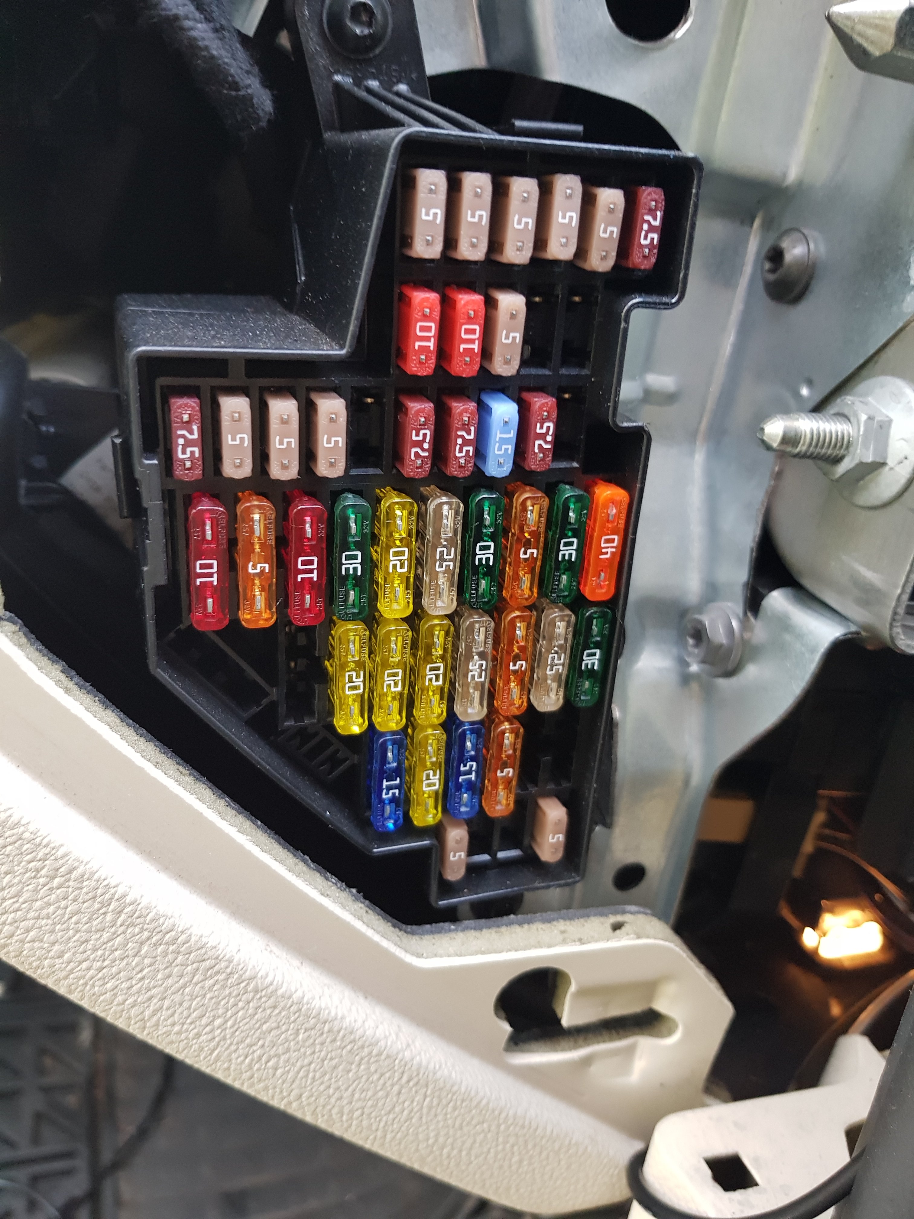

  11. My rear wiper has stopped working Any idea where and which fuse is for the rear wiper
  12. Thanks for that 4th row down and 5th from the right wasn't it, however the 5th row down and the 4th from the right sorted the issue, by the way the rear luggage 12v plug worked throughout (weird) that might be on the fuse you suggested . So leading on from that issue , a have a dashcam which I would like to switch off with the ignition, does anyone have a simple solution?
