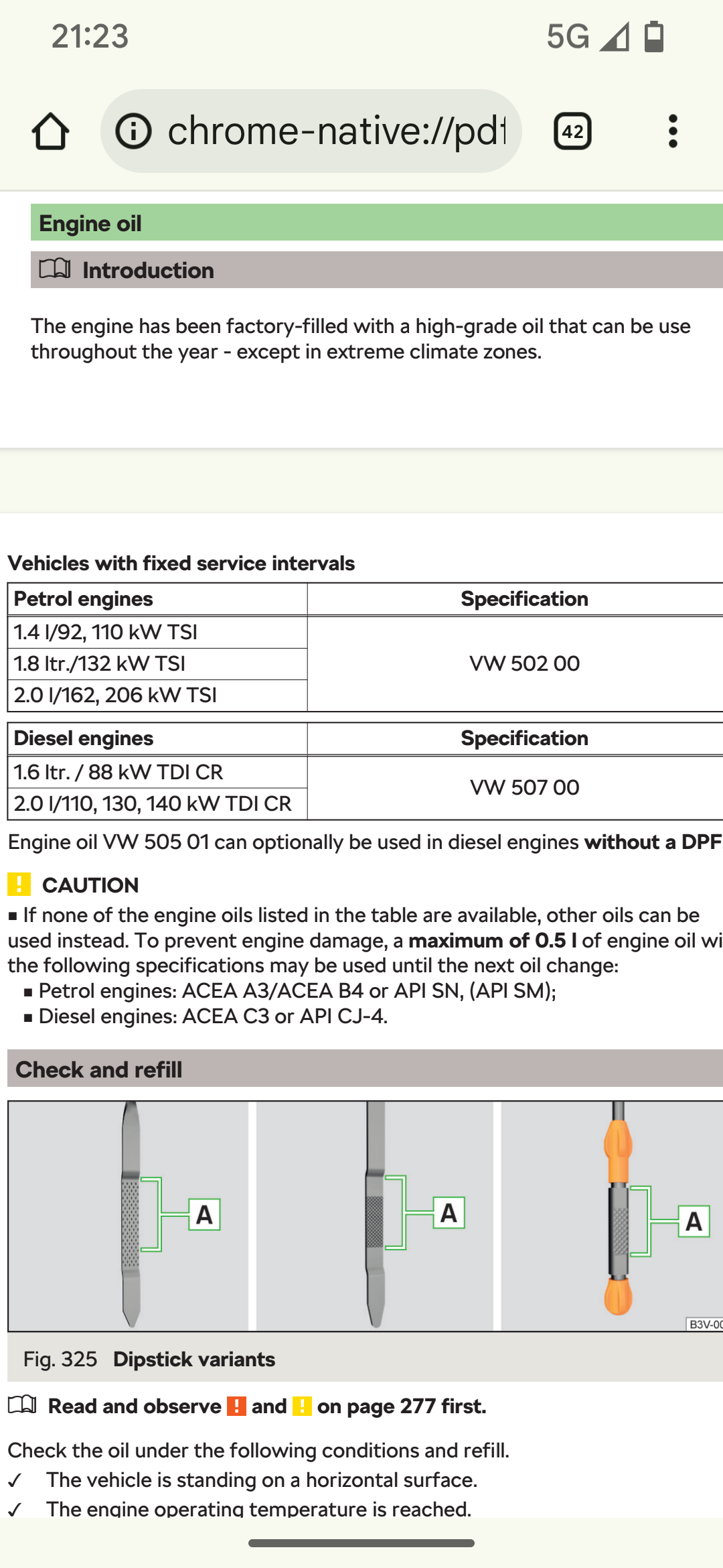

  6. Where do you see that. The manual I have is 502
  7. No mention of it anywhere
  8. https://www.skoda.co.uk/apps/manuals/Detail?vin=TMBME7NP1J7516491&manualLang=en here is a link to the manual. I got it from the Skoda app
  9. According to the manual in the car Yep. It's crazy how difficult it is to find this info. Especially when there is supposed to be a sticker on the car that tells you what should be used

  11. I will speak to someone tomorrow about it, try and get a definitive answer. I will speak to someone tomorrow about it, try and get a definitive answer. I have no clue of build date, as I didn't buy it new.
  12. As mentioned earlier in the thread it's a 67 plate. Engine is cjxa, no idea what gpf is! Why does the manual state vw502? I plan on doing oil changes every 5000 miles
  13. After checking my owners manual, the car requires vw502 oil. Which is Castrol edge 5w40. So going round in circles here. I can't believe how difficult it is to get this info. Especially in this day and age. Will cancel my oil order until I can speak to someone tomorrow about it
