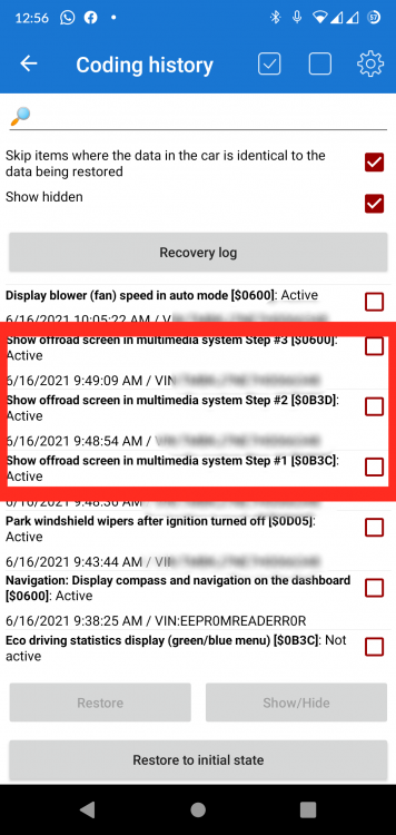

  4. Thanks very much for the tips. Thankfully I have managed to recover the situation. Not sure if that's a good lesson or a bad lesson about fiddling with coding. Losing navigation was never going to be the end of the world as we know it. For anyone else that stops by, the problem was with the "Show offroad screen" app in the Car Scanner Pro app. I had enabled it. It seemed to work apart from having the tilt always zero (I assume due to not having the sensor. The navigation was also functional at this point. I then reverted it by setting it to disabled. That seems to be when the navigation failed. In trying to unpick things, I went back to the original time when I set it in the coding history (shown in the attachment), selected the 3 items and restored to the original state. The navigation and traffic features were immediately cured. I'm hoping that it stays that way as curiously, the failure before happened mid drive. As the fine folks who replied implied, it was nothing to do with the update to the map data. Phew!

  6. 2016 Octavia Mk3 Estate SE L Sad news. I tried to upgrade my maps to the latest version, something I've done a few times before. It seemed to work. Started navigating a trip yesterday morning. After a stop start, there is no longer any access to the Satnav or Traffic menus. When I press the nav button, I get a popup: "Navigation: Function not supported.". When I press the button for Traffic, nothing happends. Also, no compass on the driver display. Same symptoms when I reverted to a backup of the map data. This happens even when I don't have the map SD card inserted. I have to admit that I was poking around with Car Scanner Pro but only adding in things like wiper blade park etc. Help needed!
