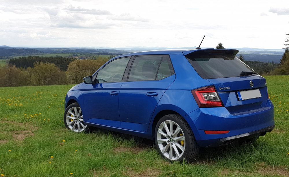

  4. I think, that it is worth it to get F/L rear bumper. It looks so good on the car! At least in my opinion. You can change rear bumber without any problems. The attachement is absolutely the same. It is just about the different shape of the bumper itself. Sides I have no idea. Did not try them. I dont like them so much. Also thinking about front Ingo Noak splitter. Check it out. It is something different and very nice! So far, I have just the back. Facelift rear lights, bumper, difuzor. Front is still stock. Like the whole car. Vega wheels are very nice! Also tried them. But I still prefer a little bit my silver Savio rims. Planning on MC flat bottom steering, like you, also Eibachs and slam it a little bit to the ground. And the Ingo Noak splitter. Little bit tinted windows and I would be happy. Nothing crazy.

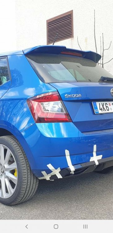

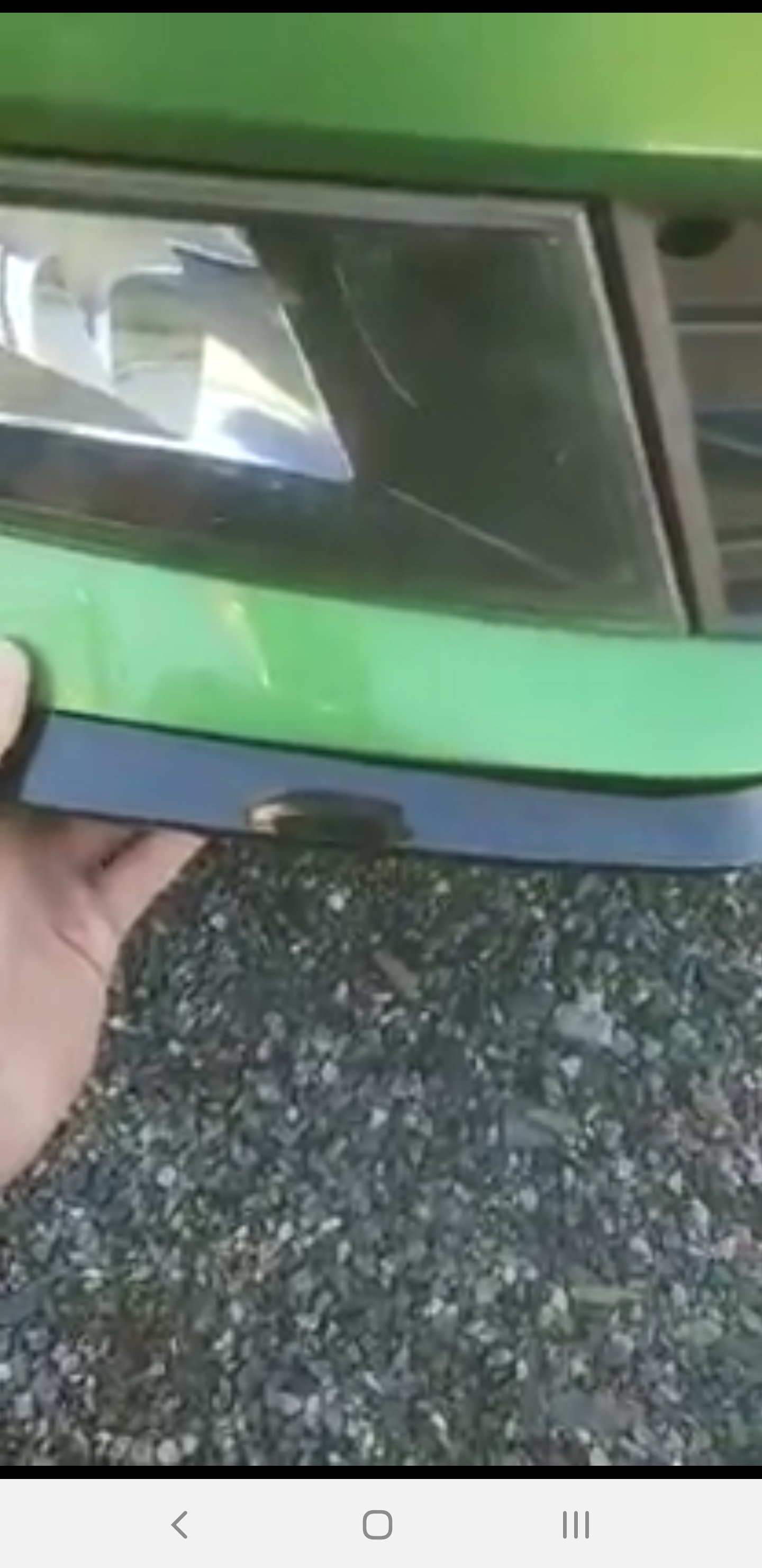

  5. Difuzor when I was trying to fit it. You can see in the corner, that it did not fit around the "line" on the bumber. And the difuzor couldnt be lower. Front lip, not my screen. You can see also in the corner. On the right side of the picture. There is about 1cm hole. Between bumper And the lip.
  6. I've had everything. Front left lip was okay-ish. The right one didnt fit at all. There was a huge gap. No way it could be fitted. Then I bough rear spoiler, that was just fine, because they are the same Facelift/prefacelift. Then I bought rear difuzor. But shape of the facelift rear bumper is absolutely diferent. So I've had to change the whole bumper for facelift one in order to fit facelift difuzor. But talking about Hatchback Fabia.
  7. Hi, unfortunately the front lips of FL Fabia cannot be fitted on pre-facelift. Same with difuzor. I mean.. On hatchback, the difuzor cannot be fitted. The shape of the rear bumber is diffferent FL/Pre-FL. Combi has the same rear bumber, that can be fitted just fine. Spoiler, they are the same, thats fine. Sides also are the same.
