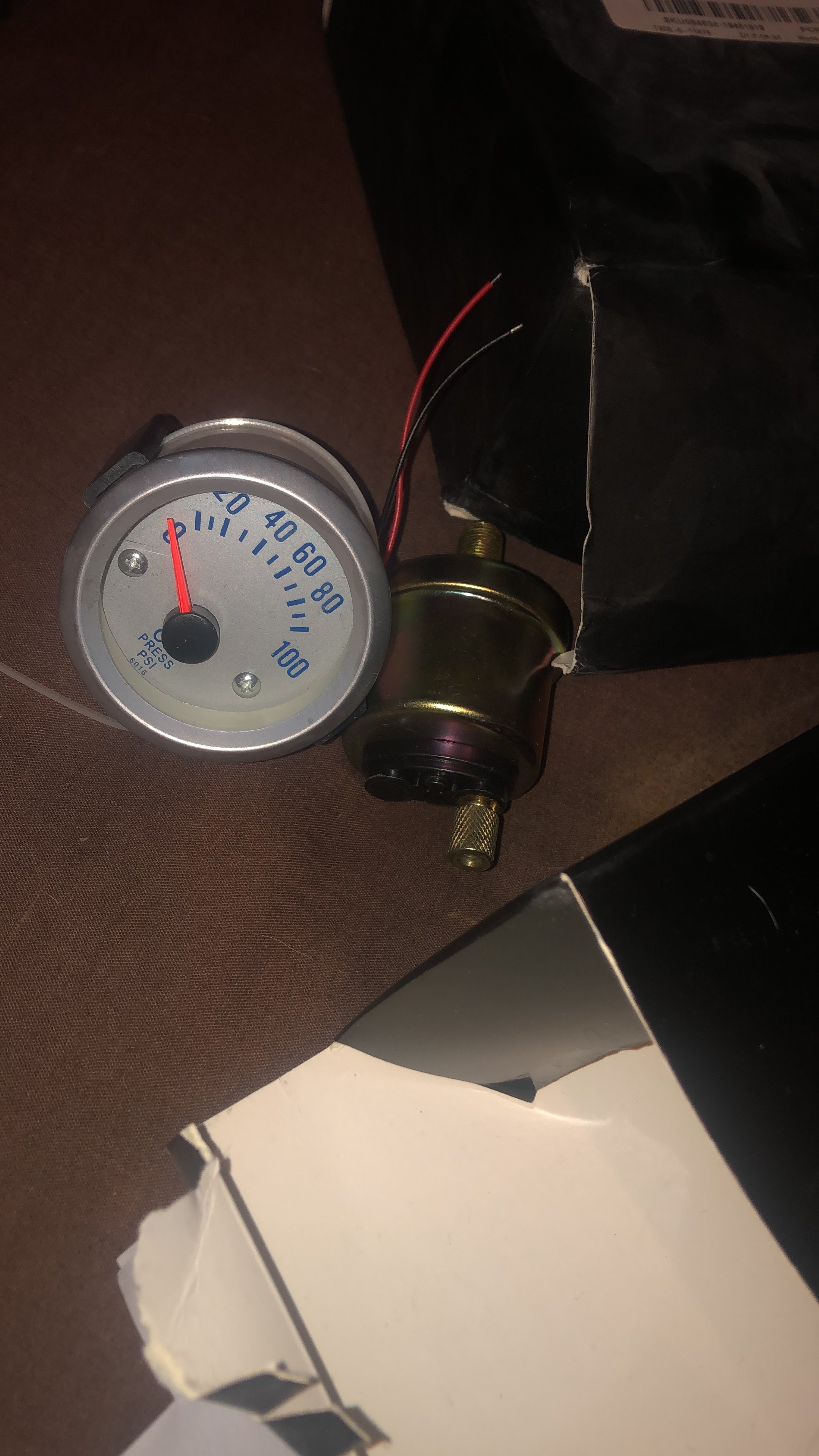

  1. Which 1/8 NPT capillary fitting ? this is my gauge and sensor fitting

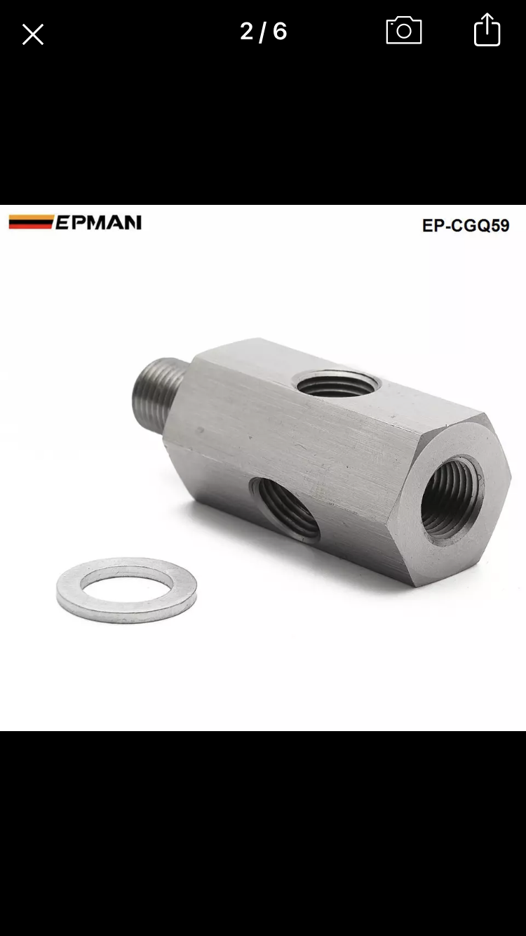

  4. Is this the one? They don’t seem to have T pieces tobe exact. states “Epman Oil Pressure Sensor Gauge Meter Two Fitting 1/8" NPT female & M10 10X1.0 Male EP-CGQ59”

  7. No leakage just oil pressure light came on after long haul, then whenever it was revved above 2k
  8. That is exactly what I am looking for right now, thanks dude
  9. I am looking for the oil filter sizes and the extra. I know my car is 3/4-16 UNF. The extra cluster sensor is 1/8 NPT maybe?
  10. I see M10,M20,3/4,an08,an10 fittings respectively
  11. Adding an oil pressure gauge to my car due to a recent switch failure, just wondering if anyone can help on the size oil adapters I need? The engine is a 1.4 BKY petrol
