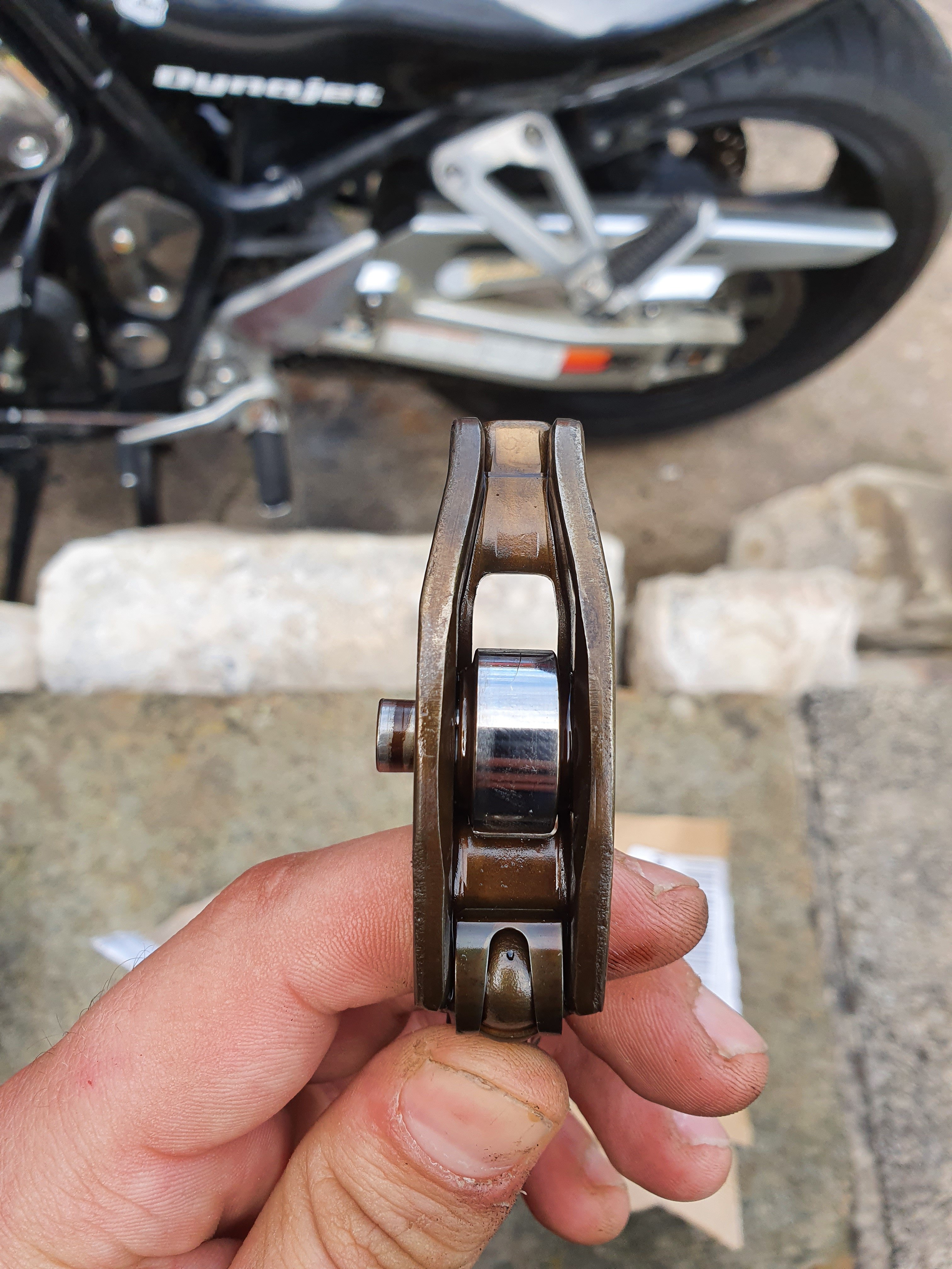

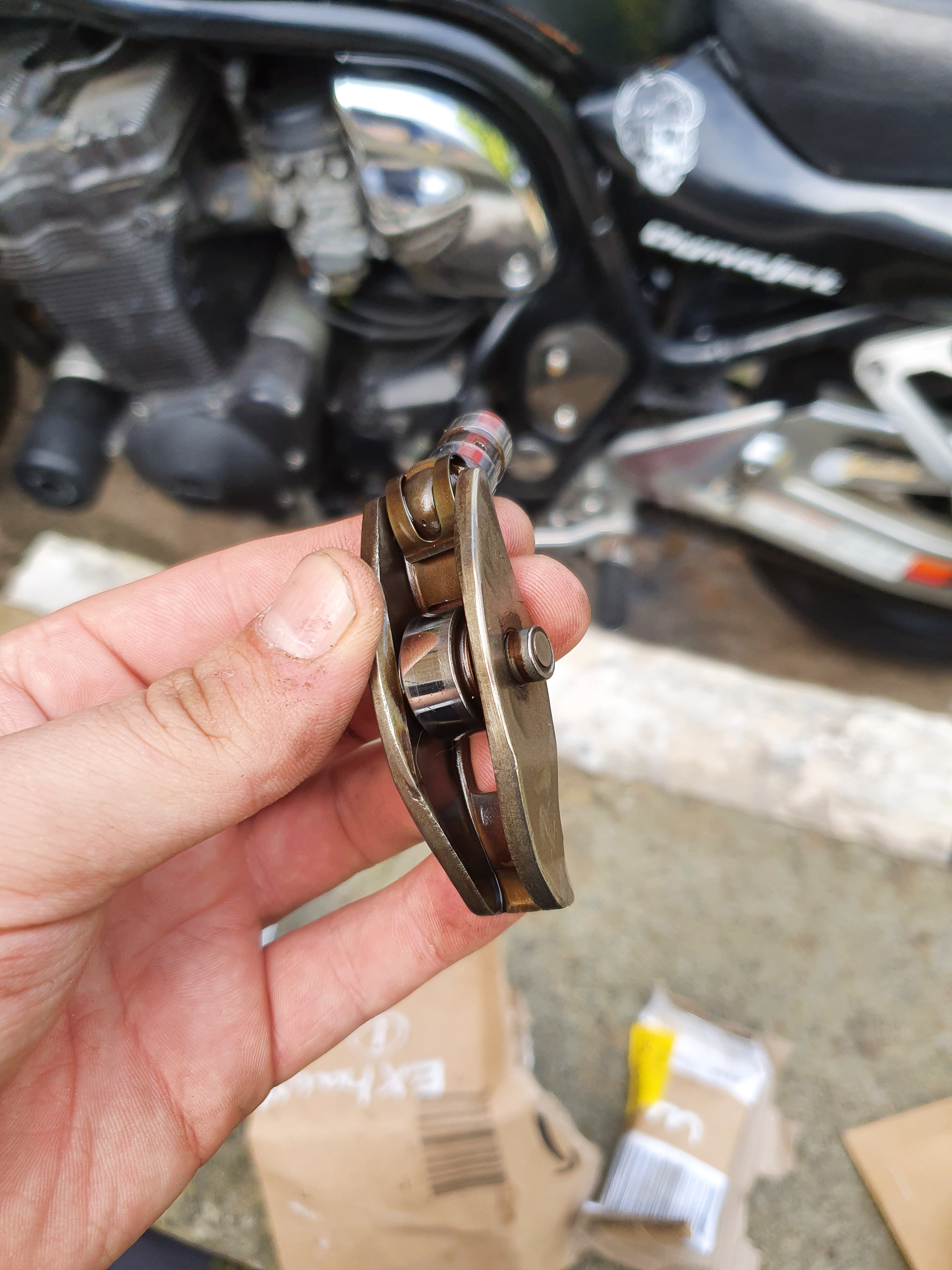

  2. Hi everyone, on with a valve job at the mo. Think i may need to replace some of the valve rockers. The ones mounted on exhaust valves look like the centre pin that goes through the pully is coming out. Anyone seen this before should they be like that ? Cylinder 3 was the worse. Non of the rockers on the intakes are like it. I was going to try push the pin back though the pully but it looks like the hole may be threaded.
