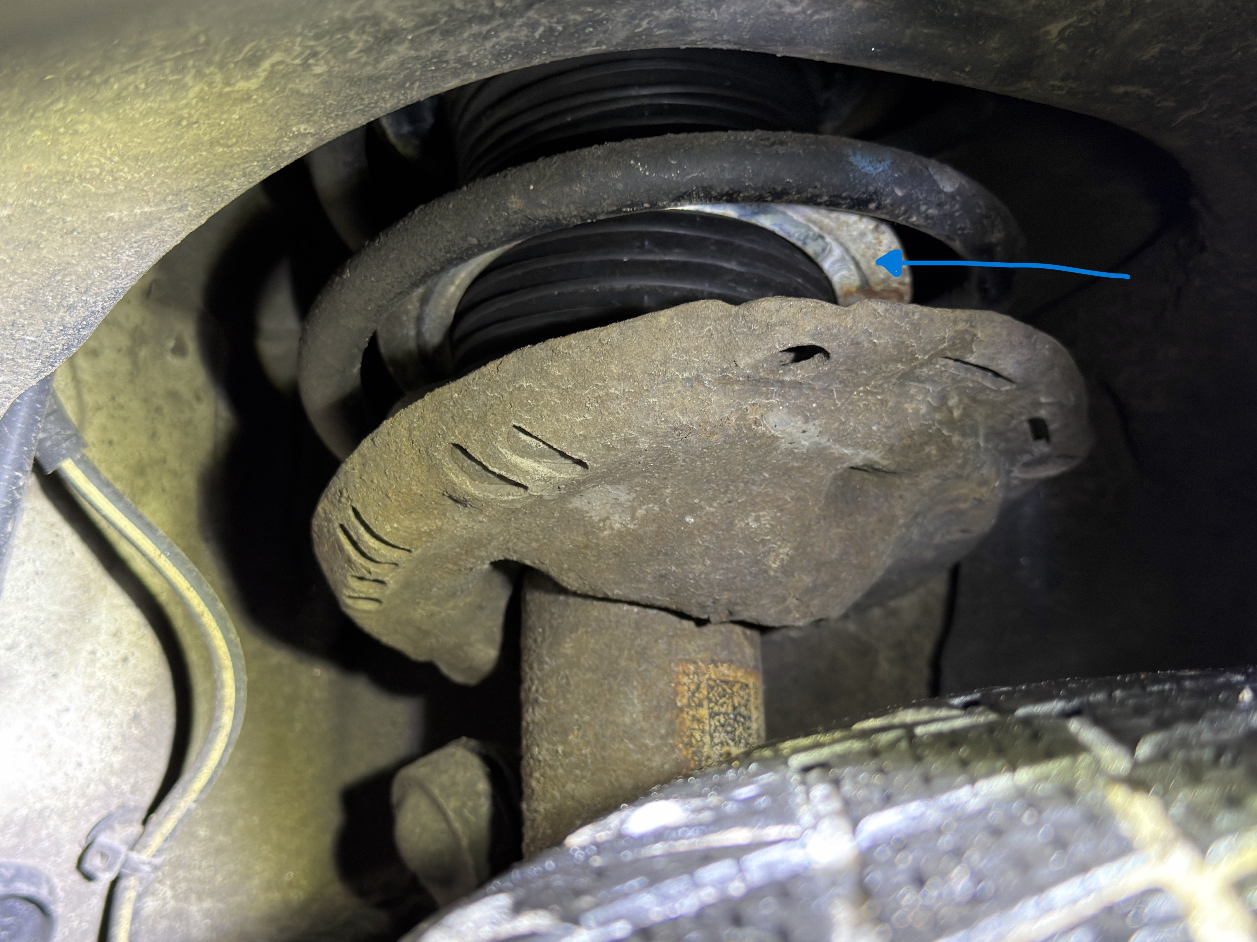

  1. Thank you for your reply. Did a quick measurement. I'm guessing that the spring is broken as my car seems to be about 5cm lower on the "damaged" side.
  2. Thank you for your reply. Something like in this picture?
  3. Hi, The suspension on the front right makes a clonking noise when I rotate the steering wheel fully to the right or drive over bumps. I managed to spots a loose ring shaped piece inside of the coil. I have tried to identify what the piece might be but with no success. Any ideas?
