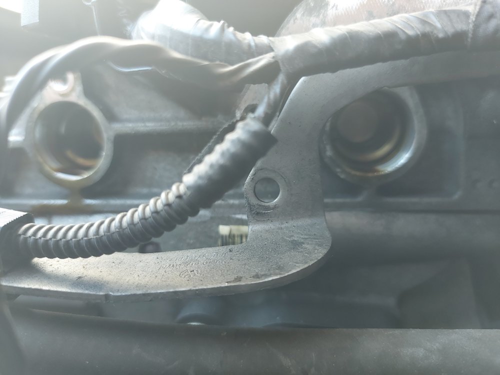

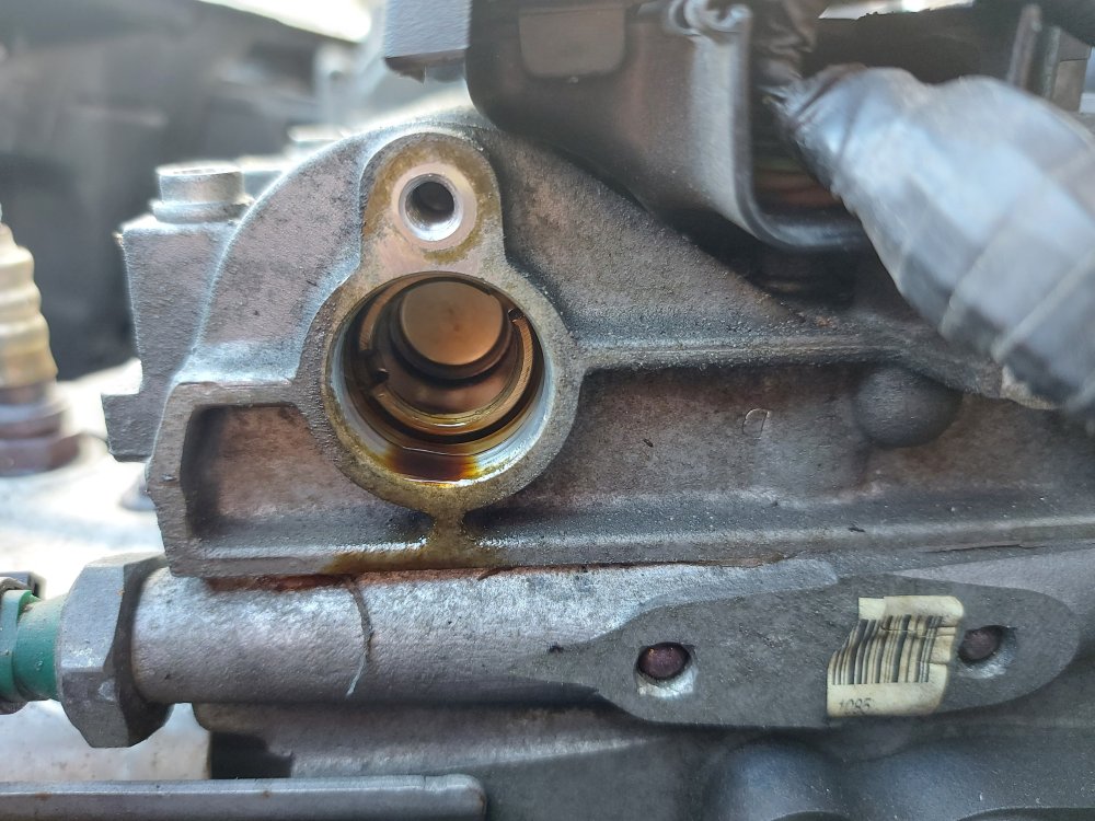

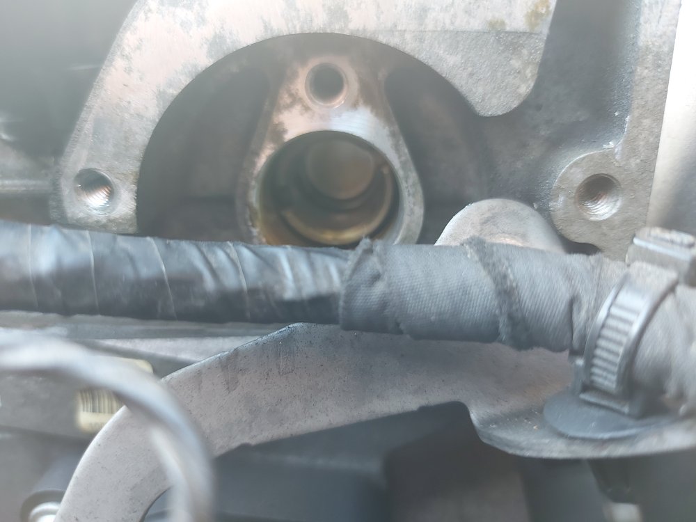

  9. Managed to get a look as you advised. They seem to match positions in my opinion which is good, I think? Posting photos to follow. Wasn't easy to take photos but got 3. One of each and one.of both together. Hopefully you can offer an opinion from them and let me know. Thanks again for your help so far.

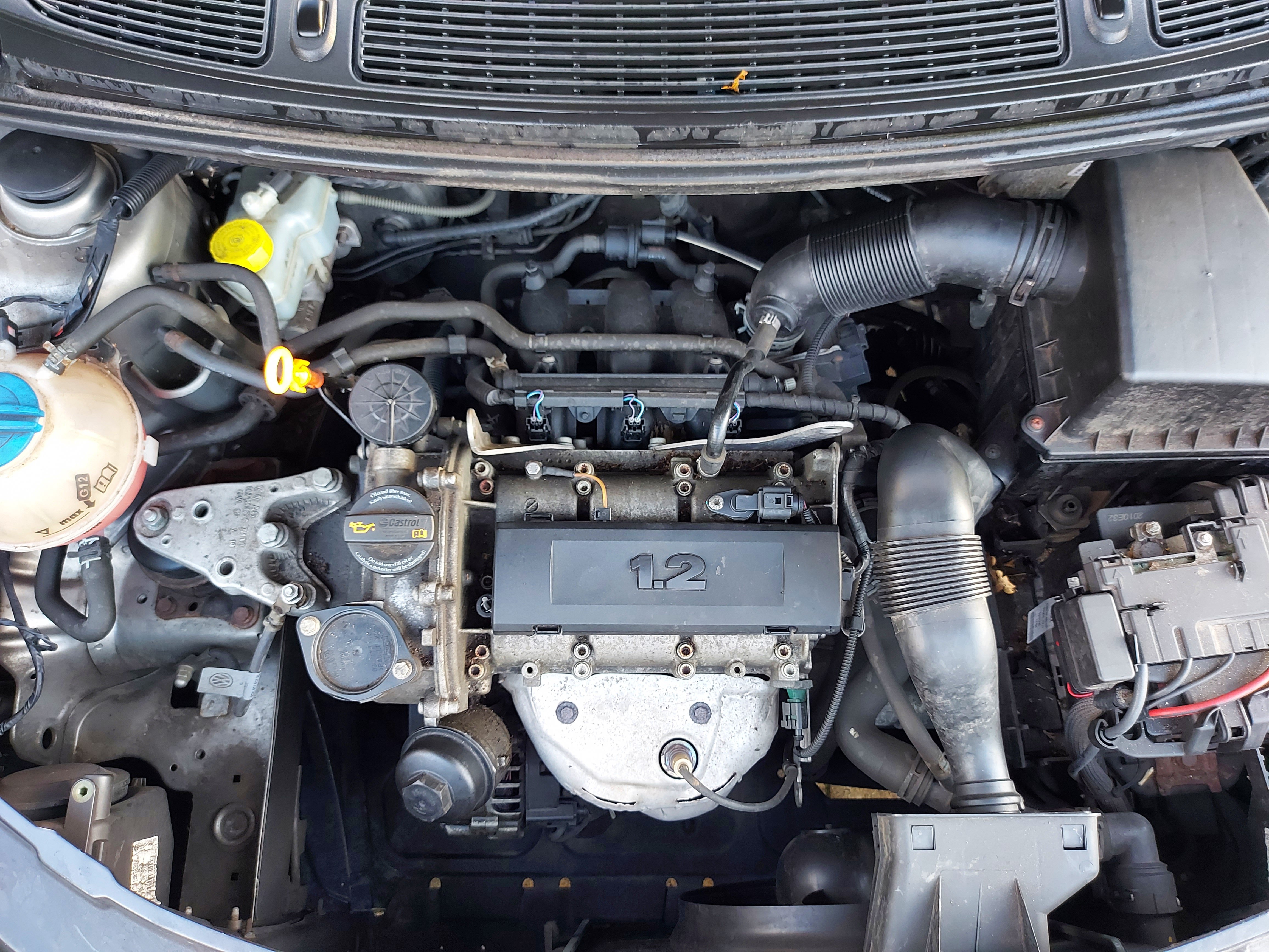

  12. Good morning. Attached is a photo of the engine of my Fabia. It's done 118000+ miles so isn't the youngest car anymore but its run perfectly until this. Given everyone's comments, from people far more knowledgeable than me, the picture being built is that it would cost way more to repair than the car is worth so it feels like the end of the road, literally. My next step is to talk to my garage on Monday and share what you good folks have said and see what they say. In the meantime I won't drive it, unless I take it to part ex it, which is likely. I really appreciate everyone offering opinions. We're all living in difficult times and I could have done without this, especially after spending hundreds to keep it going a few weeks ago on wiring looms, service, MOT etc, but life is like that isn't it. Have a good day everyone.
