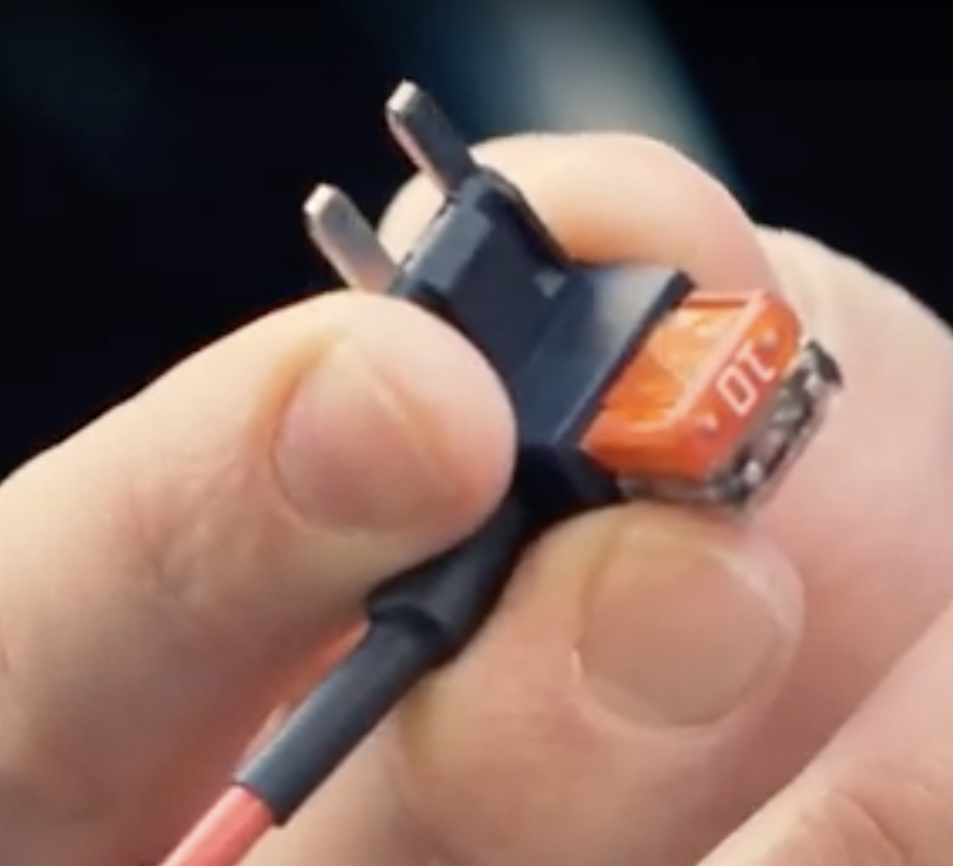

Ok thanks all. Finally have it working again. I've swapped it for the larger piggy back as I actually have a fuse for that one still in the box. Very perplexing as I'm adamant that I didn't have a camera fuse in the piggy back in my previous car. I remember wondering which slot I needed to use for the fuse, meaning there wasn't one in it already, and once I stripped out the kit from the old car, there would have been no reason for me to remove the fuse. Very odd. But through some trouble shooting and your answers its working again. Just to plumb in the rear camera tomorrow now. Thanks all.

I've just noticed on the Nextbase website that the hardwire kit already has a fuse in the piggy back kit. Does it need both holes on the piggy back filled!? Mine didn't come with a spare and it worked fine in my previous car without one in that spare slot. Looking for any possible reason it might not be working now! I thought I'd charge up the camera today whilst using the car with the cigarette lighter plug but it seems that just runs the camera and didn't charge it at all. Just kept it ticking over and the moment I took the cigarette lighter out the camera was dead again. It hadn't stored any residual charge. So I've removed it and trying to find a cable to charge it indoors with to try again. Is that normal too? I would have thought the lighter socket would have charged it up. TIA

Help!!!! I cant seem to get any fuse to work with my hardwire kit. Tried everything. I'm stumped! Set the bloody airbag error off to! Maybe a little more content since I've now come in the house and put the car back together before I swear and damage something! I've got a 522 Nextbase and a hardwire kit. I previously had the hardwire kit plumbed in to my Insignia before removing it recently to go in to the Kodiaq. I followed this posts steps originally (although I had the proper hardwire kit not my own makeshift one) and it worked perfectly. I did set the air bag error off annoyingly but I assume this has absolutely nothing to do with it not working. I've tried multiple 7.5 and 10amp fuses and various parts to test the earth but still nothing. Questions which I'm still not sure of: 1. Can the fuses work either way round? 2. Can the hardwire piggy back fuse work either way round? 3. Does it matter what size fuse is used? 4. Will the camera charge up from that connection if the battery is completely dead? I remember the original instructions for it were very strict about making sure it had some juice in it before you start trying to use it. TIA
