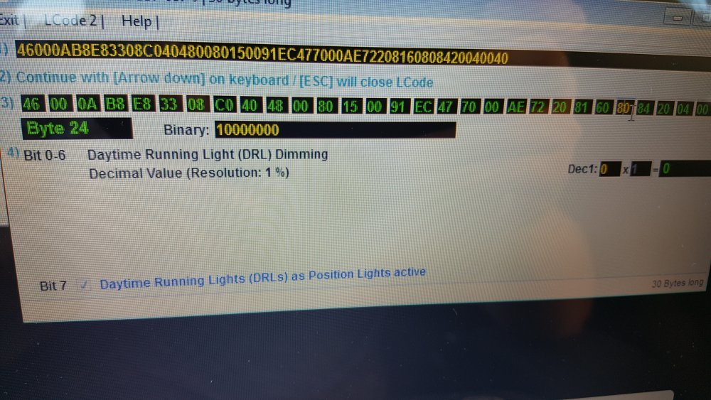

Octavia MK2 FL VRS LED DRL not dimming & blinding others during night time
Hello, mate, I have recently done an Autoscan of the car. You can check it out here. There's only one error with the aux cable because it was an open circuit since it was not connected to the phone. Otherwise everything is OK. I have to mention that coding the DRL dimming option from the message above didn't have any effect, so I guess the issue is with the byte18 you mentioned. Will hopefully drive it to the dealer on Monday and see if they can help. If you find anything interesting on the Autoscan let me know. Thanks!
Yep, that's the normal behavior. Mine remain at full brightness all the time. I just hope there is a setting into vcds that can fix this, otherwise I need to go and make the dealer a visit hoping that they can fix it with Odis. I have read some forums and someone found this picure. I wonder if this will fix it. Will try it out when I'll receive my vcds.
Indeed, this is a very detailed answer, thanks for the clarification! Yes, I have the headlight switch you mentioned. I haven't tested with sidelights or dipped beam yet since I like to keep them on Auto. But on Auto, The DRL isn't dropping in brightness when the dipped beam automatically(the xenon) switches on. Will test it tonight by manually switching the lever to dipped beam position, but I recon it won't do any difference.
I'm sorry, I'm not really familiar with the terminology you're using here. I know only of main beam (the d2s xenon bulb), the high beam (the h1 halogen bulb), the DRL's and the fog lights (hb4). I don't know of any other lights on my Octavia 😂 And the issue is that as far as I know, while having the main beam) the xenon bulb on) the DRL's should dim considerably.
It's in the EU 🇪🇺 regulations that the DRL's should dip when having the main beam on, since they glare a lot during night time. The main purpose of the DRL(DayTime Running Lights) is as the definition says, that they need to run during day time only, and eventually dim as they go through the night. The Headlights do levelling dance only when the car starts, mine was only on ON position without having the engine started.
I have recorded another video showing the issue, as you can see, when the main beam is on, the DRL's won't dim. Proof here
A phone camera won't be able to capture the intensity correctly when filmed from the front. For example, when the xenon main beam gets turned on, the camera automatically corrects the intensity and makes the DRL seem they dim a little bit, but in reality they don't. The main idea is that my drls remain on at full power no matter what.
