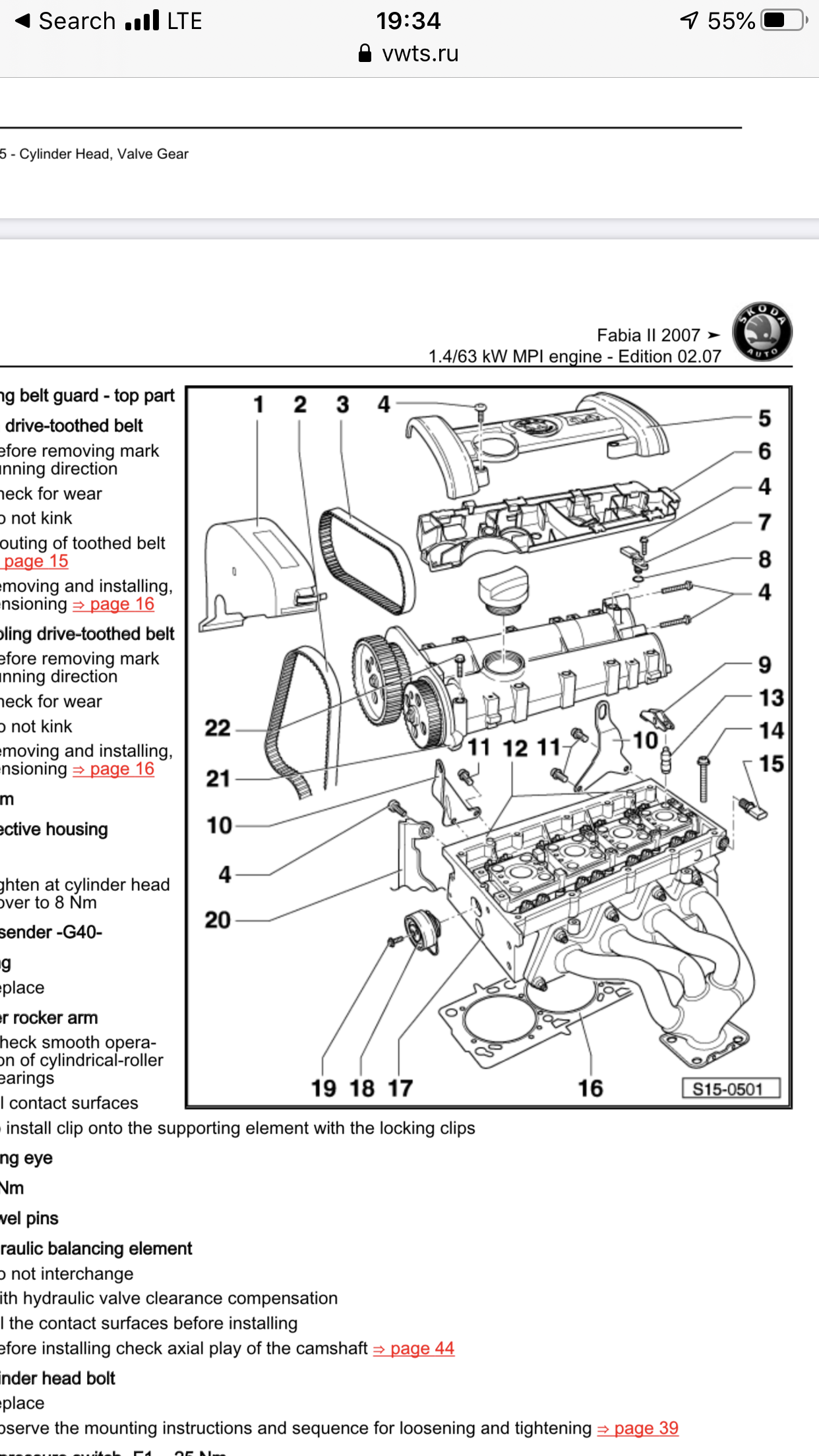

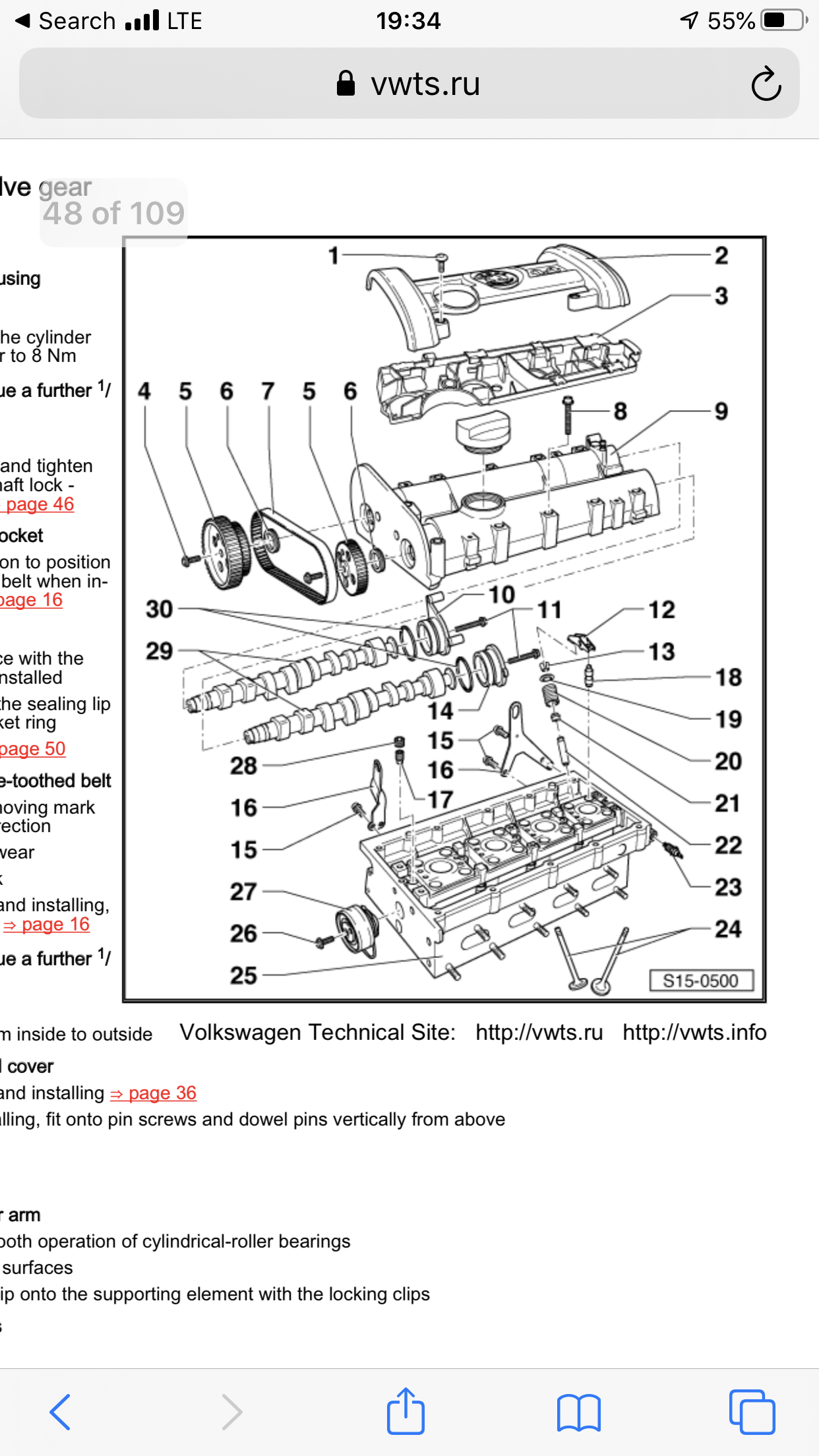

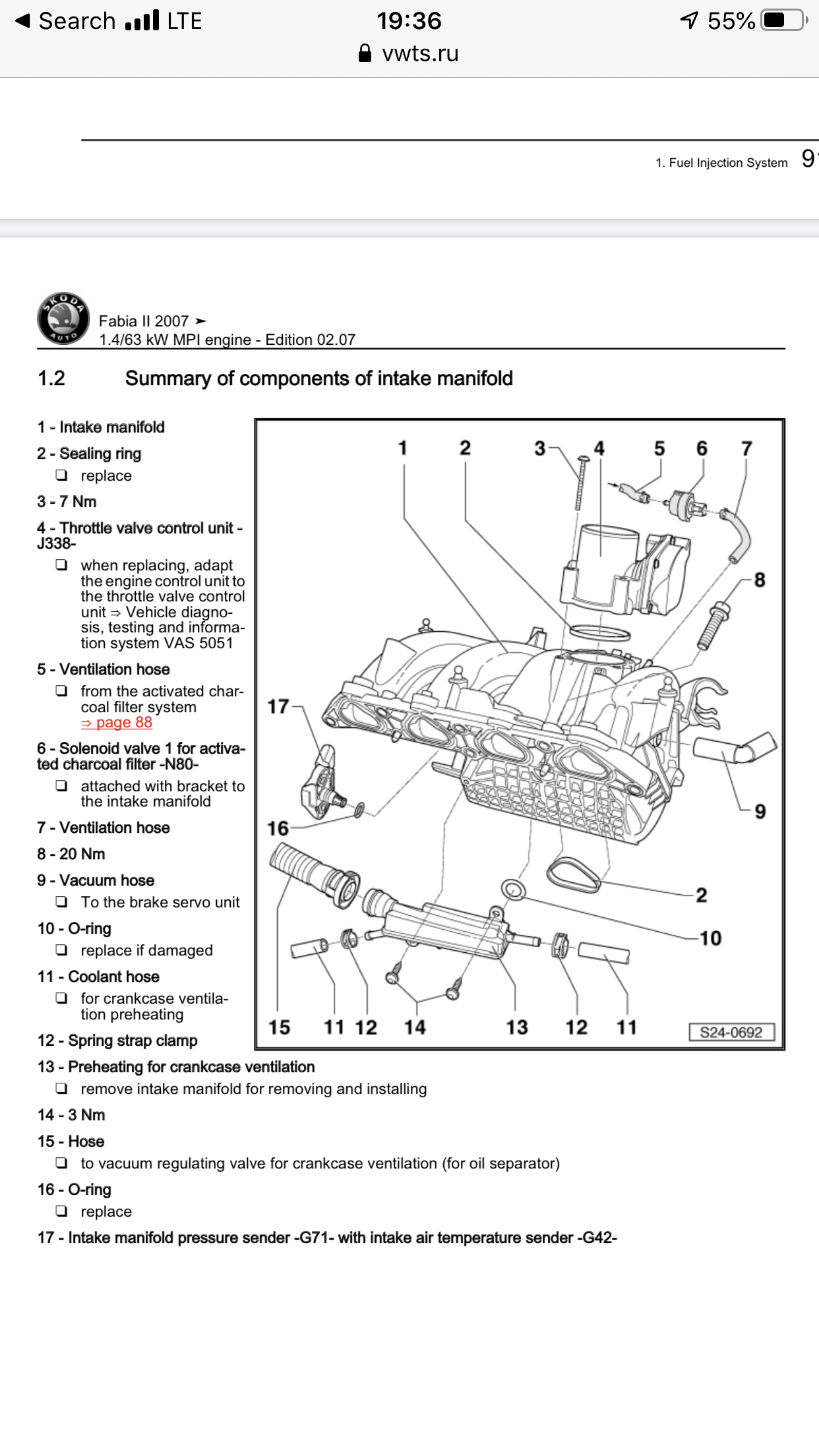

  6. Thank you for this very detailed answer🙏🙏.
