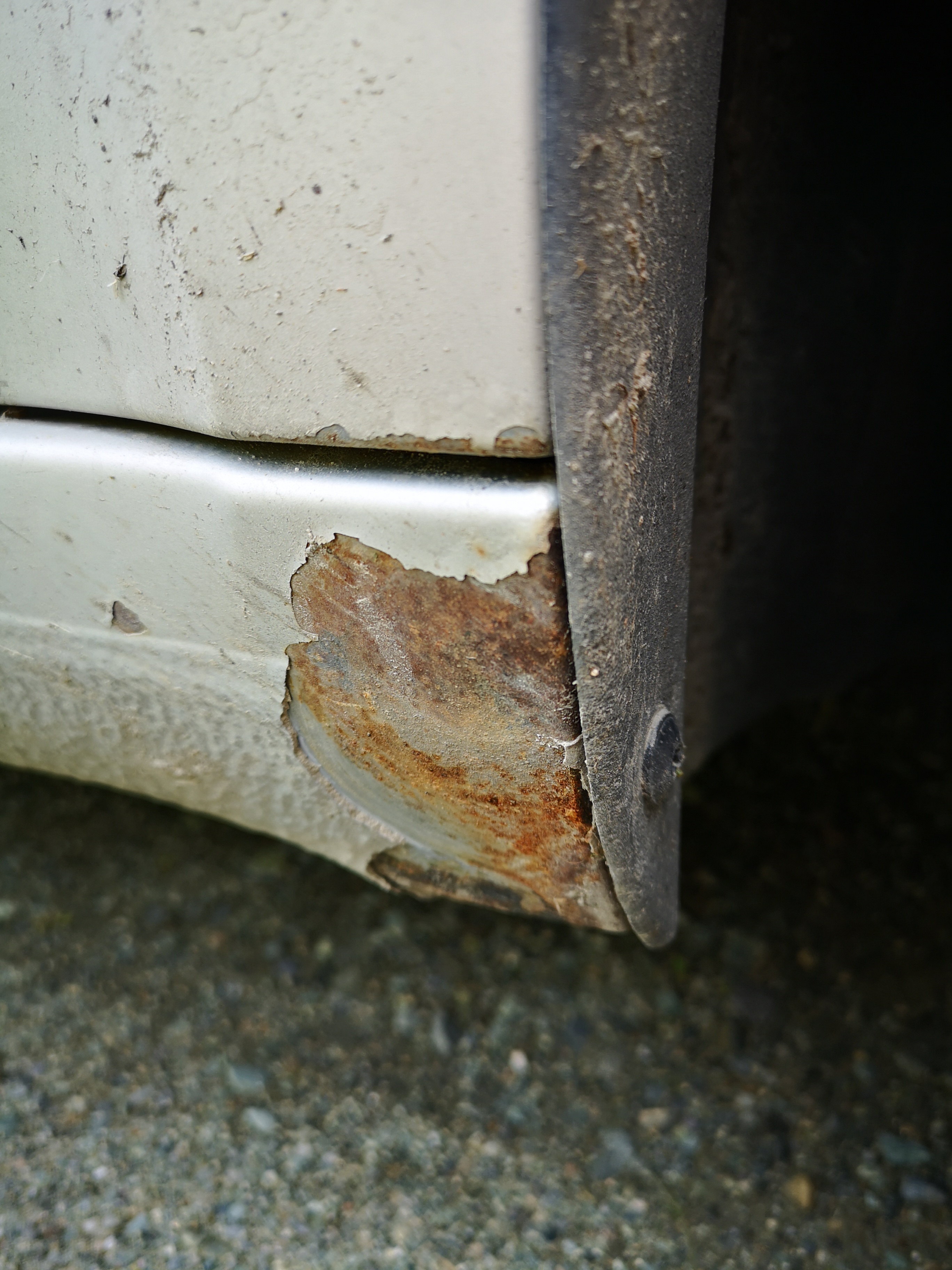

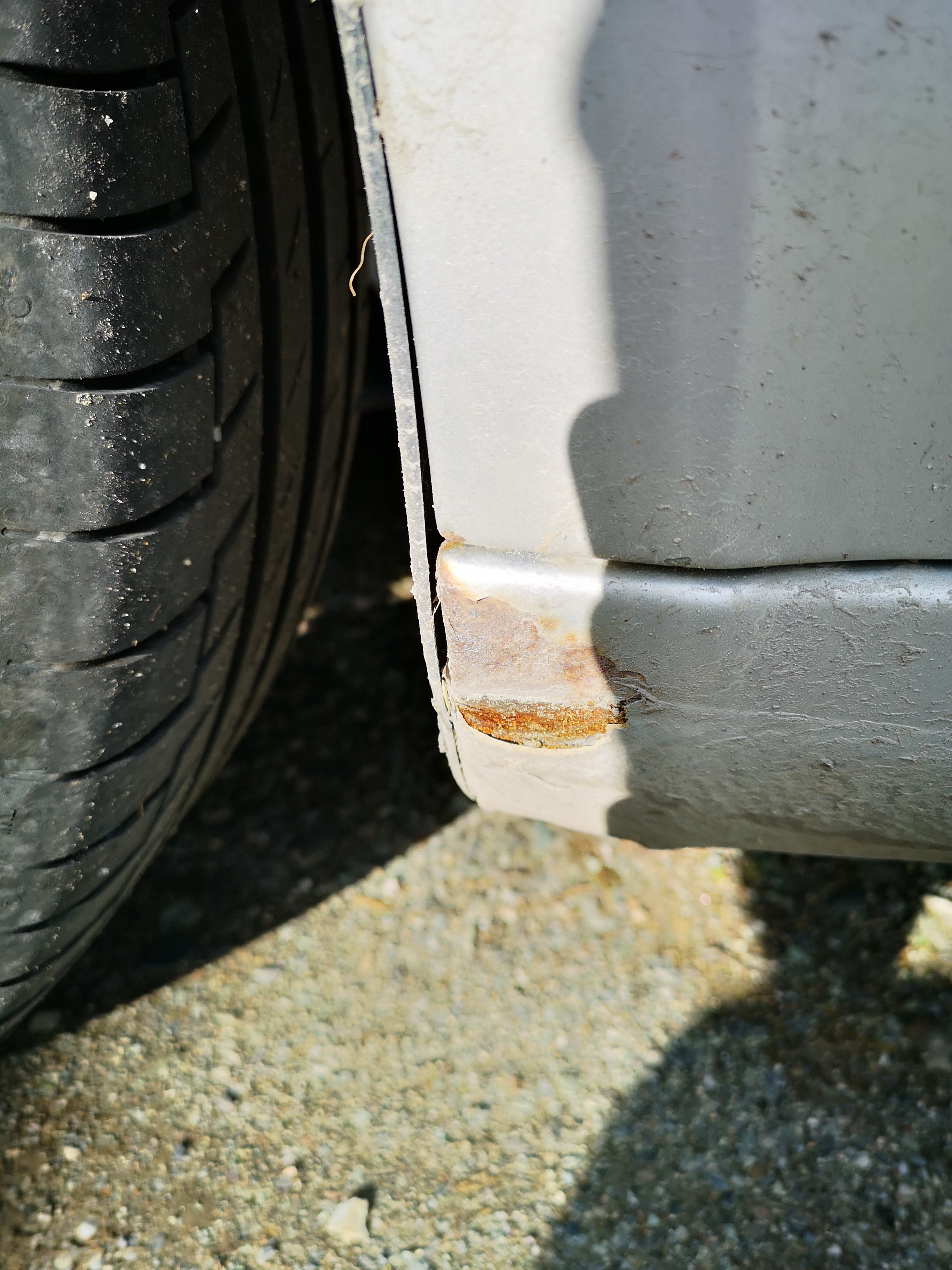

  1. Thank you for the info,Steve 👍 would Motip Anti Gravel spray work for this?
