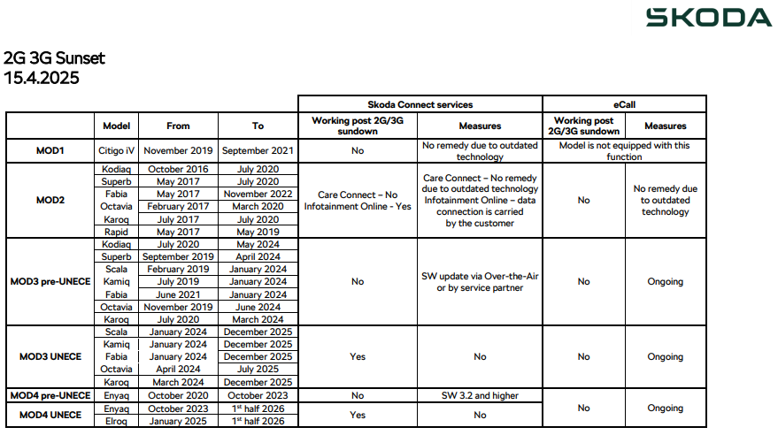

  6. What Are MOD1 and MOD2?MOD stands for “Mobile Online Dienste” (German for mobile online services)—essentially the connectivity hardware/software versions fitted to Škoda vehicles. According to Škoda's official communications, these refer to generations of the connected services infrastructure used in their cars Škoda Auto. Key Details from Škoda:Škoda groups vehicles by their MOD generation: MOD1, MOD2, later followed by MOD3 (and presumably MOD4). These classifications define the capabilities and limitations of the car’s connected systems Škoda Auto. MOD1 and MOD2 vehicles: Will lose access to most Škoda Connect services after the impending 2G/3G network shutdown in Europe, because their hardware cannot be updated to support LTE/5G Škoda Auto. Exception: MOD2 may still support Infotainment Online, but Emergency Call (eCall) will not be functional for MOD2 (and MOD1 already lacked compatibility) once networks are phased out Škoda Auto. The network phase-out timeline: Certain countries (e.g., Switzerland, Sweden, Iceland) will start shutting down 2G/3G on 1 January 2026. The rest of Europe follows between 2029 and later years Škoda AutoŠkoda Ireland. Summary TableMOD Generation Škoda Connect Service Support After 2G/3G Shutdown MOD1 All connected features—including Infotainment, Emergency Call—will be unavailable MOD2 Infotainment Online might still work, but Emergency Call will not MOD3+ These generations are planned to receive over-the-air or dealer-based updates to continue supporting services post-network shutdown Škoda Auto In ContextThese MOD classifications are not car models. Instead, they indicate what generation of connectivity system your Škoda has, which affects: Whether Škoda Connect features (like Vehicle Status, Parking Position, Breakdown Call, etc.) will continue working after 2G/3G decommissioning. Your ability to access Infotainment Online and Emergency Call. If you know your car’s manufacturing date, you can check with your Škoda dealer or your vehicle’s documentation to identify whether it’s MOD1, MOD2, or a newer generation—this will determine which connectivity features remain available after the network shutdown.
  7. I have been unable to connect my CITIGOe-iV to the MySkoda app since 6 August. When I contacted support they suggested creating a second account, but when I did so I was unable to complete the activation process (tricky at the best of times) when it came to entering the mileage (or kms?). I eventually received this from support: “We would like to inform you that the issue you are experiencing is related to your vehicle, which affects all remote services for MOD1 and MOD2 vehicles. Please rest assured that we are actively working on finding a solution. We extend our sincere apologies for any inconvenience this matter may have caused you.” Are other Skoda owners affected and what are MOD1/MOD2 vehicles?

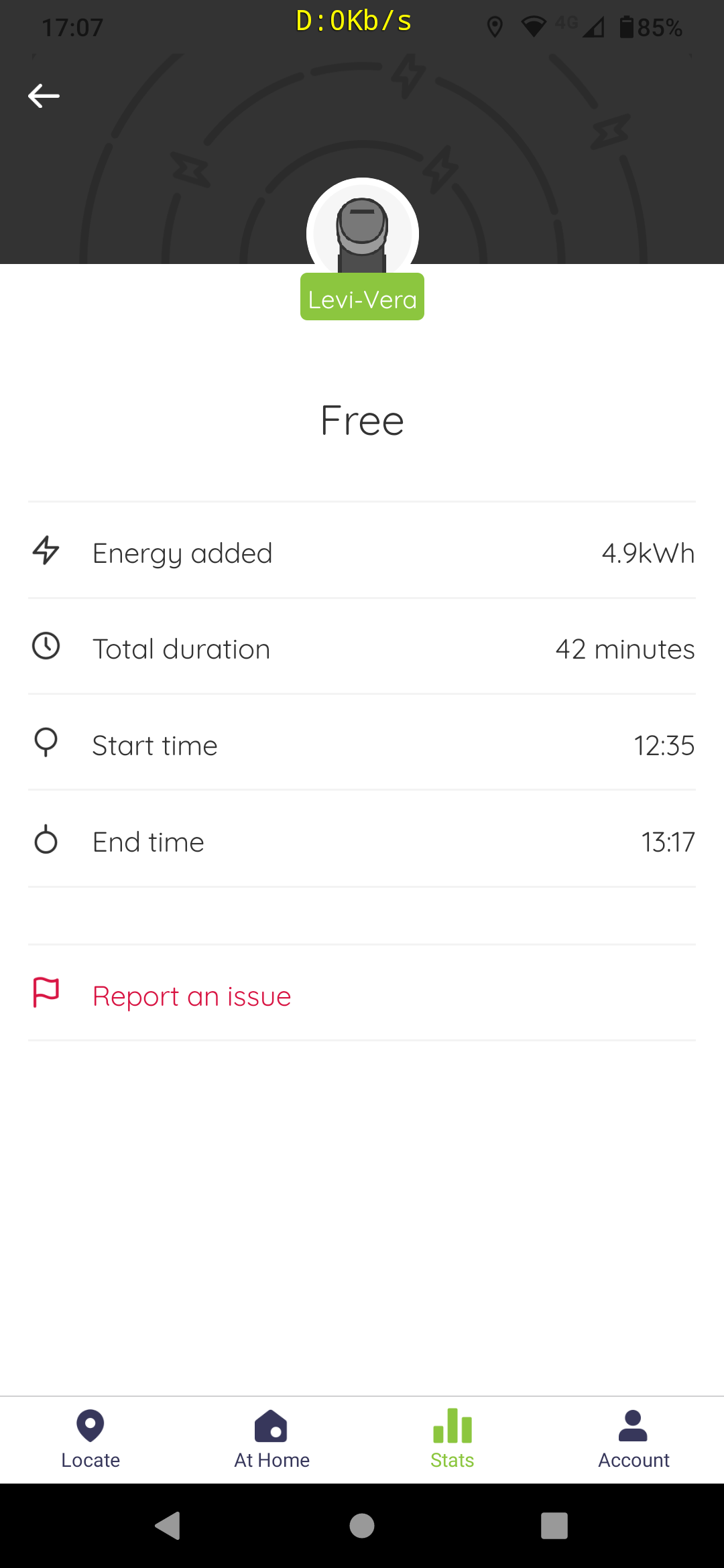

  8. After I had my AX4 Charging Unit replaced I found it would only charge at the higher rate if I used Move & Fun to set the charge rate, NOT MySkoda.
  9. Yes - using my own (not Skoda) single phase 32A Type 2 lead.
  10. Most Skoda dealerships have 3-phase 22kW PodPoint chargers which will, when using the Skoda supplied (3-phase) cable, charge at 7.2 kW/h. The problem arises when using a wall box at home connected to a 240V single phase A.C. supply. The problem definitely lies with the car. Mine has been back for a number of software updates, including one specifically for the charging control system. The issue I had was that the MySkoda app and Move & Fun app were both trying to control the MAX charge rate in an incompatible manner. I have created a video below which demonstrates the problem. The solution in my case was to use only the Move & Fun app for controlling the charging rate, and I can now get the car to charge at 7 kW/h when using the charging plans (which Move & Fun confusingly terms 'Locations').
