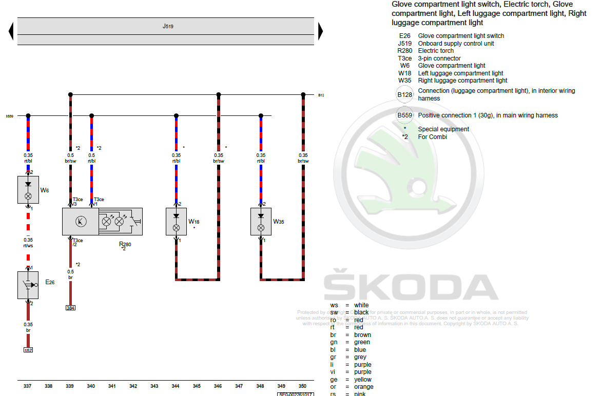

  5. This is most probably because the original lights have diodes in series. When the lights are replaced, the current can flow the other way and the control unit thinks the boot is open when you open the glove box. Even if a LED acts like a diode, there could be additional circuitry in them that allows a small current to flow the other way.
  6. This is most probably because the original lights have diodes in series. When the lights are replaced, the current can flow the other way and the control unit thinks the glove box is open. Even if a LED acts like a diode, there could be additional circuitry in them that allows a small current to flow the other way.
