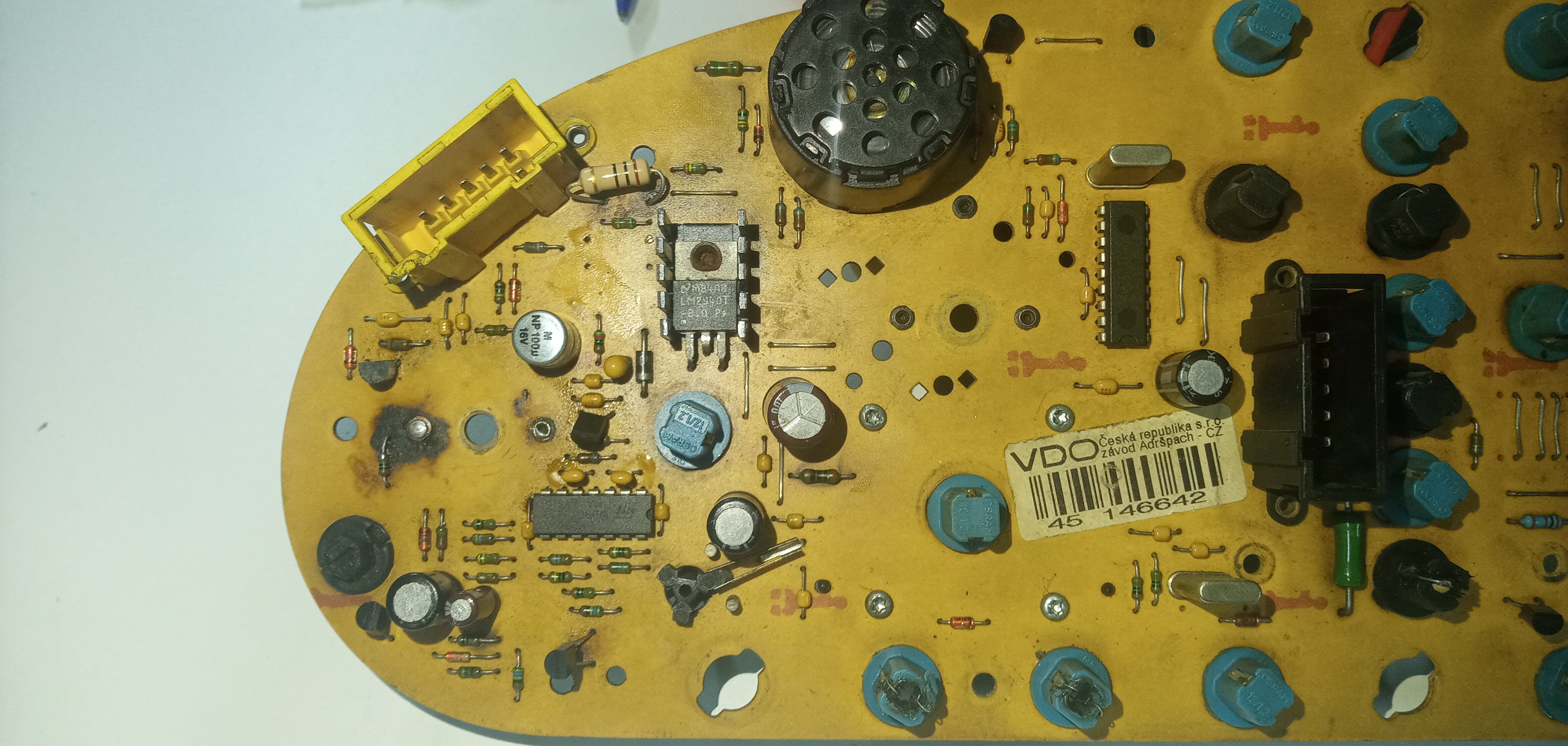

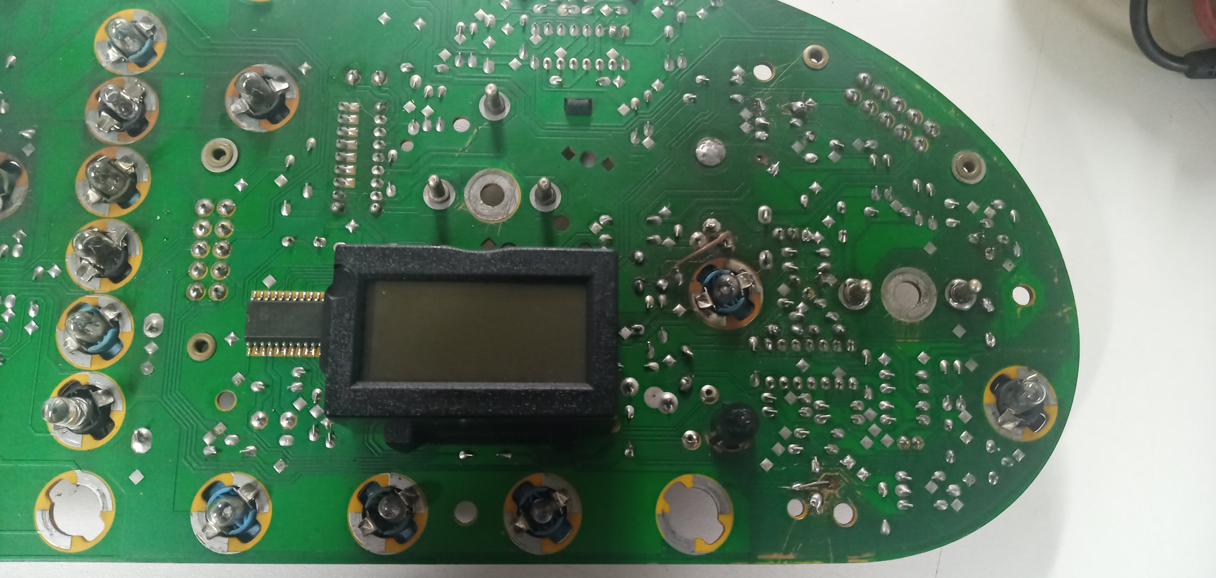

  2. the board works well everything except the gasoline marker as I see in your forums it is not the same board I saw a similar one but I think it is a diesel enante resolde some cold welds I hope to see that it is already solved, by the way I put the resistance of 10 ohm but it overheated started to smoke.
  3. How about Ricardo good morning good, I tell you my Felicia is from 1999 1.3 with air conditioning carburetor the gasoline meter does not work for me and I changed the meter of the gasoline tank but nothing I was checking your forums and checking the panel and it was missing the resistance of 10 ohm that you say in a photo, but I changed it and it does not work even just putting a jumper from pin 1 to the L2 of the coil works but it does not mark 1/4 of gasoline and the value is unstable. well thanks in advance.
  4. Que tal buenas noches tengo un problema con el medidor de gasolina de mi Felicia 99 la verdad no marca nada según sus comentarios acerca del tablero me di cuenta que no es el mismo y solo poniendo un cable directo a la bobina desde el medidor funciona pero aún así falta que marqué 1/4 eh estado revisando algunos comentarios pero ya no sé qué hacer eh medido el voltaje en la línea y si tiene 8 v pero en la.otra línea no llega nada de señal a menos que haga puente
