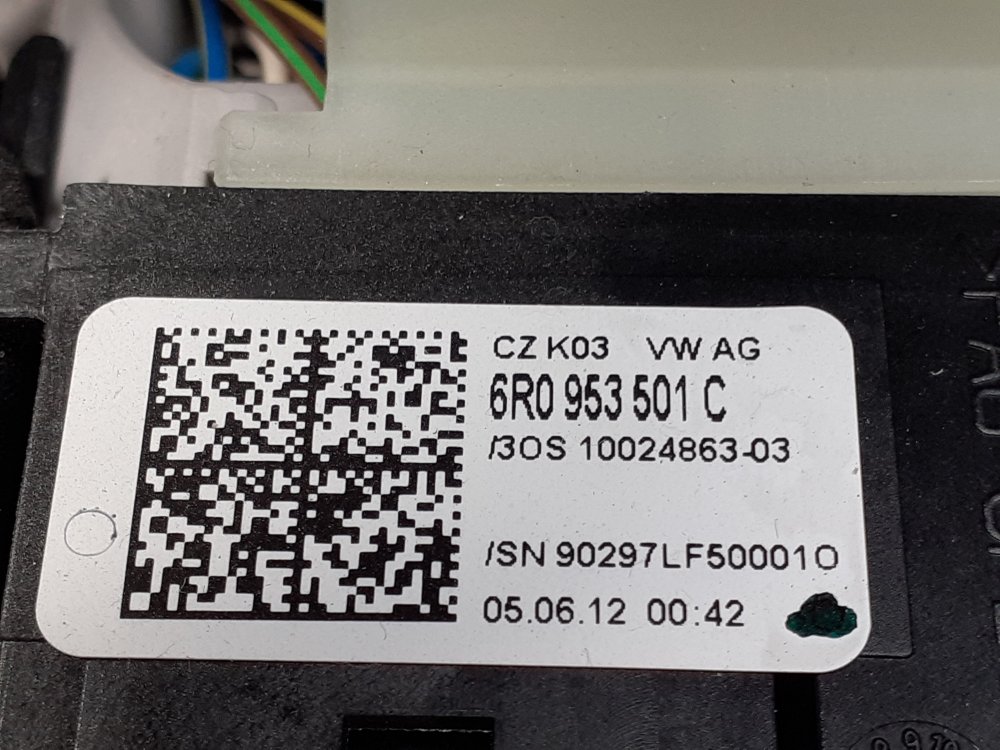

Hi , I've got a 2012 1.2 TSi Fabia estate on a ramp at a local garage. The mechanic thinks the steering pump (one with green dip stick) has failed. He says the computer he has cant communicate with it at all, so he cant get any codes from it. He is concerned about re coding issues if we get an off the shelf unit to replace it. So the question is this this case? Do these steering pumps need a unique code to communicate with the cars ecu or are they 'plug and play' (his term) I've found a place which sells reconditioned pumps or they can rebuild the one you send in, so he's saying best get it re built if it avoids re coding issues or an a reconditioned one if not . due to time and storage issues I'd rather get an off the self one but not if there are more head aches when it's fitted pic is of the one in the car. Mant thanks for ant help
