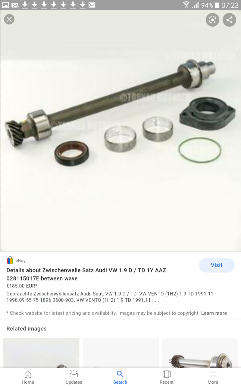

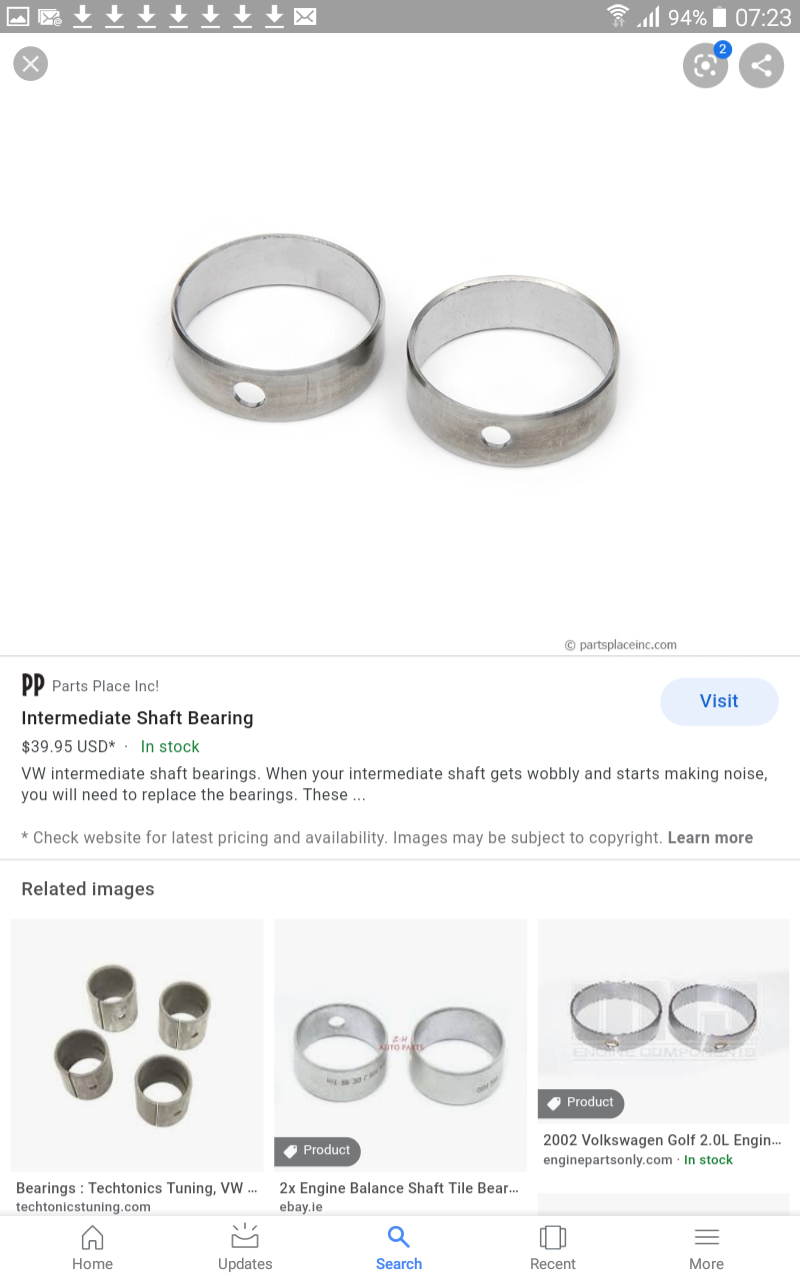

  1. Hi, ive got to the bottom of it! The intermediate shaft runs on shells. One at each end. The belt end or sprocket end has an diagnal force on it due to the timing belt tension. This force has worn the shell into an elliptical shape causing the shaft to only exhibit wear in one direction which is why it's felt in the opposite direction. The shell needs to be replaced before it wears enough for the inner lip of the oil seal to gap or the shell breaks up or as it wears, the tension on the timing belt is taken up by the tensioner but putting the timing out marginally between the crank sprocket and the diesel pump. Does any body know if the shells are still availible or part numbers? If the shaft can be removed with the engine just lowered enough for it to pass by the chassis? Does the shaft just slide out? How are the shells replaced? It's looking a bit of a nightmare! Thanks for you help and any more input would be much apreciated. Pics are attached. Regards
