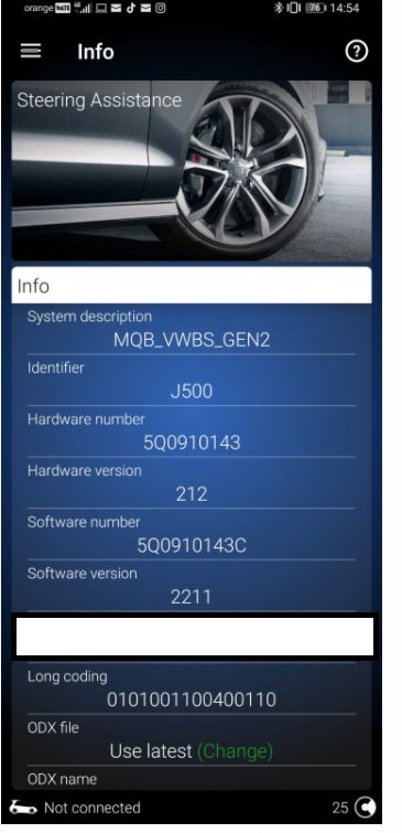

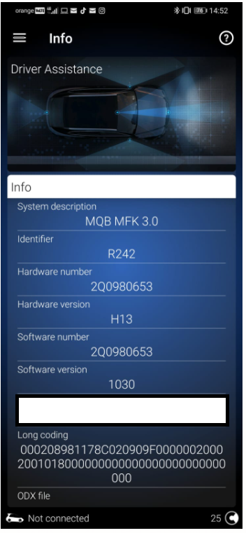

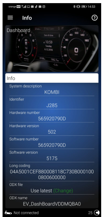

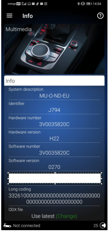

  6. I managed to make it work with OBD 11 on MJ21 with 2Q camera & MIB3(amundsen) A5 -> Long Coding(page 0) -> Point_of_intervention -> early_setting_over_menu(It was on Late)

  10. I am not really much of an expert on the adding stuff to the car. What I can say to you,I ordered an style with Lane assist,side assist,front assist,High Beam Assist... pretty much everything except Traffic Sign Recognition with the thought that I would simply code it using OBD 11 after receiving the car. The option of TSR would have cost 80eur extra. My car is a MJ 21 with MIB 3 and after delivery I learned that I can only activate TSR using swaps which essentially means hacking of the main unit(and a lot more money) hope I don't say anything stupid here. Considering that MIB 3 and MJ21 are coming with different A5 cameras then the other Kodiaq's (Normal cars have either a 5Q or 3Q HW camera, the MJ will have a 2Q camera= > therefore not a lot of people would have experience in codding stuff) If I wore you I would consider to add to the order all the stuff that you would really like on the car and be done with it.

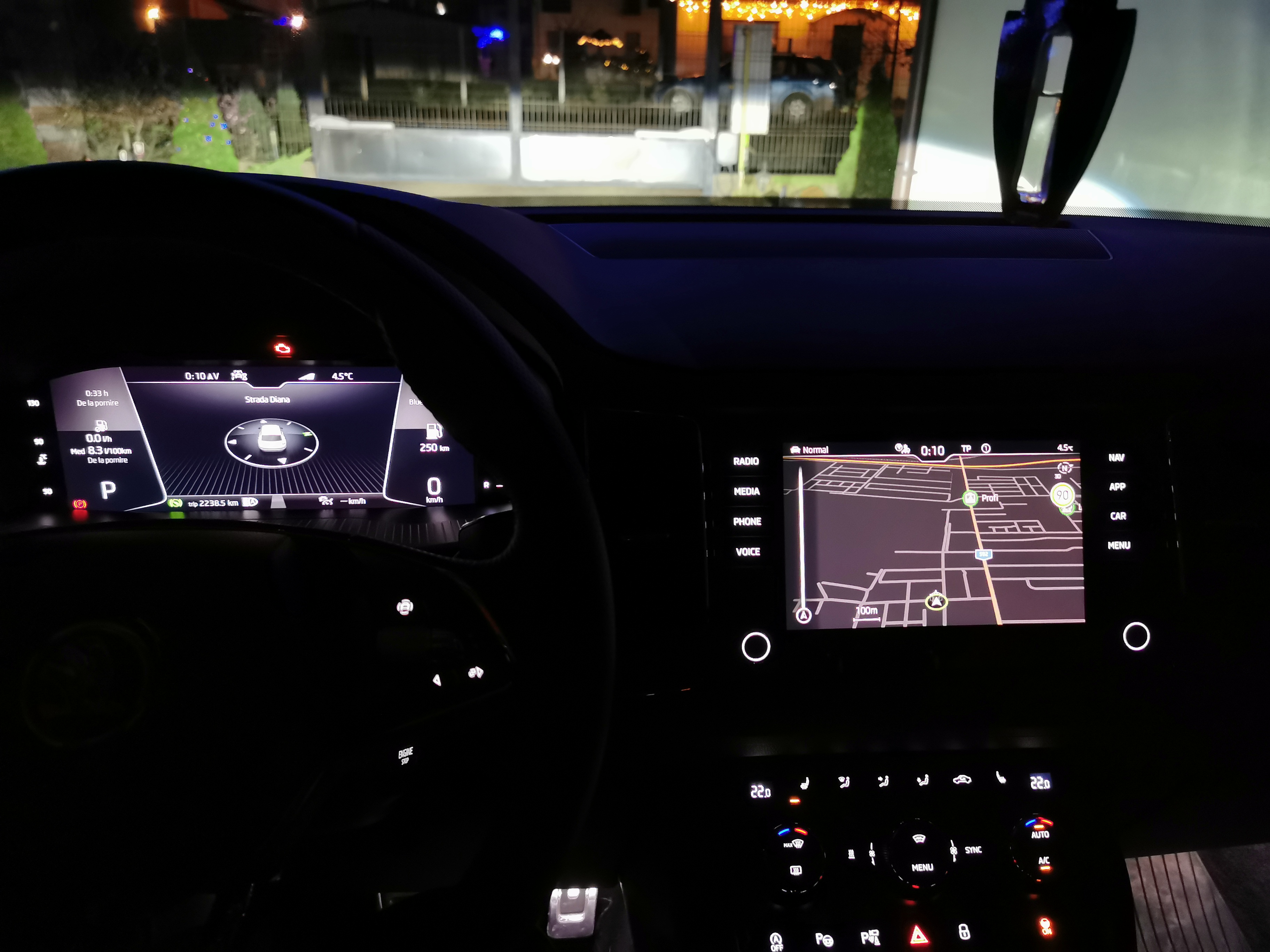

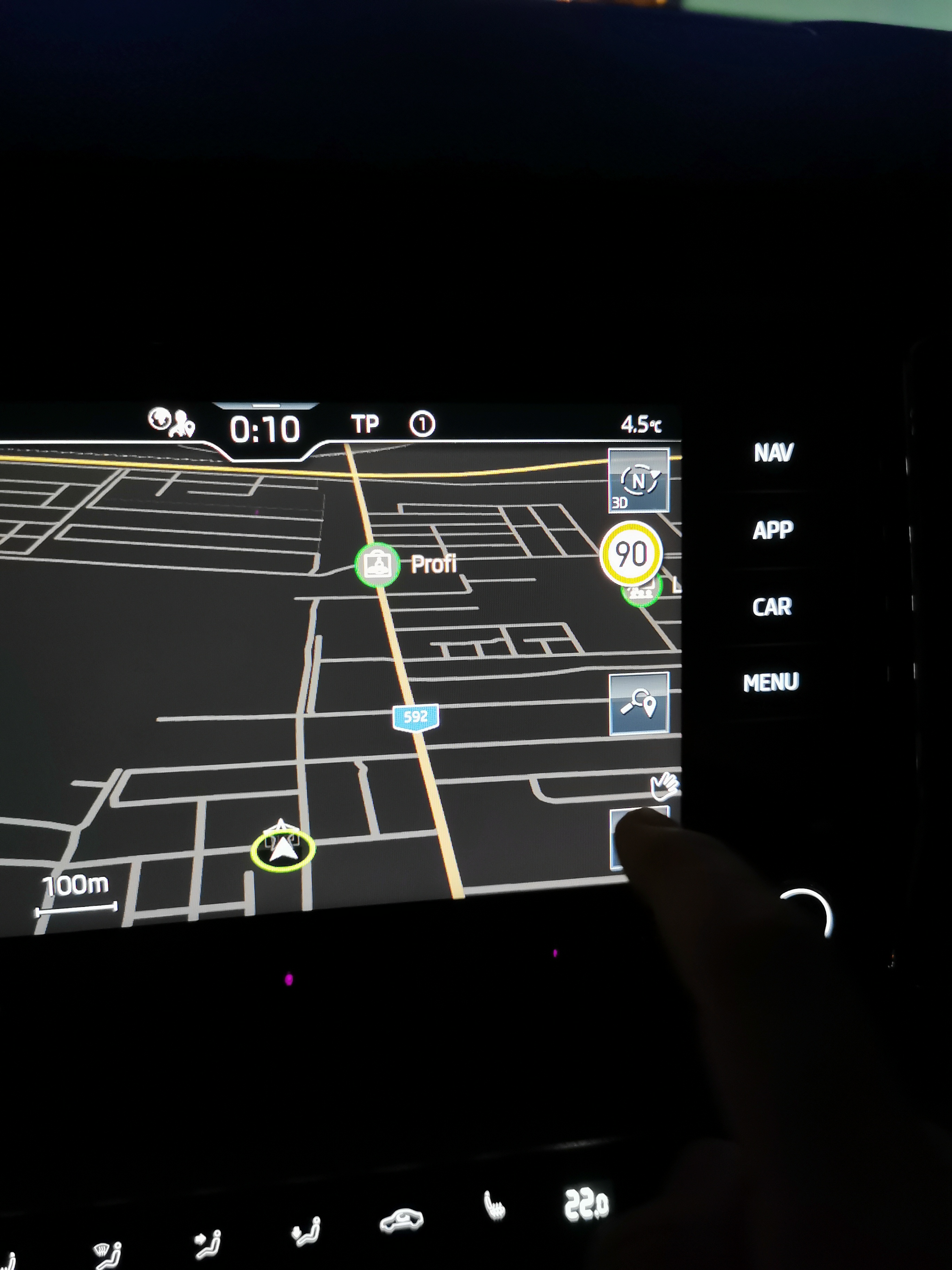

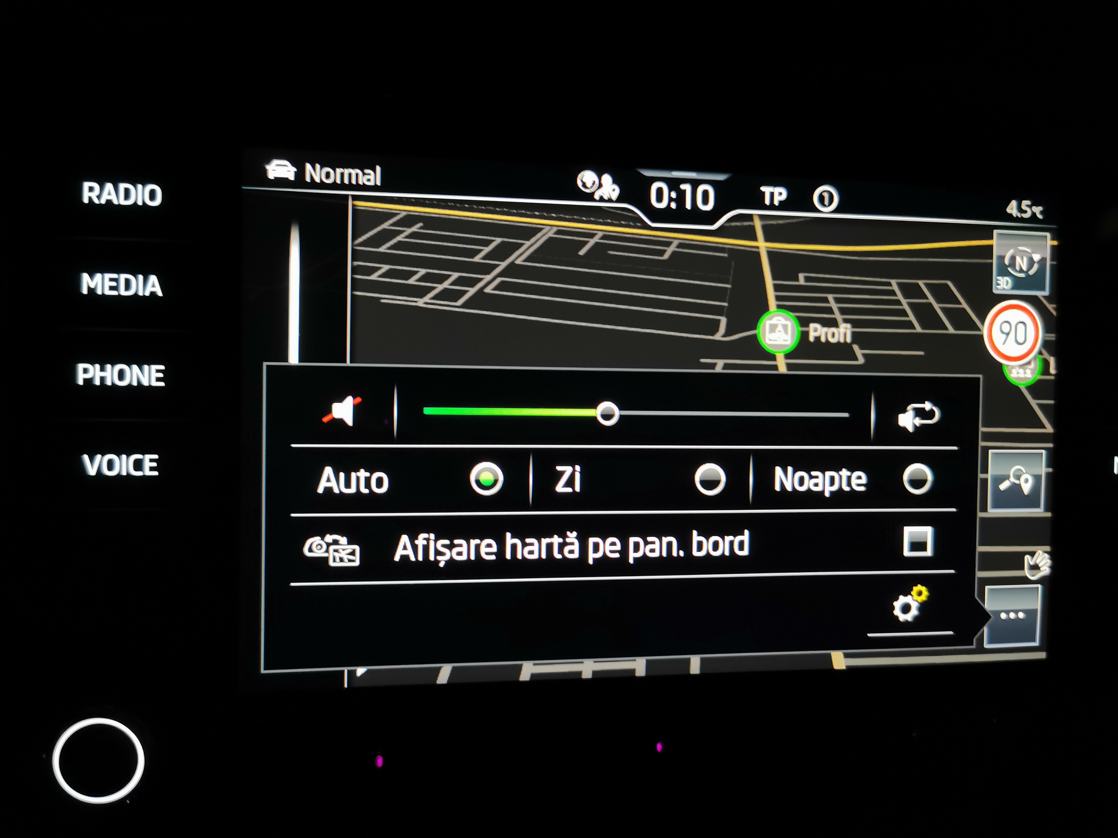

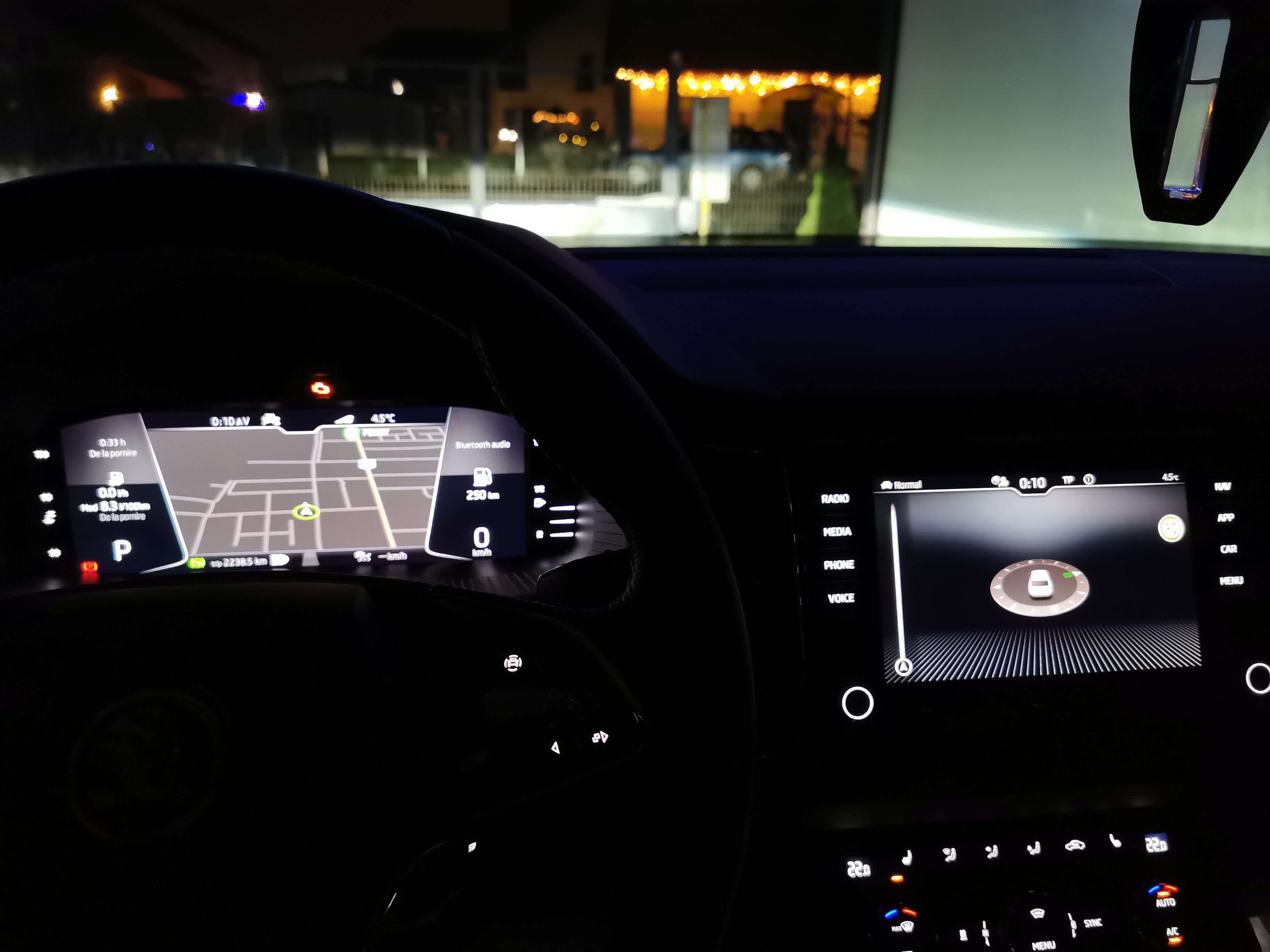

  11. @Scot5 I really don't know what your problem is ,but you should respect more the other's around you. Furthermore as a MJ21 Kodiaq MIB 3 Amundsen owner i know what I am talking about. picture 1 is for Map showing on Amundsen Screen and just compass on the VC Picture 2 is when you go with your hand towords the screen of the Amundsen it will show you a "..." which when you touch will lead you to the menu in picture 3 Picture 3 is the menu explained before,also :"Afisare harta pe pan. bord"= " Showing of map on the virtual cockpit" Picture 4 is the Map showing on the VC and compass on the Amundsen Screen. Again as far as I know you with the Columbus will not have this option as the Columbus can show it's native map on the VC and the screen on the same time. Do you need any other info ?
  12. @Scot5 Since you have a Columbus ,you don't have that problem. MIB 3 Amundsen has an option where you have to manually choose where you want the map to be displayed ,it can show in the VC or on the Amundsen screen but not both at the same time. MIB 3 Columbus does not suffer from this as far as I know, as it can display it's map on the VC and screen in the same time. With this MIB 3 generation they have a lot of trouble to justify the need of 750 Euro price difference between the Amundsen and Columbus.
