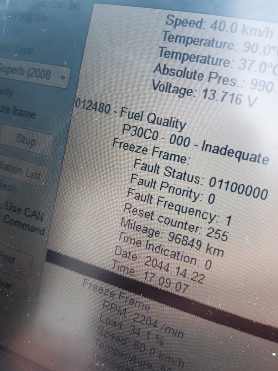

I have searched up on ross tech about this code and on vw forums and I've come across a few other people with this problem . They changed map sensors and all was good but still having problems. Done a lot of research and I've heard of people putting their cars into garages and dealers and they still cant trace the problem after spending more money that what the cars worth...

I had a friend who had VAG COM software and this is what came up. Since then I've changed the fuel filter. Used a fuel cleaner additive. Tried to run shell v power 99 octain. Tried changing both the map sensors with new Bosch ones but still no different. Sometimes it wont put the light on dash and will just put car into soft limp mode. Limiting my boost to around 4psi. Normally runs 9-11psi. I have a cheap realtime code reader which shows me my realtime info such as boost ect. I'm stumped on what to do next. Dont really want to be buying all new sensors like knock sensors ect....
