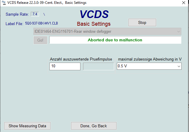

  1. Hello, i have a problem with a Skoda Octavia 3 2015. When i try to start the rear window defogger it stays on for a few seconds and it turns off. This problem appeared after my tailgate was replaced, i've tested the defogger if it is interrupted and it's not, and also tested the relay and it’s good. I also directly powered the relay and the defogger it’s working, so the BCM it’s not engaging the relay. Before the tailgate replacement all was working perfectly I have found this error in VCDS Thursday,17,November,2022,20:05:45:00009 VCDS Version: Release 22.3.0 (x64) Running on Windows 10 x64 www.Ross-Tech.com Address 09: Cent. Elect. Labels: 5Q0-937-08X-MV1.clb Control Module Part Number: 5Q0 937 084 AH HW: 5Q0 937 084 AH Component and/or Version: BCM MQBAB M+ H18 0137 Software Coding: 0C020846424702FB47E04000001407080200000000000000000000000000 Work Shop Code: WSC 53721 001 104857 ASAM Dataset: EV_BCMCONTI 013000 (SK37) ROD: EV_BCMBOSCH_013.rod VCID: 7EF34BFFF9F77C7FB0-802A 1 Fault Found: 559893 - Databus U1121 00 [009] - Missing Message [New feature! Extended UDS fault detail is only supported by current gen. interfaces] Confirmed - Tested Since Memory Clear Freeze Frame: Fault Status: 00000001 Fault Priority: 6 Fault Frequency: 1 Reset counter: 140 Mileage: 176727 km Date: 2022.11.17 Time: 19:56:14 Terminal 15 status: On Terminal 50 status: OFF CAN-Bus_aktiv: On Status Bremslichtschalter (HW): OFF Status Bremslichtschalter (CAN): OFF OFF: operated Position lamps: Not operated Automatic high beam assist: Not operated Low beam: Not operated Parking light left: Not operated Parking light right: Not operated last_wakeup: no cause for fault protection Voltage: 12.0 V Outside temperature: 15.5 °C

  3. Ok so i’ve managed to test the wires from the relay to the rear window and all is good. I’ve made a bypass to the relay and powered the defogger directly and it’s receiving 12v, so i’ve got to the BCM or the climatronic button not sending the impulse to the BCM but i don’t have any diagram for it so i don’t know how to test it more.
  4. i will remove the trims and try to check the cables. i also played with the values of that deviations and if i set it on a lower value, 0.2 for example it’s not stopping the test but it’s turning the relay very rapidly on and of, and also with a higher value of 0.8 it’s turning on and of at a lower rate But i’m concerned about that error because i know that it wasn’t there before the repair and i think it’s something between control units communicating or something
  5. Hello, i have a problem with a Skoda Octavia 3 2015. When i try to start the rear window defogger it stays on for a few seconds and it turns off. This problem appeared after my tailgate was replaced, i've tested the defogger if it is interrupted and it's not, but i've found that it's not receiving 12v from the relay, which is also good because i've also tested it. What i have found with VCDS is that i have an error in Cent. Electric which appears every time i clear it, with the VCDS test in Basic settings the relay is engaging but it stops after one click and says Aborted due to malfunction. What could be done? Before the tailgate replacement all was working perfectly Thursday,17,November,2022,20:05:45:00009 VCDS Version: Release 22.3.0 (x64) Running on Windows 10 x64 www.Ross-Tech.com Address 09: Cent. Elect. Labels: 5Q0-937-08X-MV1.clb Control Module Part Number: 5Q0 937 084 AH HW: 5Q0 937 084 AH Component and/or Version: BCM MQBAB M+ H18 0137 Software Coding: 0C020846424702FB47E04000001407080200000000000000000000000000 Work Shop Code: WSC 53721 001 104857 ASAM Dataset: EV_BCMCONTI 013000 (SK37) ROD: EV_BCMBOSCH_013.rod VCID: 7EF34BFFF9F77C7FB0-802A 1 Fault Found: 559893 - Databus U1121 00 [009] - Missing Message [New feature! Extended UDS fault detail is only supported by current gen. interfaces] Confirmed - Tested Since Memory Clear Freeze Frame: Fault Status: 00000001 Fault Priority: 6 Fault Frequency: 1 Reset counter: 140 Mileage: 176727 km Date: 2022.11.17 Time: 19:56:14 Terminal 15 status: On Terminal 50 status: OFF CAN-Bus_aktiv: On Status Bremslichtschalter (HW): OFF Status Bremslichtschalter (CAN): OFF OFF: operated Position lamps: Not operated Automatic high beam assist: Not operated Low beam: Not operated Parking light left: Not operated Parking light right: Not operated last_wakeup: no cause for fault protection Voltage: 12.0 V Outside temperature: 15.5 °C
