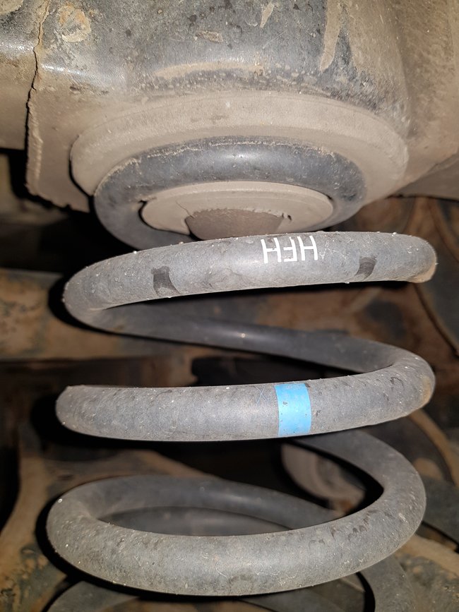

So I dont end up buy the wrong springs does anyone the OEM part number for these? Atached a photo of what is fitted if that helps at all Thanks Paul Oh and spring looks fine

Thanks that made laugh! Just going to fit two new ones doesnt seem to be a difficult job.
