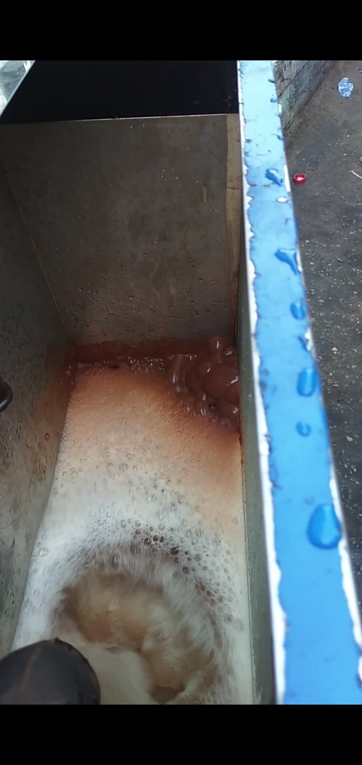

  4. First of all thank you Ricardo for your reply. The fan switch I'll get one that you recommended. I know you may get annoyed of telling us (Egyptians) to apply the thermostat ; but to find the thermostat you recommend is fantasy, if you find it, it will be used. Although I promise you I'll get one. The radiator is in a perfect condition. I flushed the cooling system throughly last week the photo attached will show you a disaster. The coolant is easy to apply. The last thing I want to tell you is that when the coolant between the min and max the thermoswitch doesn't work properly

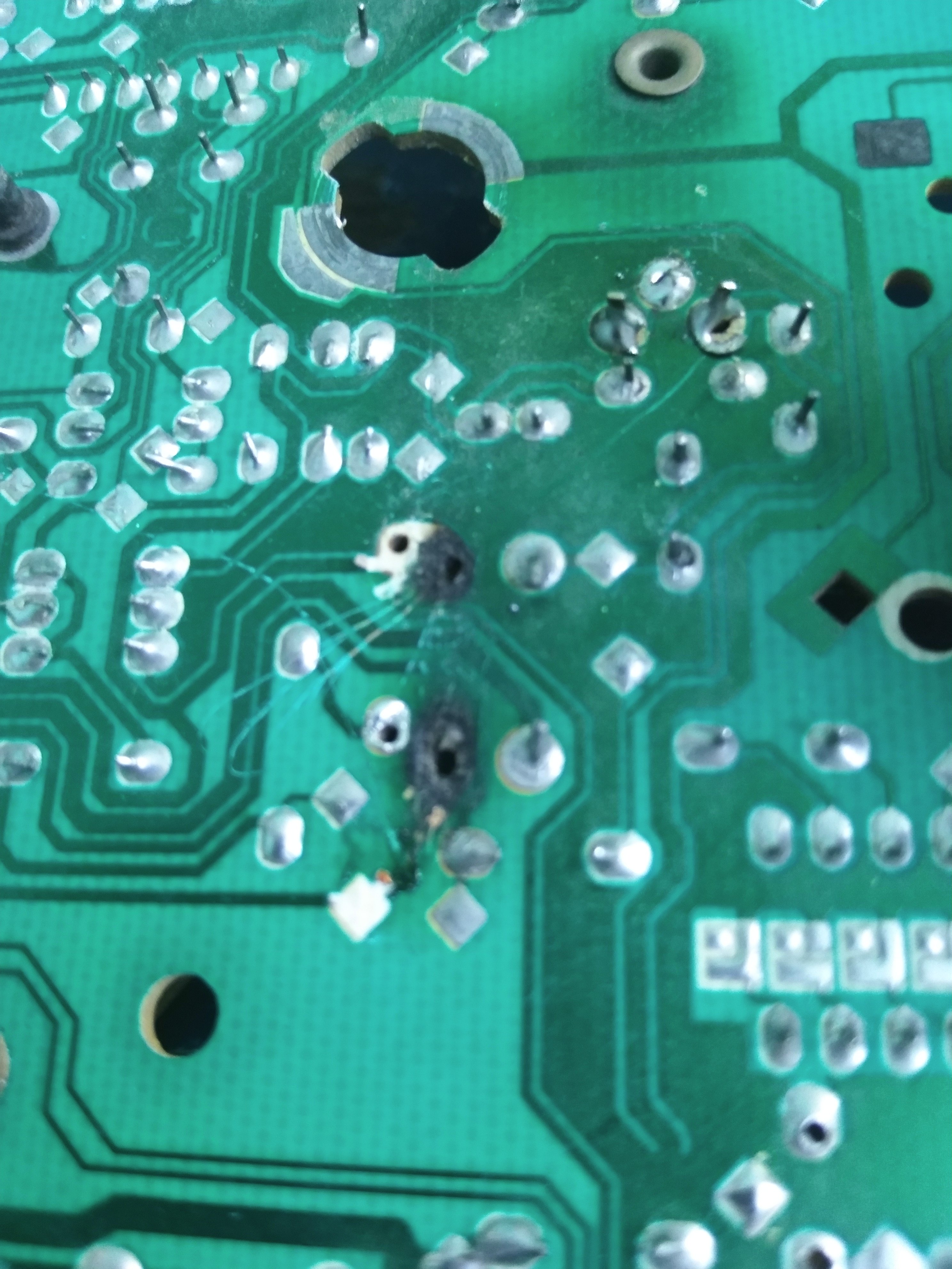

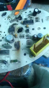

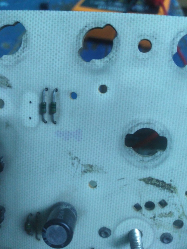

  11. Hi everyone, When I tried to replace the bad resistor with a new one I found it so difficult as there was no place to connect it with.
  12. Ricardo I'm so happy to know a person like you. You're so helpful. Many thanks from my heart ♥
  13. Dear Ricardo, Thank you for giving me some of your valuable time. I,m in a very bad need for the Values of the instrument panel and the correct copper traces. I also have an instrument panel with a tachometer I want to replace mine with it but it,s in a very bad case i'll show you its picture and if it isn't suitable tell me and help me with the old one which I showed in my first request for help in this page. I want to learn on the new panel Thanks so much.
