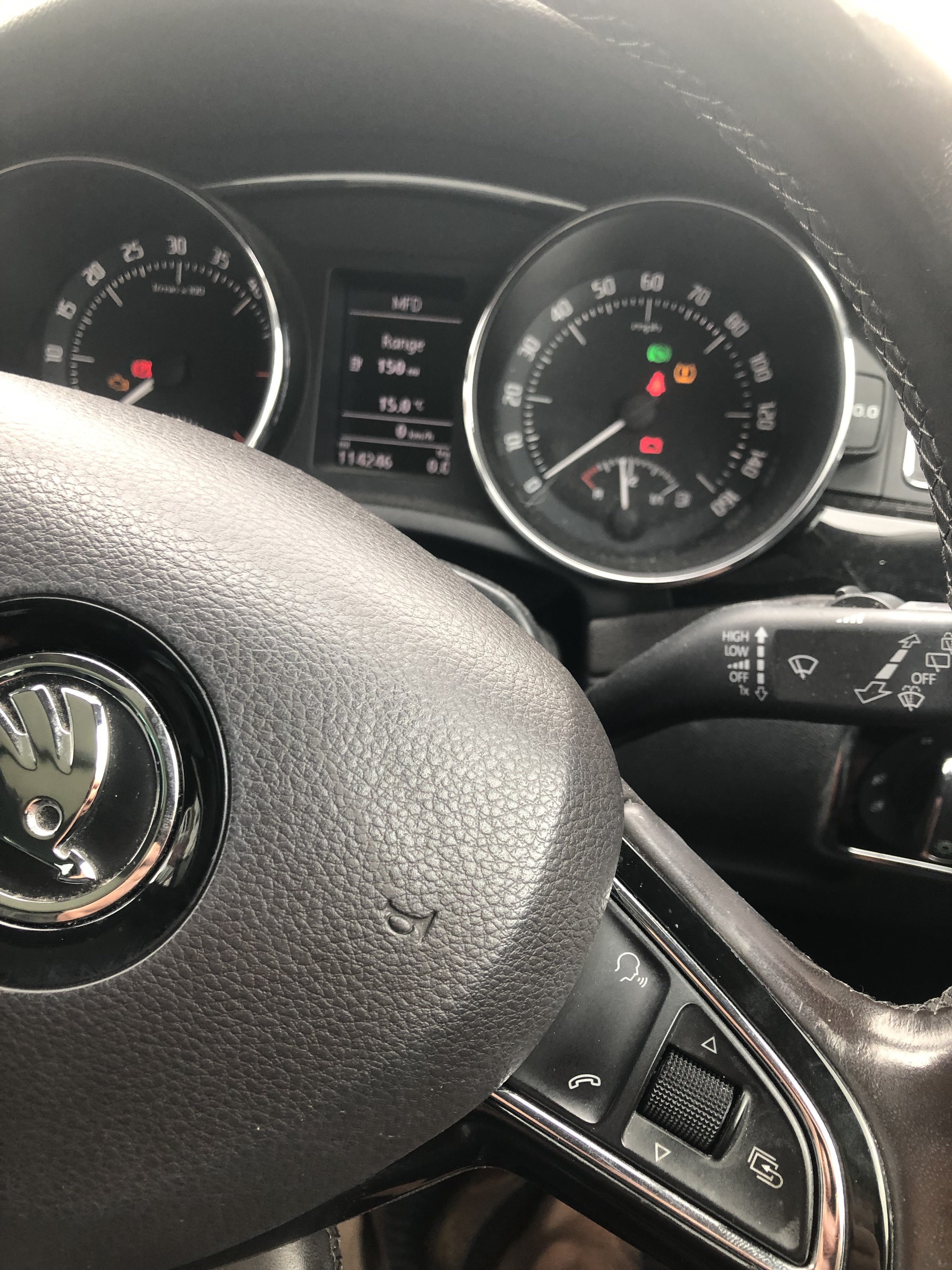

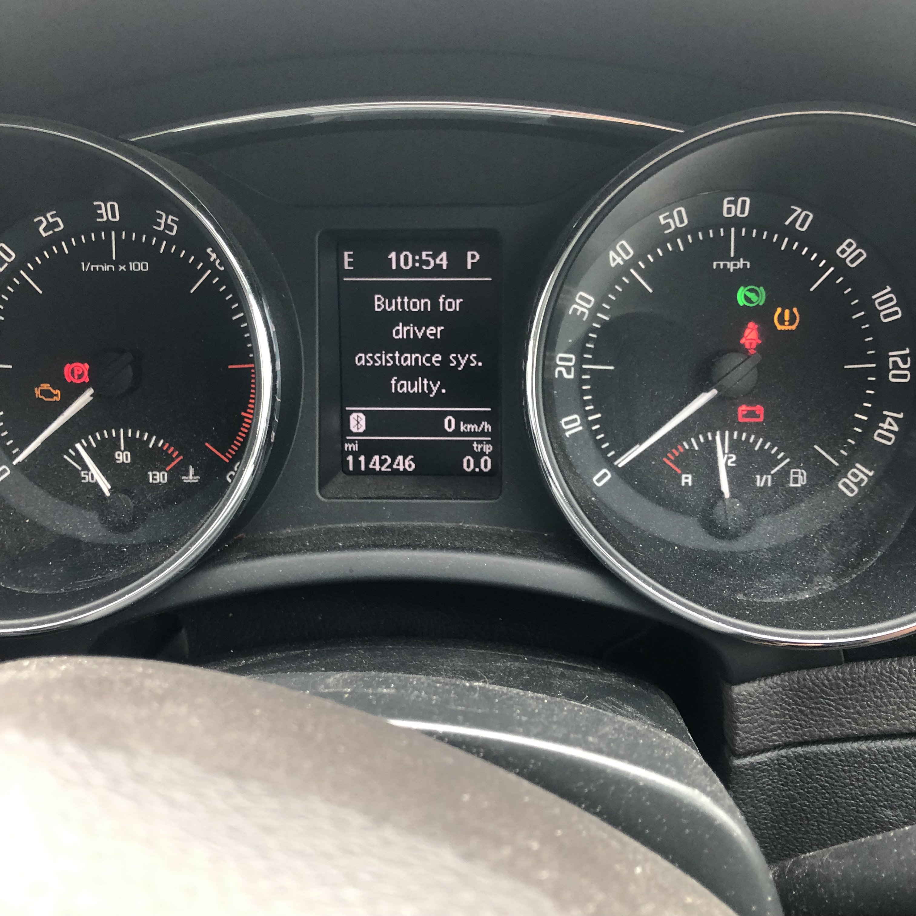

  3. Thanks Langers, you’re spot on, the garage have told me that the replacement clock spring came with a steering control module, but this wasn’t programmed. I’m now booked in with a agent they use for coding.

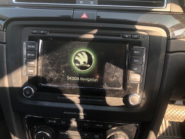

  4. Thanks, for the replies. It does make sense to have a tick box under the set-up menu, but my options there seem very limited, nothing for driving data unfortunately. I seem to remember having options under set-up to dim the footwell lights and automatically trigger the boot blind when the tailgate is opened, but just noticed that these are no longer present? I did reload the firmware on the Columbus head unit to address a different issue about a year ago, so perhaps this could have reduced some of the functionality?
