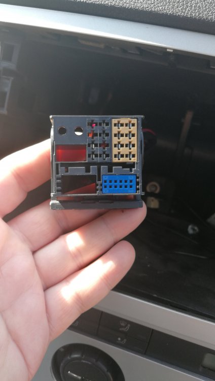

  3. Audio Tech Direct are going to speak to the factory. In the meantime I think I am going to get a harness and modify it so that when I turn the car off it powers off. There is supposed to be a setting somewhere for auto shut down after x minutes, but I haven't been able to locate that. If you manage to find your destructions then it would be most appreciated.

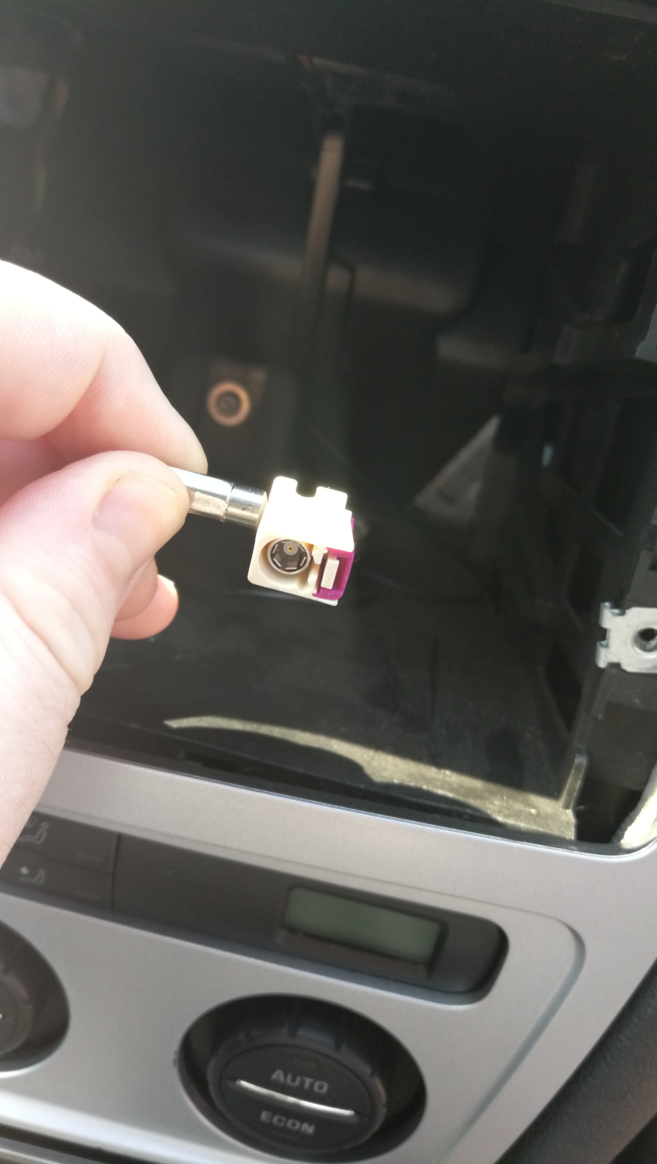

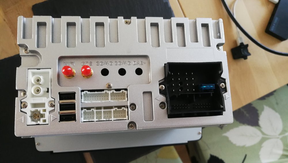

  4. Hi, yes it probably would help really!!! https://audiotechdirect.com/pba-sk8126s-android-10-0-after-market-radio-for-skoda-octavia/ is the one I have bought. The black quadlock being the main large multipin plug? If so then yes. Re the shutting down, yes that is correct, I don't think it is shutting down as it is literally on and working within a few seconds of turning on the ignition. No boot up logo etc. This is the connector for my aerial.
  5. Hi, I've recently bought a Mk2 2006 vRS TFSi and I have bought a new Android head unit for it. Little did I know that this wasn't a straight forward swap which would leave me pulling out what little hair I have left. The unit fits perfectly, but it doesn't seem to shut down when I take the key from the ignition. I cannot turn it on with the key removed, but when I switch the ignition on it appears to boot up very quickly, at the last place I left it. I've spent a while trying to work out what I can do, but truth me told most information that I can see on this seems to be vague. The unit that came with the car is a Stream unit. The unit I am replacing it with is an Android unit from Auto Tech Direct. This is the back of the Android head unit. Plug diagram: All I want is for the head unit to switch off when I turn the ignition off. Can anyone kindly offer any assistance please?
